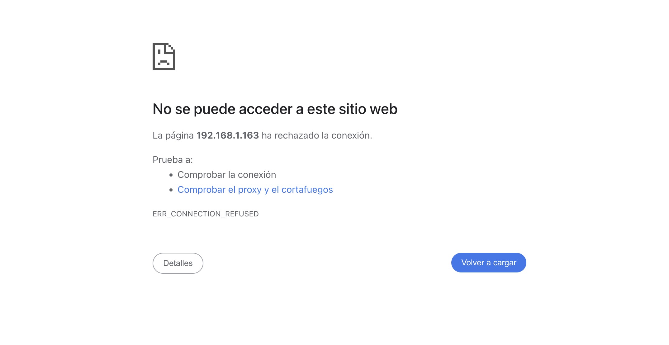

That works! Thank you @DanielPT If anybody over here knows why "Host" works and "Bridge" doesn't, please let us know, we're curious!
[Support] findthelorax - docker templates
Sorry about that. No, I didn't forget the port, and I've checked that it wasn't being used elsewhere.

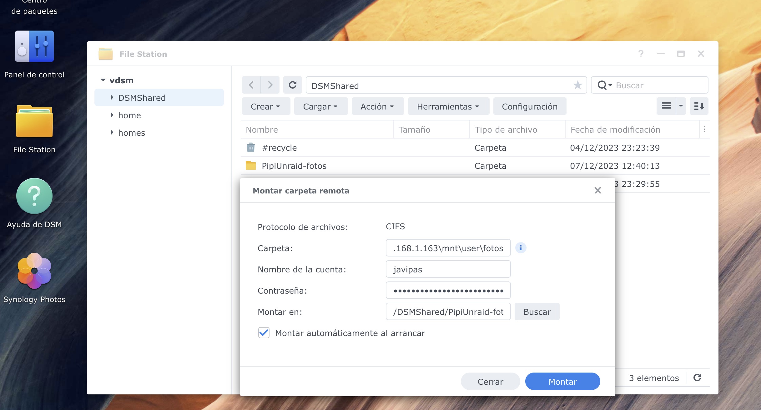

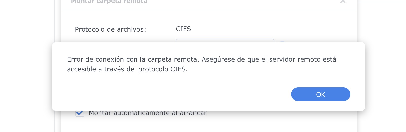

In my Unraid system I've got a folder called 'fotos' under /mnt/user/fotos/. I've got my photo library there. It's on 192.168.1.163. I've installed a Docker Cointainer with Virtual DSM to test Synology Photos from there. I had to use the 'custom br0' option to access it, and now it has autoassigned itself the IP 192.168.1.185:5000. Everything seems to work, but after installing Synology Photos on that container, I'd like to import the photos from my original photo library. When I try to mount a remote folder under the Synology explorer options, I use CIFS and try to setup the folder, but I get a message showing that there's a connection error with the remote folder. In fact, if I ssh my Virtual DSM container and I do a ping to 192.168.1.163, I get nothing. It's unreachable, and I don't understand how can this be possible. Shouldn't both machines see themselves and be able to connect?

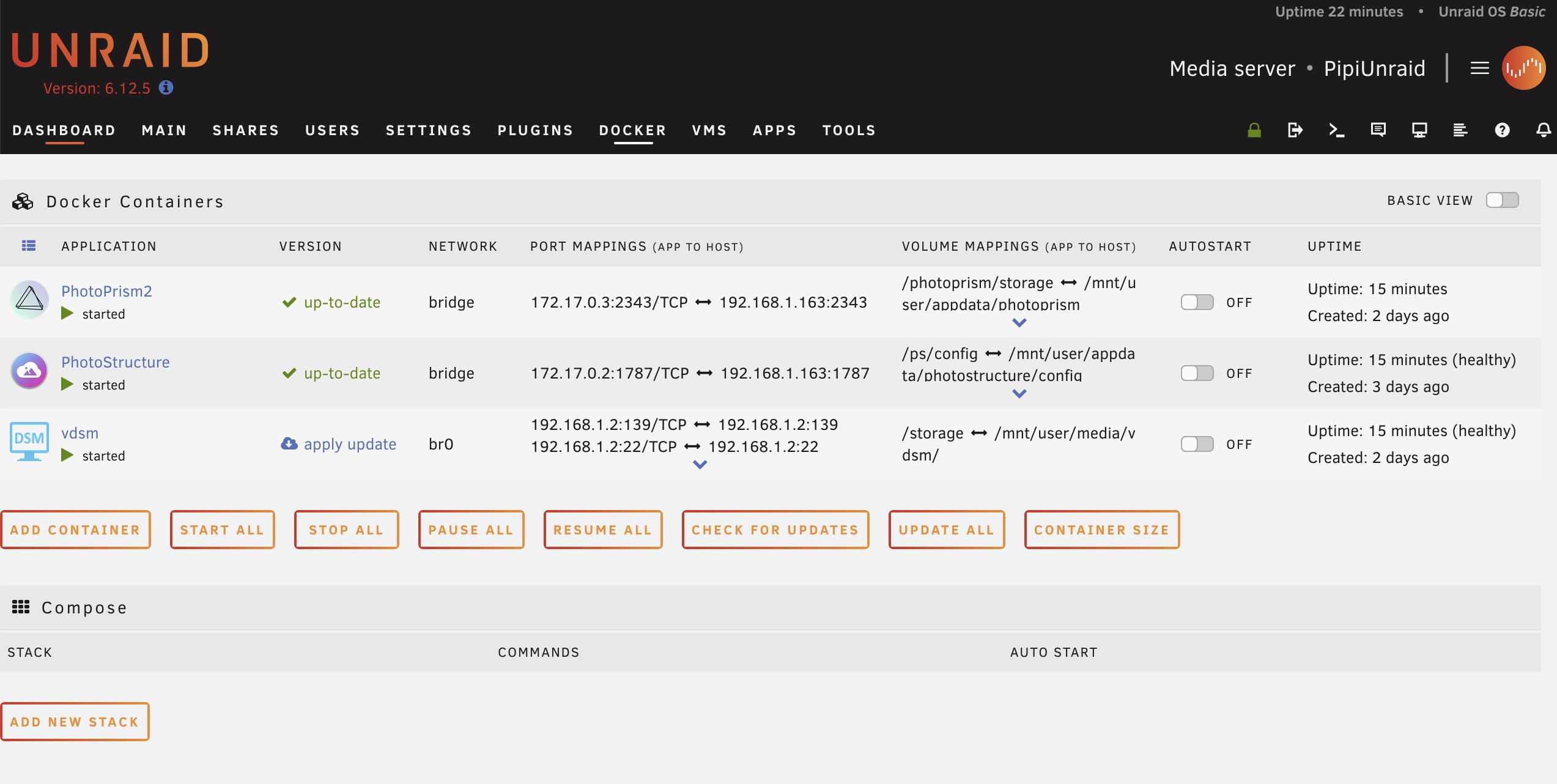

I've installed the PhotoPrism container and everything seemed fine, but when I try to access the WebUI I get the "Unable to connect" message in the browser (screenshot attached). I've got other containers running such as Photostructure, and that one lets me access it and works fine, so it seems there's no firewall issue here. I attach the log from Unraid, can someone tell me what's wrong? log-photoprism-unraid.txt
