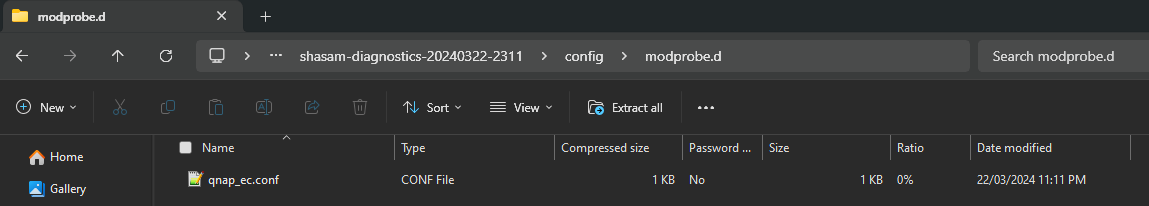

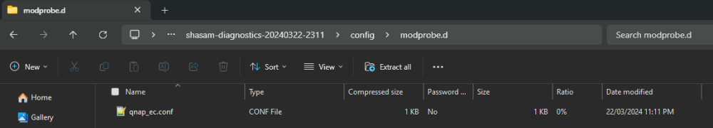

OK - after my changes above, the latest diagnostics I just dumped shows the file there now so hopefully this is resolved. Once I've finished my transfer of files I'll reboot and test again. Thanks. UPDATE: Thanks @ich777 all is working now.

I just checked and it was there? I've removed it an created it again. It has the top line of the file set to options qnap-ec check-for-chip=no root@shasam:~# sudo sh root@shasam:~# cd /boot/config/modprobe.d root@shasam:/boot/config/modprobe.d# ls qnap-ec.config root@shasam:/boot/config/modprobe.d# rm qnap-ec.config root@shasam:/boot/config/modprobe.d# ls root@shasam:/boot/config/modprobe.d# touch qnap_ec.conf root@shasam:/boot/config/modprobe.d# nano qnap_ec.conf root@shasam:/boot/config/modprobe.d# ls qnap_ec.conf

OK - looking at the boot process - right at the end it states: "modprobe: ERROR: could not insert 'qnap_ec' : No such device" Not sure what I've done wrong.
