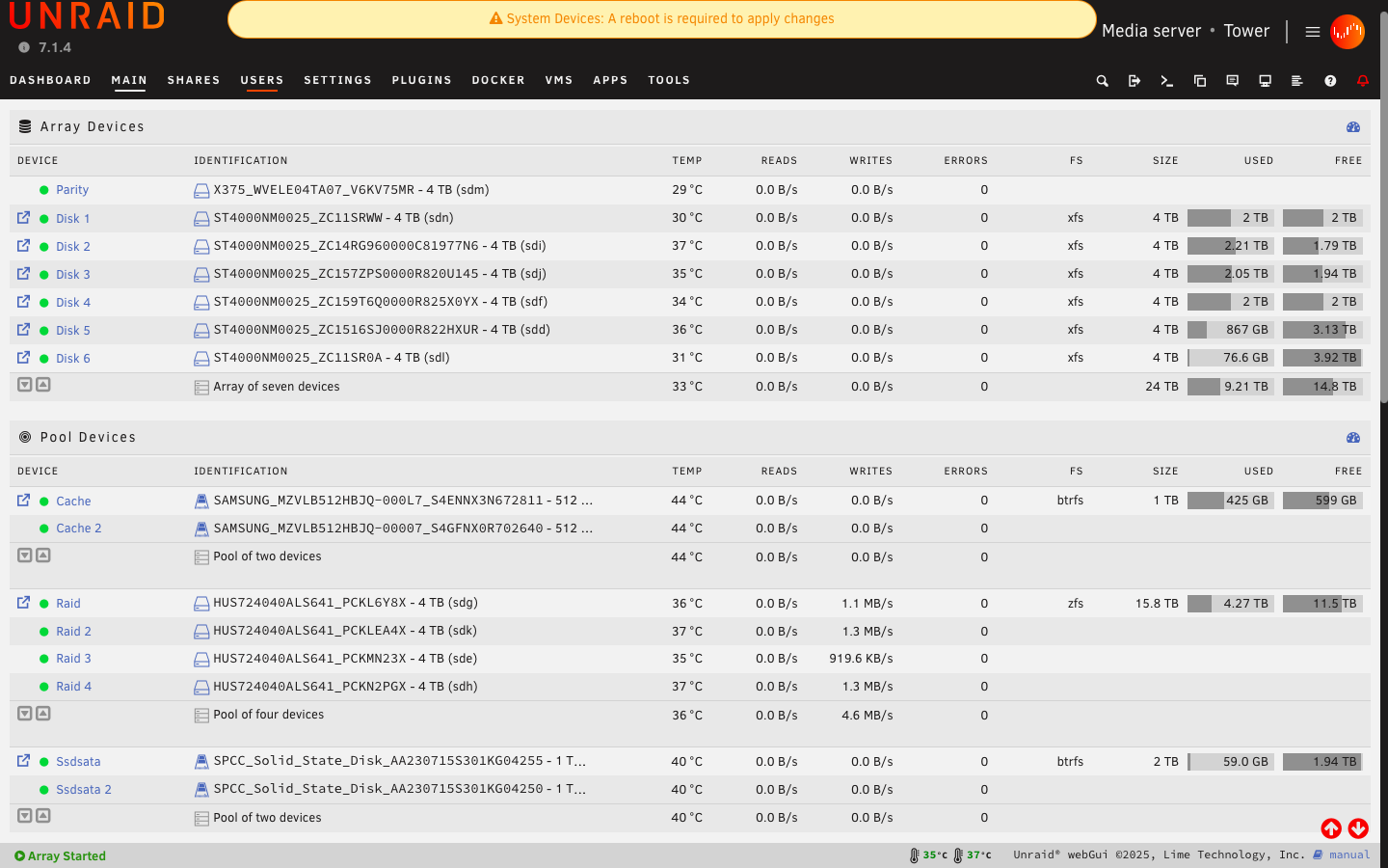

  7. OP: It has to be flashed to IT mode because it will be in JOBD mode and will cause issues here's the guide, a google search will help you. So its just a 9300-8i under the hood lsi 3008, if I come across one ill remember that lol. Even looks like a stock lsi 3008 dell really like make life hard for us HBA hunters, most cards I just grab the lsi firmware and flash over and away I go.

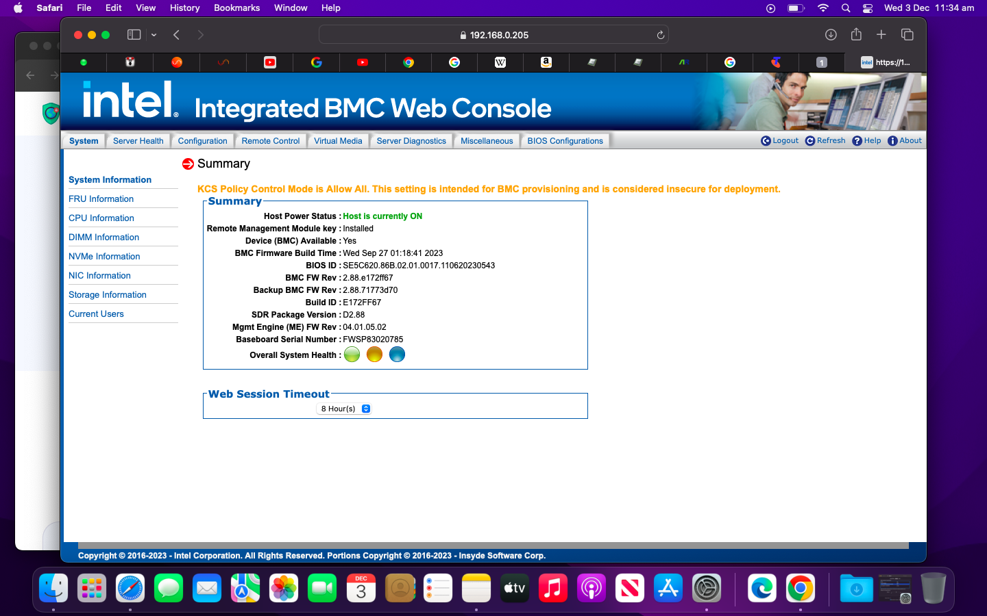

  10. I would be going AMD but each to there own. Get a used 9300/9400 hundred and save a tone, unless your planing to connect U.2 NVMe drives to your HBA which is going backwards when a $5 adaptor can do the job. What is your use case is what you should have said. If your using it for file server only then your wasting money, if its a ton of vms and docker containers then more cores. Have you thought about a used workstation dell 7920 ect. One thing people forget is that your using consumer gaming orientated hardware in a server case Sanrio. I have always used server workstation rigs for Unraid. First was a ML110 then a dell 5820 tons of pcie slots and lanes and now a s2600stb a real server board. All my rigs have had ecc reg ram and all xeon based which is made for the task. There's nothing wrong using a gaming rig for Unraid but you have to remember there not sold to run 24/7 deal with not having ecc ram, deal with not having rock solid stability, deal with not having pcie bifurcation, deal with limited pcie slots and lanes, no IPMI/BMC and have limited bios options to resolve things. I would look at Supermicro in your case and at least get a board that has some workstation/server functionality if buying new, like a X13SAE-F and getting some ecc non buffered ram to go with your lag 1700 cpu. Or go used and grab a ex server/workstation though there is one benefit of using a gaming rig is daul boot it for gaming :) My thoughts best of luck
  11. You have to connect to your bmc and remove them, connect to your bmc port to network, make sure you have login and pass for bmc set in bios then post IP of BCM port in browser address bar and connect. Unmount virtual media and done, here's mine from my s2600stb and note I connect to modem gateway to find broadcasted BMC port IP.

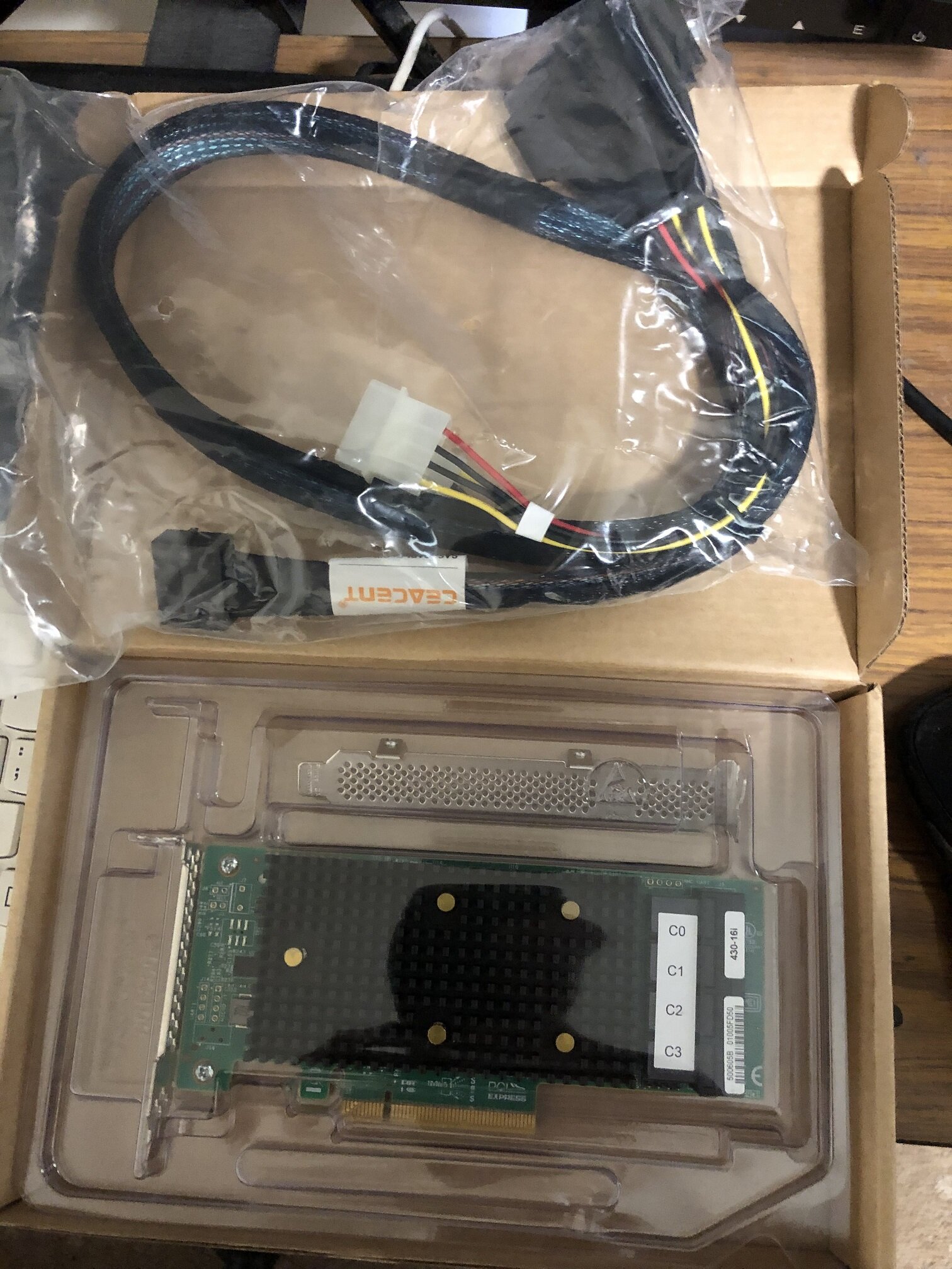

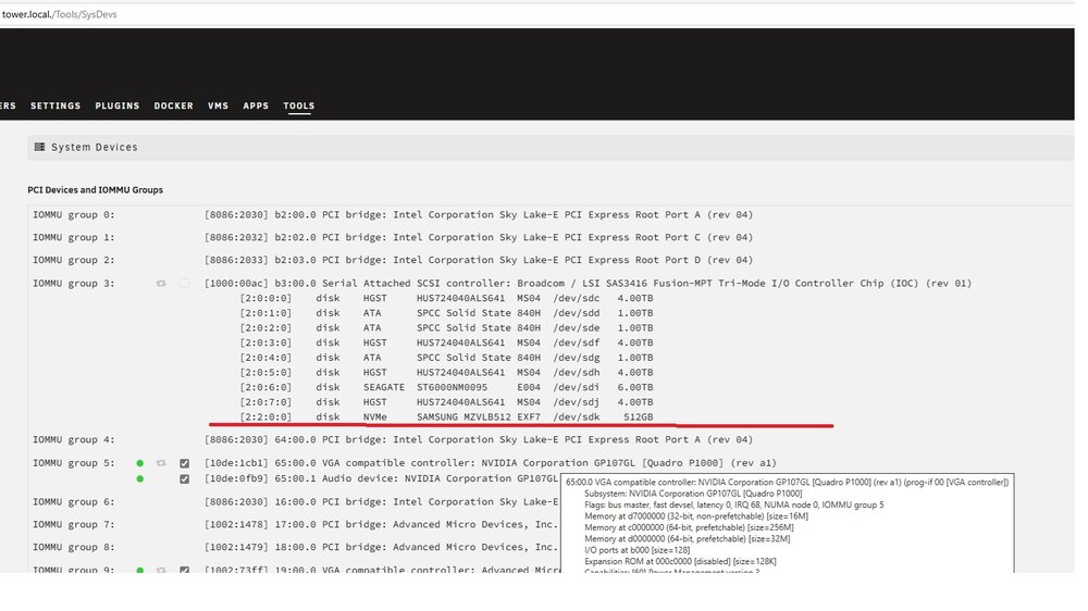

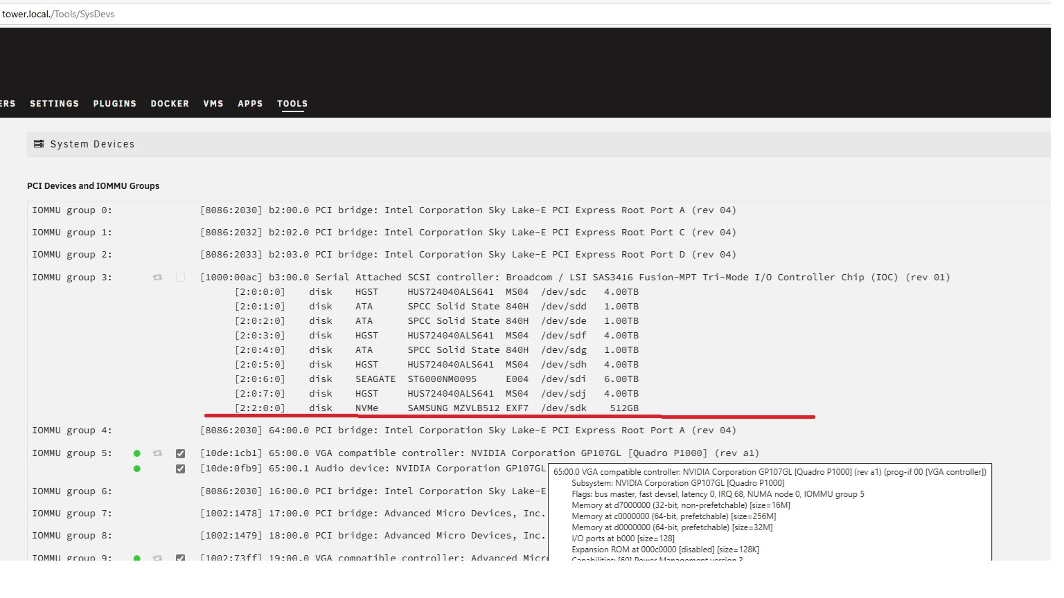

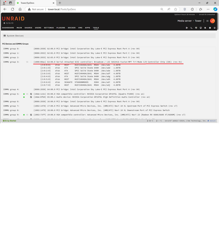

  13. No dramas ill link to a few guides when i get a chance, though theres enough pinned in this section to follow. It's been working great and i'am grabbing another U.2 to nvme caddy for a second nvme soon. The main reason i put this here as the lenovo 430-16i and 8i don't support tri-mode which takes the price down alot, though with a flash there full blown 9400's again
  14. Have you tried the navi/polaris vender reset plugin? Havent tried sleep as its only used for gaming and my mac vm's but havent had an issue since installing the plugin. I would go for a nvidia card that fits then like a rtx 3070 seems like your already awsered your own question if your looking at nvidia. As to amd cards its a roll of the dice weather they have the issues as i've herd its just luck of the silicon.
