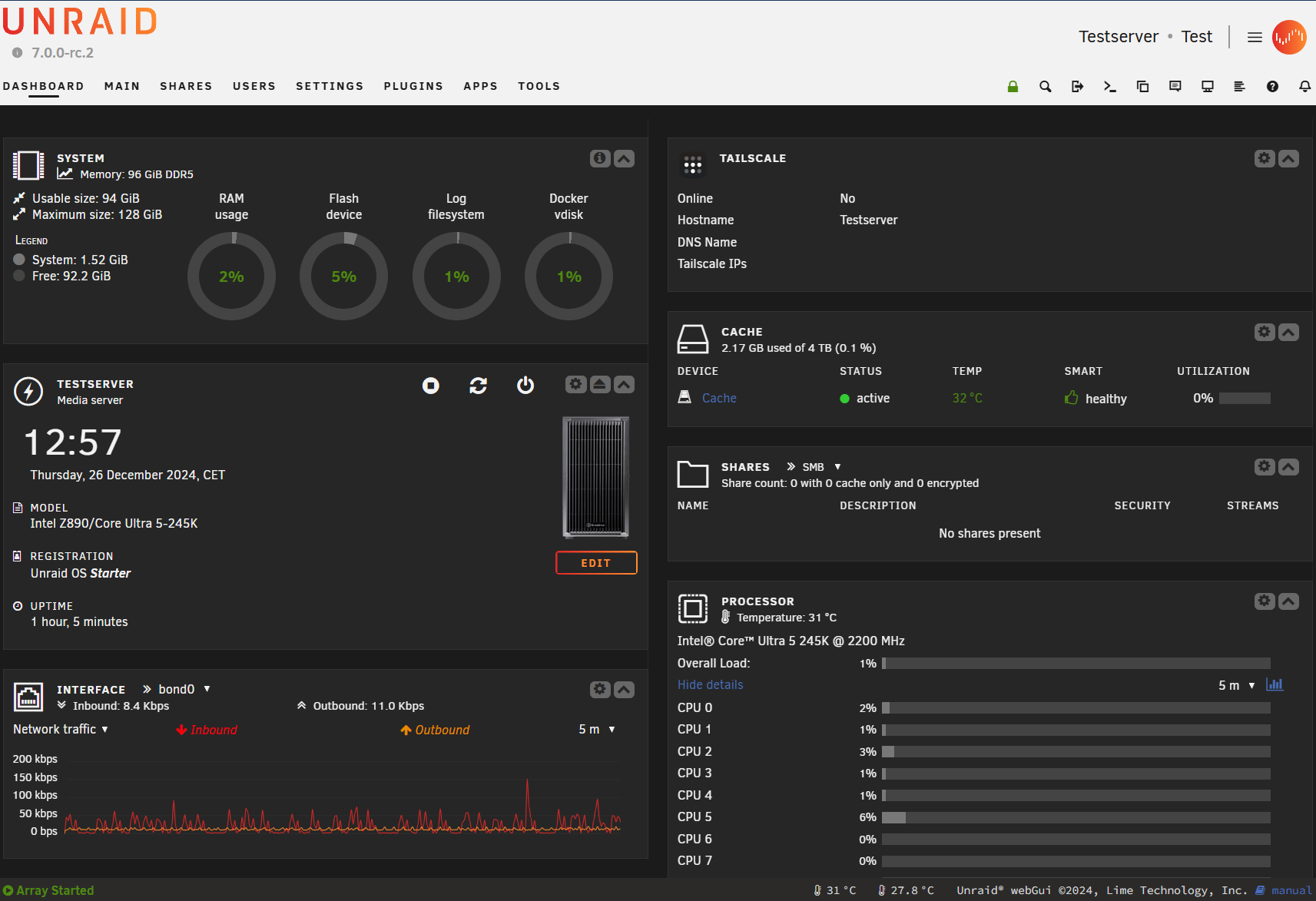

  16. Running 7.0.0-rc.2 now. Forgot to disable Fastboot in BIOS->Boot at first, so the darn thing wouldn't boot after the first reboot Just displayed a black screen and couldn't connect, sigh. Took some time figuring out why. Another issue was installing the RTL8125(B) PCI Drivers through the apps repository to get the NIC working (ASUS Z890M WiFi Plus). If you have no other NIC/ethernet adapter available, you can just download the PLG file and put it in the /configuration folder on the USB stick, should do the trick. And of course the GPU, as already reported, won't work until the kernel is updated. Can boot shell etc, but not show the GUI on host device. Also HW transcoding obviously won't work and nor will GPU stats display anything and so on. Otherwise, everything seems to be running well as far as I can tell (🤞). Running "sensors" after installing Dynamix gives this, so no problem reading temps:

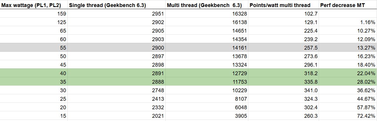

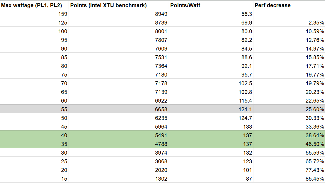

  17. Just received my Motherboard (ASUS Z890M Plus WiFi) and been doing some quick and dirty testing to gauge the best settings with regard to performance/watt for the Intel 245K. Based on the data below, I will set PL1/Pl2 to 55W. If you want to maximaze performance/watt as much as possible, the way to go is likely 40W-35W. Total power usage (ASUS Z890M Plus WIFi, Intel 245K, Cooler Master GX III 750W ATX 3.0, 990 Pro 4TB, 2x48GB Crucial 5600 1.1V, 2xNoctua 62mm, 2xNoctua 120mm) : Idle PL1/PL2 55W: ~45W Full load on all cores with 55W PL1/PL2: ~82W Full load on all cores with 159W PL1/PL2: ~160W Note that this is on Windows 11 with WiFi enabled and I've not changed any other settings other than PL1/PL2 in BIOS. I will try and lower idle usage by tinkering with more settings. Also, I'm yet to add any of my HDDs to the build. Geekbench 6.3 (best of 2 runs) Green=Maximum performance/watt Grey=A middle ground for more performance Note that single thread performance starts to suffer at 30W or below in GB6! Intel XTU Benchmark (best of 2 runs) Green=Maximum performance/watt Grey=A middle ground for more performance
