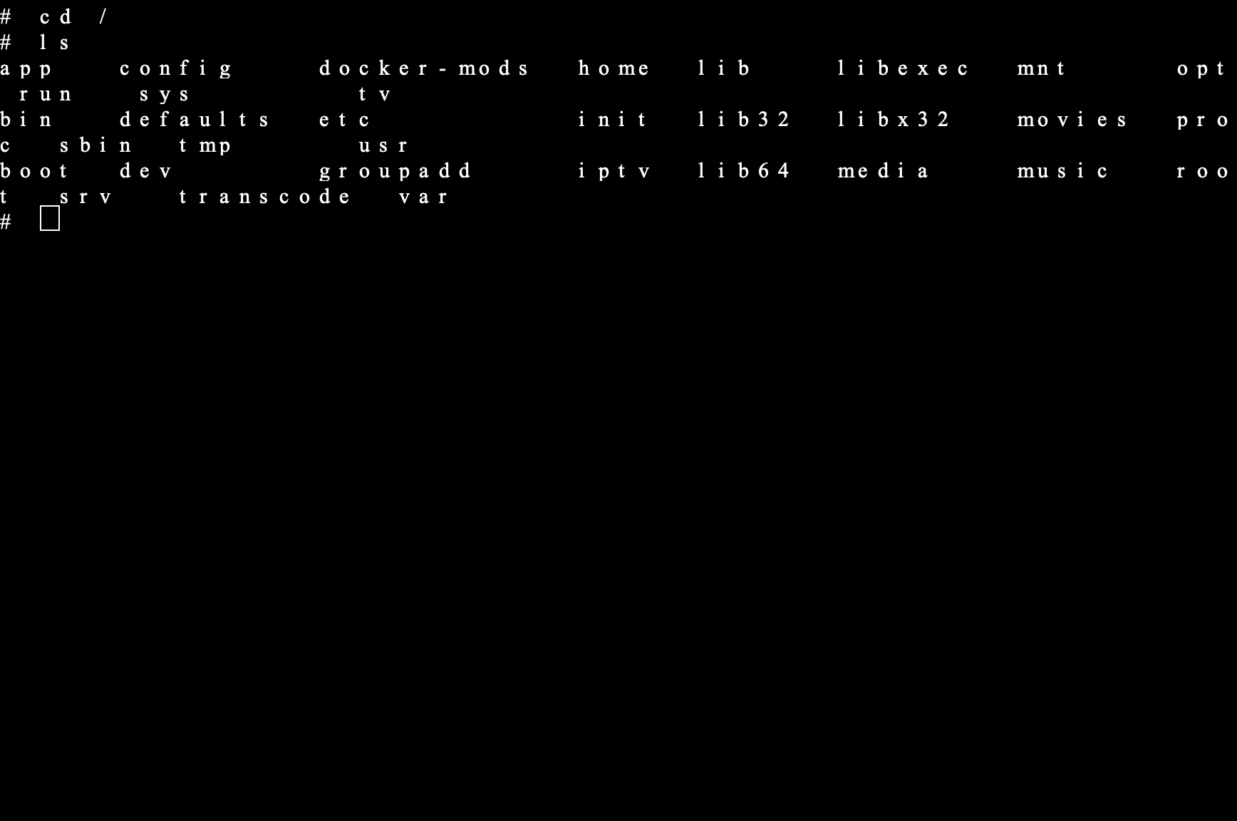

Weird font in docker console and unraid web terminal under Firefox (macos)
It's not the root folder of the server, but the console of a container. Truth be told I don't even use those mappings, so I need to remove them. I believe they're from the original config years ago for that particular container.
I took a break from Firefox for a bit but decided to come back this week. Recently (since rc2, perhaps? Or maybe since the most recent MacOS Firefox 95.x release) I have the strangest font in the web terminal and docker console. It only seems to be happening with Firefox on mac (fine in Windows Firefox; fine in Edge; Safari I can't test since console doesn't seem to work at all in that browser), hence why I am not posting in the pre-release subforum. I know this probably isn't an unraid issue, but maybe someone else has run into this? Thanks!
