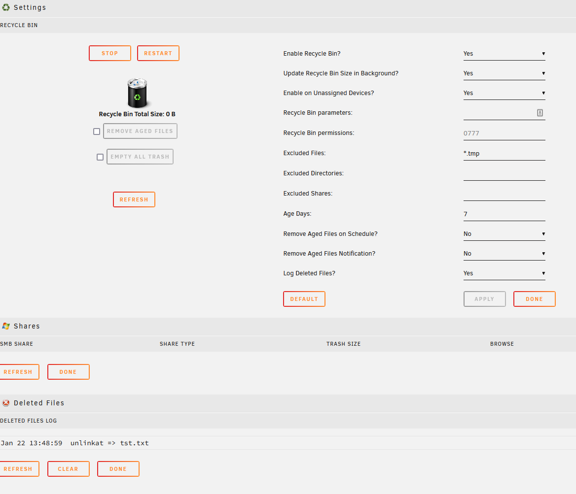

  1. Mine is not working and has been not working for a while. I just got some time and deleted the plug in and all recycle bins and reinstalled. It logs the file deleted as unlinked but no new .Recylebin folder is created.

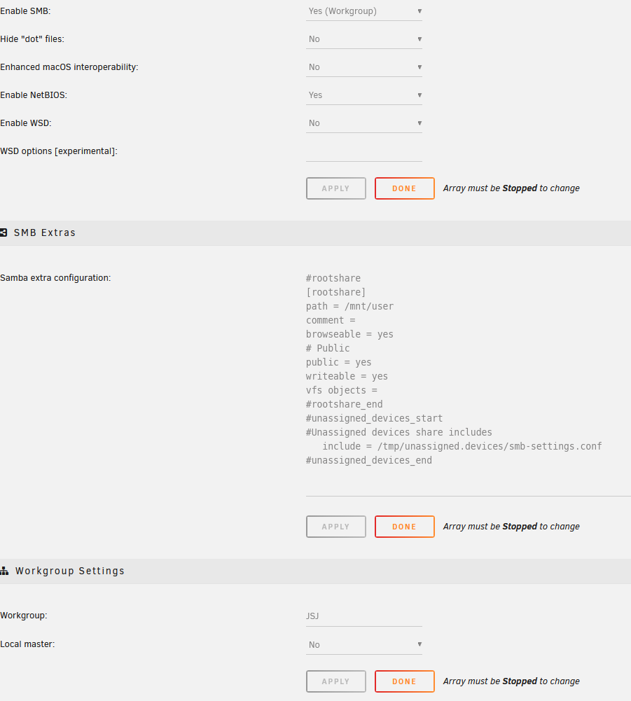

  13. Yes I was able to mount a share on my unRaid server to the Shield. These are my share settings.
  14. Thank you. That worked. I could have sworn that I checked that the directories were deleted after removing the plugin. I deleted them through terminal using MC and instead of /flash I found the files through /boot. I was wondering why in the Krusader docker I see a /flash and /boot but can not get into either, but using terminal and Midnight Comander to navigate, there is no /flash, only a /boot and I can see and delete the files.

  16. These are my settings. unRaid finds my shield when trying to map using the gui, I then fill in the ID and password, on the next screen when hitting the down arrow to find the shares it comes up empty. I try typing it in and it says mapped but I it will not mount.
  17. Thank you. I tried this by having Netbios as yes (This was set) and I turned WSD to off, it was on Select 'Yes' to enable WSD (WS-Discovery). The only reason to turn this off is when you are running an old LAN setup based on SMBv1. Still will not load the share. unRaid found the Shield, I typed my id and password. Then no shares showed up. I tried manually but it would not mount them.
  18. I am trying to mount a drive on my Nvidia Shield. I know that the problem is that the Shield only uses SMB1 and that unRaid now wants to use SMB2. I had the same problem on Windows 10 after an update and had to go to features and add SMB1 support back in. How do I do this on unRaid? thanks Joe May 22 23:59:27 Tower2 kernel: CIFS VFS: cifs_mount failed w/return code = -6 May 22 23:59:27 Tower2 unassigned.devices: SMB1 mount failed: Retrying with upper case share name mount error(6): No such device or address Refer to the mount.cifs(8) manual page (e.g. man mount.cifs) and kernel log messages (dmesg) . May 22 23:59:27 Tower2 unassigned.devices: Mount of '//SHIELD/shieldSamsung USB driveNVIDIA_SHIELD' failed. Error message: 'Retrying with upper case share name mount error(6): No such device or address Refer to the mount.cifs(8) manual page (e.g. man mount.cifs) and kernel log messages (dmesg) '.
