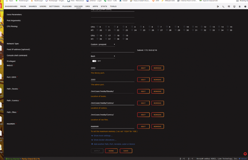

I just added port 2203 and now it works. By the looks of it you have to have two ports mapped 2202 and 2203.
I noticed this in the sys log also:
Fix Common Problems: Error: Docker Application ubooquity, Container Port 2203 not found or changed on installed application
https://hub.docker.com/r/linuxserver/ubooquity/ tells you:
-p 2202 - the library port
-p 2203 - the admin port

starting fresh, pointed to ebooks and comics folders but getting the following error and an orphaned docker.
I'm using Unraid 6.3.5
Warning: SimpleXMLElement::addChild(): unterminated entity reference EBooks/ in /usr/local/emhttp/plugins/dynamix.docker.manager/include/CreateDocker.php on line 211 Warning: SimpleXMLElement::addChild(): unterminated entity reference EBooks/comics/ in /usr/local/emhttp/plugins/dynamix.docker.manager/include/CreateDocker.php on line 211 Warning: SimpleXMLElement::addChild(): unterminated entity reference EBooks/ in /usr/local/emhttp/plugins/dynamix.docker.manager/include/CreateDocker.php on line 211 Warning: SimpleXMLElement::addChild(): unterminated entity reference EBooks/comics/ in /usr/local/emhttp/plugins/dynamix.docker.manager/include/CreateDocker.php on line 211
Docker output:
root@localhost:# /usr/local/emhttp/plugins/dynamix.docker.manager/scripts/docker run -d --name="ubooquity" --net="bridge" -e TZ="Europe/London" -e HOST_OS="unRAID" -e "MAXMEM"="512" -e "MAXMEM"="512" -e "PUID"="99" -e "PGID"="100" -e "PUID"="99" -e "PGID"="100" -p 2202:2202/tcp -p 2202:2202/tcp -p 2203:2203/tcp -v "":"/books":ro -v "":"/comics":ro -v "":"/books":ro -v "":"/comics":ro -v "/mnt/user/appdata/ubooquity":"/config":rw -v "/mnt/user/appdata/ubooquity":"/config":rw linuxserver/ubooquity
/usr/bin/docker: Error response from daemon: Invalid volume spec ":/books:ro": Invalid volume specification: ':/books:ro'.
Tried different folders, safe naming conventions, updating OS to 6.3.5 but no luck.
Had it working fine with old versions.
Any ideas guys?
Edited by hayleraid
added OS version
You haven't defined a folder that is mapped to /books.  There have been some changes to ubooquity so if I were you, I'd delete your existing template and reinstall from CA.
