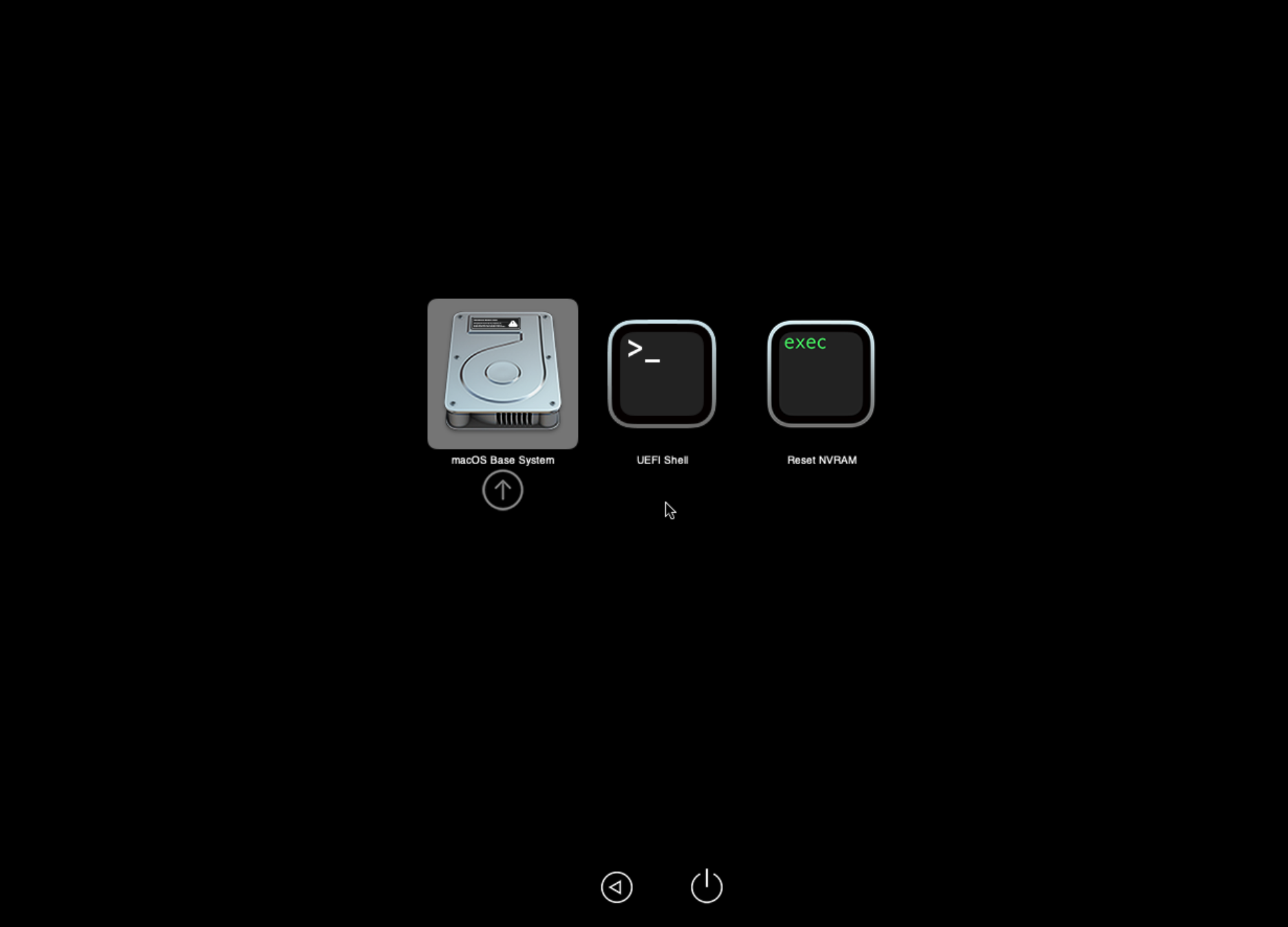

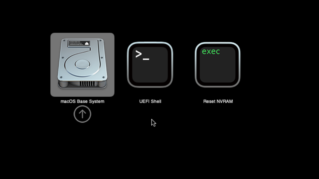

  13. It kept going into a boot loop when I selected the macOS Base System disk, so I ended up reinstalling my Unraid server from a backup. The installer was still missing, but the installation finally started when I chose the 'macOS Base System disk.' It was strange, but it worked! It's finally up and running! My solution was to reinstall Unraid and then simply ignore the missing 'MacOS Installer' icon by selecting the 'macOS Base System disk' for the OS installation. I’ve tested it on both Sonoma and Monterey through VNC, and everything works perfectly!
  14. same here, the new macinabox is broken. I tried resetting libvirt.img or custom_ovmf, reinstalling machinabox, downgrading opencore, none of these solve the problem. I am now stuck at this boot screen forever, I don't know what else I can do.
  15. nothing wrong with my internet. I can't start any kind of installation because the bootloader doesn't load/ see any ISO. as you see in the picture, there is no option to start any installation.
  16. Yes, the server has internet access, and the installers are downloaded & located in the default ISOS folder.
  17. I haven’t even started installing it yet; this is just the boot screen when the VM first starts. I’ve tried all versions of the VM, restarted the server, and even reinstalled Macinabox, but none of it helped.
  18. I successfully boot into bootloader, but installer disappears. how can I fix it, or is there a way to roll back to the old macinabox. Thanks! wing

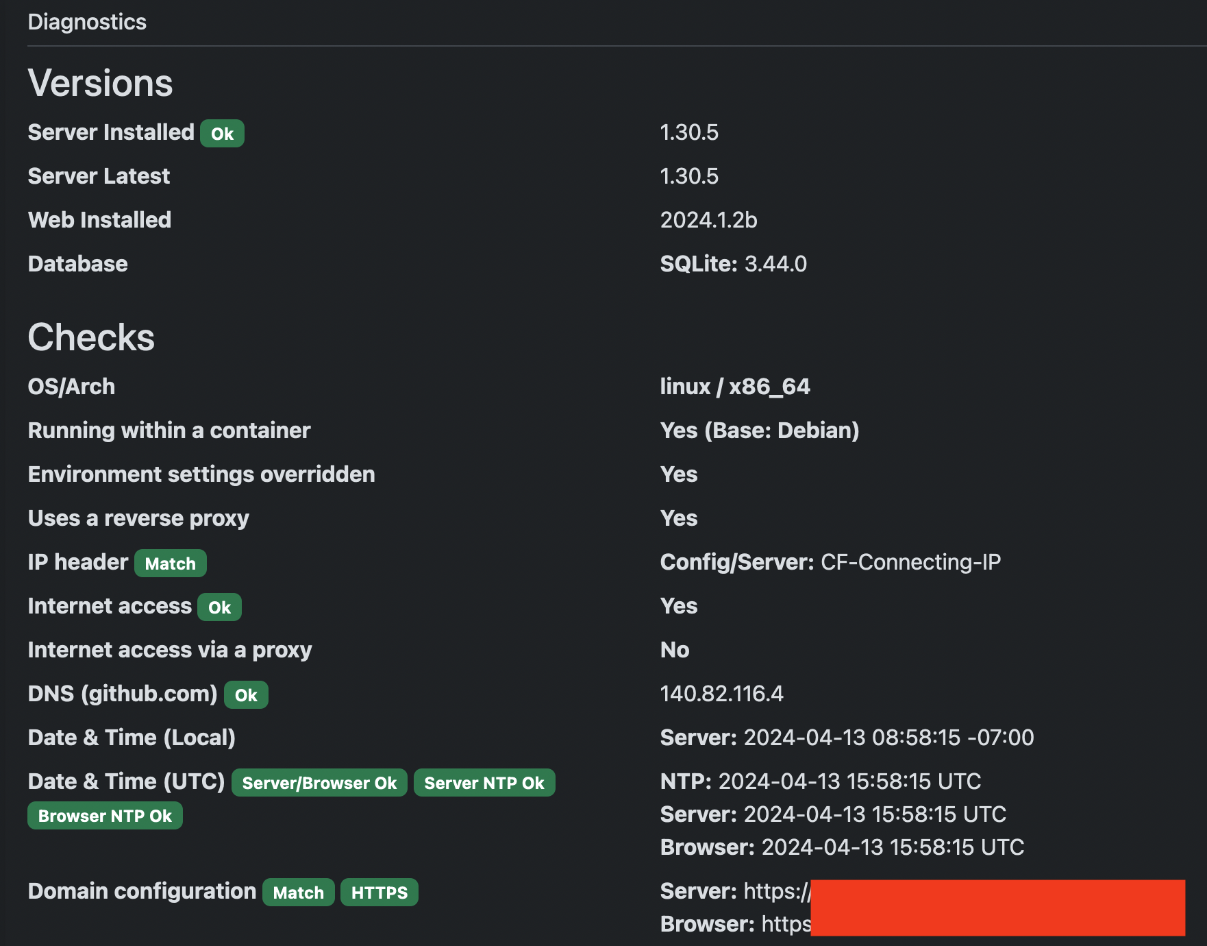

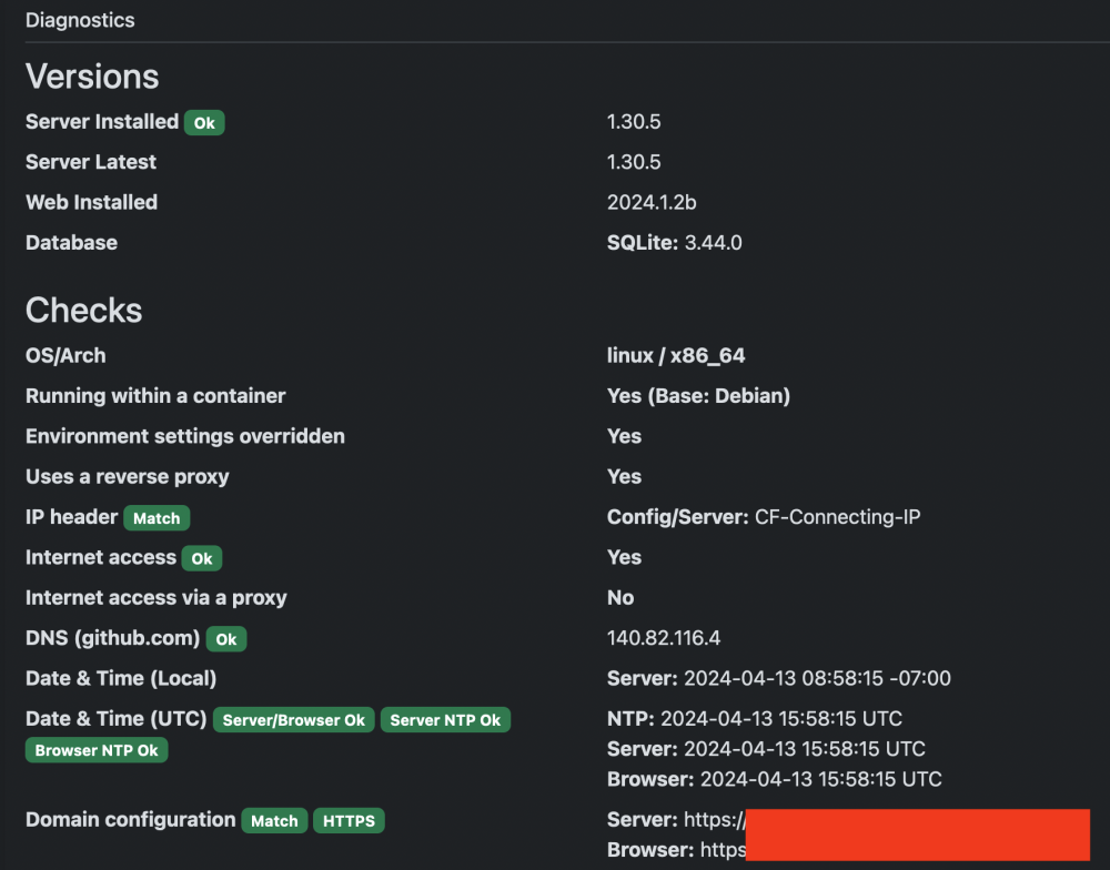

  20. Hi all, I encountered issue logging in any devices (Mac OS, Windows, IOS etc), but web login is fine. I don't see any error through vaultwaden log. I have tried removing the app & reinstall, creating a new account along with new email & password, log in & out (I won't be able login again once I log out). I have things backup, but the problem is that I won't be able to use any form of vaultwarden client; all clients don't talk to the vaultwarden app anymore (entering the password don't trigger the log at all). As far as I noticed the rsa_key.pem has been changed when I change the network type from a bridge to a custom network. I don't know if this is a cause of it. nothing wrong with the cloudflared tunnel & firewall. I use cloudflared tunnel, and I can log in anywhere through any browsers. also nothing wrong on the OS side, Installing vaultwarden on a fresh copy of OS doesn't solve the problem either.
