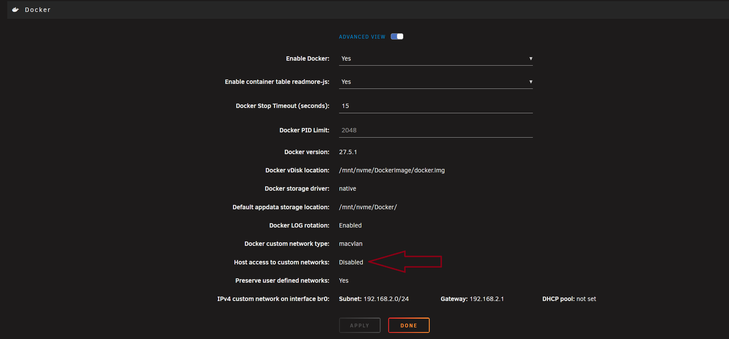

Signal Notification Agent
Now it installs and connects as long as the signal-cli container is in bridge mode. It will probably work with a custom network if I either enable host access to custom networks or just manually add a route myself. Testing that later, but now I'm gonna test that it works in bridge first. Thanks for the support so far. I'll be back if I see some more issues.

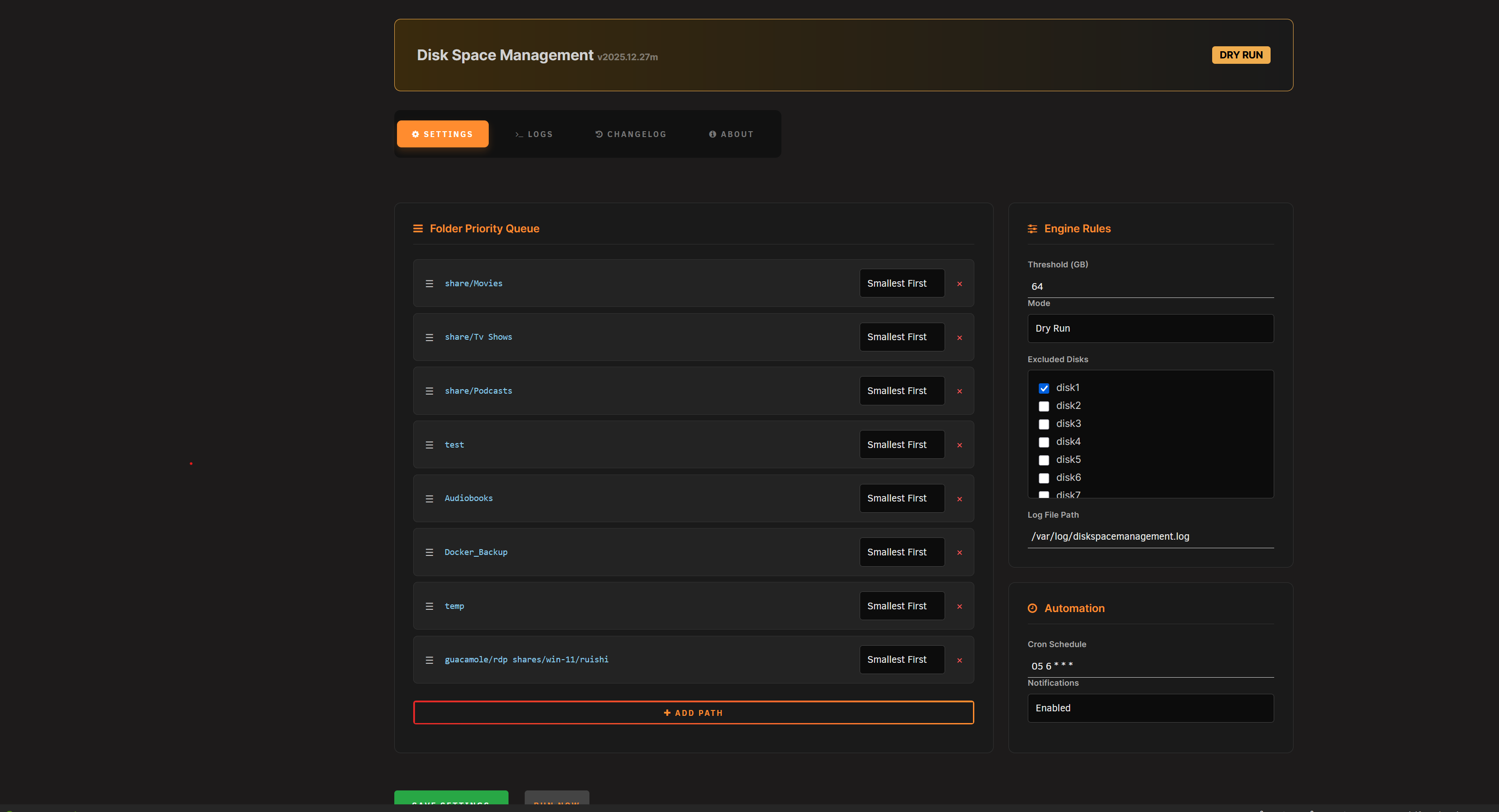

@rgreen83 I was able to reproduce the issue, and I've fixed it. And it was related to the empty folder issue. Whenever it encounters an empty folder, it skips it, but instead of moving on to the next item in that path, it skips to the next managed path, leaving the disk under the free space threshold. I'll push an update in the next few hours, including the fix and the largest first sorting option. I just have to test that there are no regressions first.
[Plugin] Disk space Management - Mainly for those who use the split-level feature in Unraid.
Yeah, I've been thinking of adding that for some time. Just haven't got around to it. Initially, this plugin was created to just keep drives from becoming full and keep it just above that line. The goal was never to move a large amount of data, but the plugin has later evolved, so it makes sense to add. While it was not designed for that purpose initially, it can be used to empty drives or rebalance the array and move the files to other drives. Always feel free to post feature requests or other ways the plugin can be improved on. It keeps me motivated to actually work on it. The reason why I haven't added it yet was that there was really no request for it, and there have been no more bug reports, so I've prioritized other things instead. But yeah, keep an eye out for the next update, and it will be added. :) That's interesting. I haven't really tested it on moving large amount of data, as I mentioned it was not initially designed for that. But are you sure that the folders that are skipped actually have files in them? A side effect of using the remove source files command the script uses is that it sometimes leaves empty folders behind. And in earlier versions, there was no cleanup done to mitigate that. So you might have folders that are already moved, but have empty folders in the source disk. If the script is unable to determine the size of the folder/files (like when it's empty) it assumes it's either locked/in use or empty and will skip it. I'll take a look at it, but please check the folders that are skipped if they actually have files in them. If not, delete them manually, and they will stop appearing in the log. I've seen the issue myself a few times, but it has always been empty folders left behind from earlier moves. But it also sounds like it could be a bug if you have confirmed that it leaves the disk under the free space threshold. Sounds like it's maybe related to the empty folder issue somehow, and it messes up the calculations. IIRC I think I saw the same thing the few times this has happened in my runs, but I use it on a threshold of 60 GB and only move the smallest folders first, so I didn't think much about it when it was a few GB off. On big moves, this will of course add up. But for now, until it's fixed, I think the workaround is to make sure to delete empty folders if they appear in the log, as this is probably the cause of the wrong calculations, somehow. I'm really happy you like it. This is the right place to ask for support. Or did you mean like a "buy me a beer" link? I'll think about it :)
Thanks for this, but I get a 404. I'm running the API on a custom br0 network, but I've tried running it on the normal bridge as well with the same result.
Good catch. I'll change that in the next update. Maybe a drop down to enable yes/no and if yes the text field appears, and don't delete it if set to no again. I'm glad you find it useful. I have 17 almost full drives myself, so it makes it much easier for me to manage as well. I was getting pretty fed up with moving things manually every day. I could of course make unraid split everything as needed, but I don't want that as I have to satisfy my (mild) OCD. Haha.. BTW if you're still on the dev version you can uninstall that and install from CA again, otherwise you won't see the update when it's ready.
Thanks for the feedback. You can enter "disabled" without quotes in the cron schedule, and it's already a note about it in the help & info section :)
New dev version, which I hope will solve the remaining bugs: https://raw.githubusercontent.com/strike84/unraid-disk.space.management/refs/heads/main/DiskSpaceManagement-dev.plg Please give it a try :) @Crimzon I was unable to reproduce the issue on my laptop as well, but I believe it's because I'm on Unraid version 7.2.3 and you're on 7.1.4. And my plugins UI is designed for 7.2+ But I made some adjustments in the latest dev version that I hope will solve the issue. If not, it may be worth upgrading to the latest stable Unraid release. It's pretty stable now, so I would consider upgrading anyway. @unabletoconnect I also added a "fix" for the infinite loop; it now skips this folder and logs it. If you're seeing the same folder skipped in the logs, run after run, it may be because sometimes rsync leaves behind empty folders on the source disk after the move is done. I've added a fix for this as well, so it cleans up the folders if left behind. But you need to delete these folders yourself if it's already happened to you in an earlier run. After that is done, the folder will not show up in the logs anymore. Edit: I also pushed the update to the main version so that you can update the normal way.
