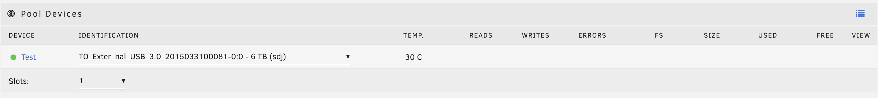

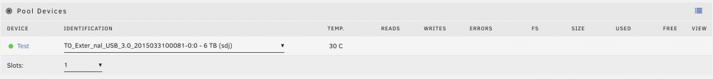

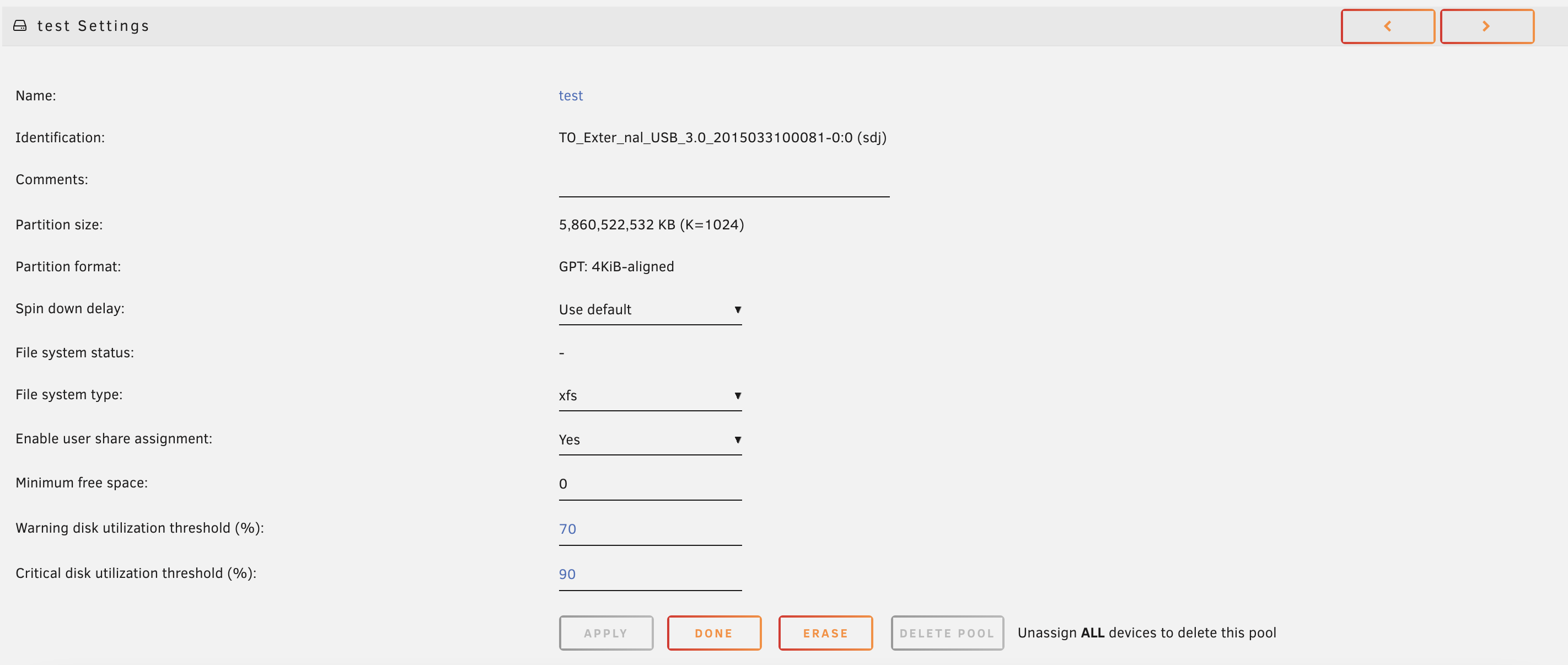

  1. Thanks. You are describing exactly what is not happening in my case. If I add a top-level folder (e.g., MOVIES), it automactically becomes a user share. This works flawless for all top-level folders on my array. However, this does not work for my pool device (device name: Test). This device has a top-level folder named "Test". However, this top-level folder is not added as user share automatically. I have sent my diagnostic log above and can also add more screenshots if helpful? If I read @itimpicorrectly, I may need to manually add it?

  7. My issue is still unsolved. No idea what I am doing wrong here (if it is my mistake rather than a bug). I add a pool device. I create a folder on the pool device (e.g., appdata, test, frank). This folder on the pool device does not show up under user shares. No matter what I do, it just does not show up under user shares in Unraid,. If I create a folder on an array disk, it always shows up.

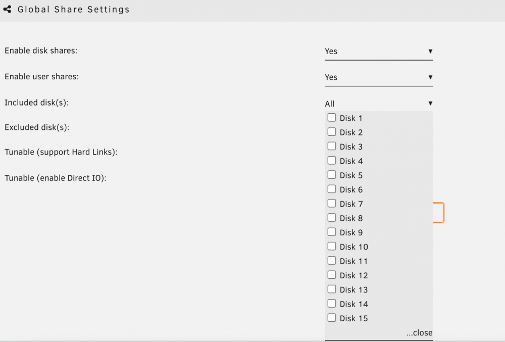

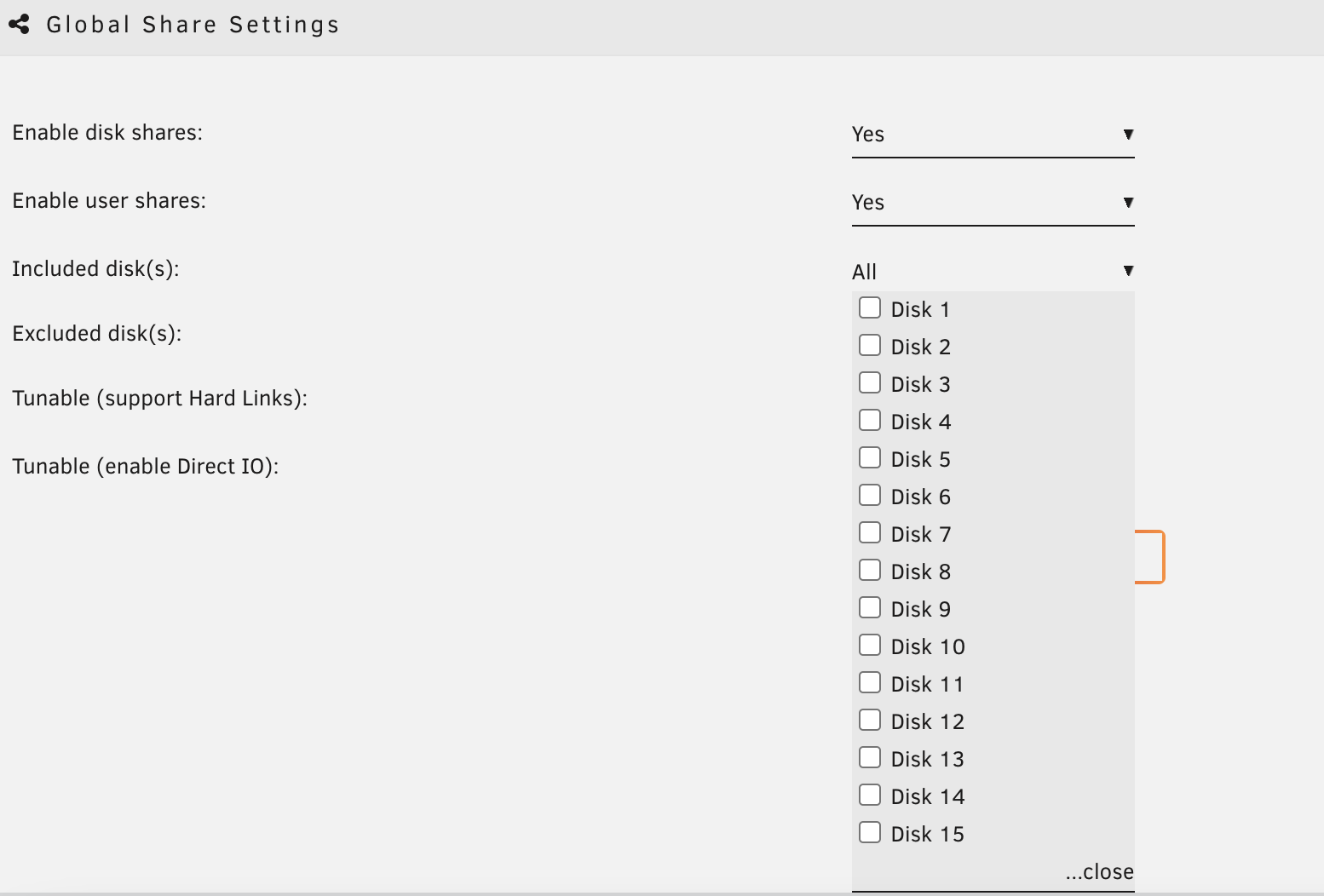

  20. See below from global sharing setting. Cache / pool disk doesn't show up in the list. Are you sure that cache/pool disks can be part of user shares?
  21. Maybe one interesting observation that can help point to the issue. When I select a usershare (e.g., Movies) and go to the settings. I can select a drop-down menu called "included disks". This allows me to select/unselect all disks that are part of the array. It does not allow me to select the cache disk. Are you sure that folders on the cache disk can be included in a user share?

  23. I jo longer have pool, but the disk is allocated to cache. Still same issue (screenshot above). Any idea of a “fix” that i can get my docker back. Unraid is broken for me now
  24. Yes, it points to cache, but shows pool in the overview. If you check one of my earlier posts with screenshots, there was the same inconsistency. Setting is XXX, but overview says YYY. Maybe a bug?
