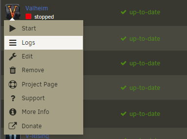

It must be because of Valheim Plus as it is still doing after deleting all files in /worlds_local
Go to the Docker tab, click on Valheim and choose LOGS. I am running mine with Vplus, no BepinEX and as a public server, password protected. I am running several other servers on this machine and a second Unraid with no issues.
Valheim server in reboot loop. Dropping this error: /opt/scripts/start-server.sh: line 272: 88 Segmentation fault ${SERVER_DIR}/valheim_server.x86_64 -name "${SRV_NAME}" -port ${GAME_PORT} -world "${WORLD_NAME}" -password "${SRV_PWD}" -public ${PUBLIC} ${GAME_PARAMS} > /dev/null /opt/scripts/start-server.sh: line 272: 77 Segmentation fault ${SERVER_DIR}/valheim_server.x86_64 -name "${SRV_NAME}" -port ${GAME_PORT} -world "${WORLD_NAME}" -password "${SRV_PWD}" -public ${PUBLIC} ${GAME_PARAMS} > /dev/null Session terminated, killing shell...kill: usage: kill [-s sigspec | -n signum | -sigspec] pid | jobspec ... or kill -l [sigspec] Update state (0x5) verifying install, progress: 0.18 (4194304 / 2346408748) Update state (0x5) verifying install, progress: 32.69 (767146885 / 2346408748) Update state (0x5) verifying install, progress: 73.38 (1721706037 / 2346408748) Is this due to the Mistlands update that dropped today?
