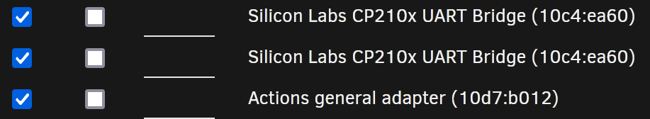

Can't use these USB device because they are "the same" (but they're actually not)
I say it's very likely, but then USBM would be (or should be) added to the core. Why not? In light of making Unraid more user friendly, a more full featured USB config like USBM is needed in the core, as opposed to a couple of checkboxes that are probably a 1-to-1 translation of the QEMU config, but are ultimately just confusing to have as a GUI. Assumptions of course. I just want Unraid to become better.
That does indeed work quite a lot better! Also provides more fine grained control over how exactly a USB device gets connected, and when. Of course, this undermines the fact that this problem should probably still be solved in the core VM manager - two devices with the same manufacturer and product ID should not be considered to be one and the same device, or even two identical devices.
Why can I not use all three devices? They have different serial numbers. One a is SkyConnect stick, the other is a Z-Wave sticker, and the third one is a BT stick. I need all three of them to connect to my Home Assistant VM. I can't help that they are internally the same device. What is the solution please? Upon updating it says "XML Error:HostDev already exist in the domain configuration".
