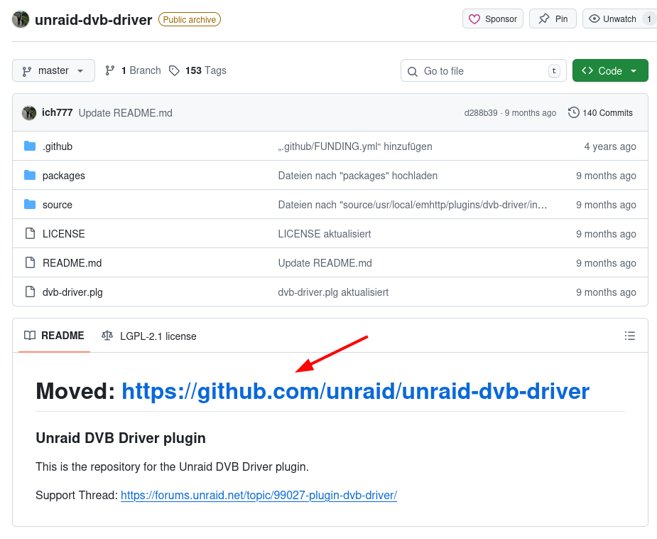

[Plugin] DVB-Driver
Yes, if it wouldn't be you would get a notification when upgrading to that version. Thanks for the heads up, I've now changed the link in post two, however if you look at the repository: The plugin was simply moved to the Unraid repository and you don't have to do anything on your side, the new repository was already pushed to the users on the last plugin update. By reading the release notes which are presented when you upgrade: https://docs.unraid.net/de/unraid-os/release-notes/7.2.2/#linux-kernel However you also get a notification when upgrading if the driver was properly downloaded or not: https://github.com/ich777/unraid-plugin_update_helper?tab=readme-ov-file#update-notifications
