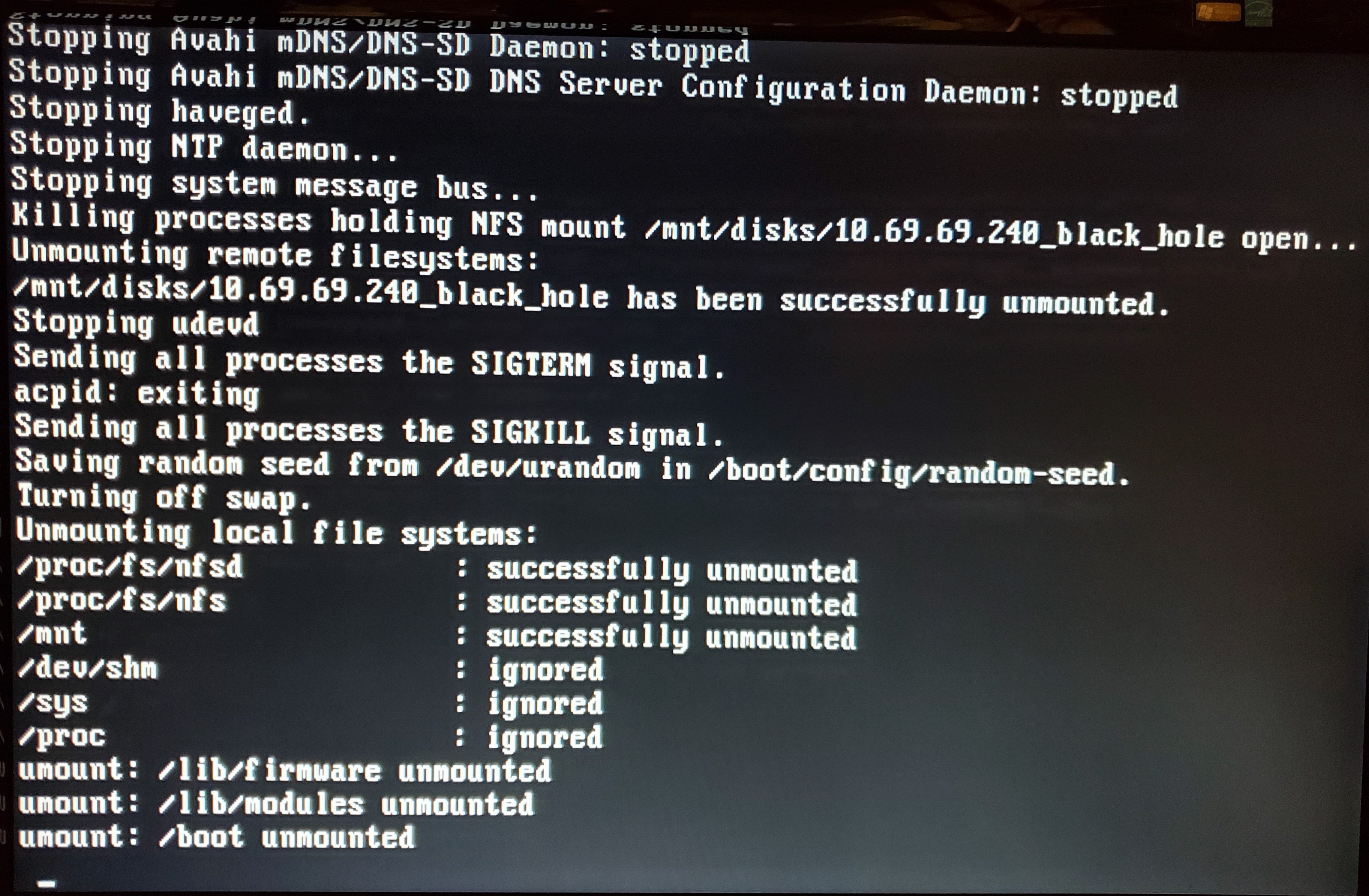

  14. Hi @dlandon, I hope your holiday season is going enjoyably! Apologies for the tag, but we went down this road once before and got it fixed, so... Also, I am on 6.8 stable, I do daily plug-in and docker updates, so all are also the latest. I read up to here from our last posts and geez, looks like all the new bits and pieces that have gone into the 6.8 release are keeping you crazy busy; sorry to pile on ☹ I’m having a situation again where the power went out and the primary server did not shut down again until I restarted the ancillary servers; all the details are the same as this previous link we worked. I have attached the logs for you to review at your convenience. Given the increased frequency of our power issues I do want to get this figured out, but no major rush. I truly appreciate all of your hard work; some of the minutia discussed here shows a high understanding on your part. Well done! Thanks! COMPLETE_tower01-diagnostics-20191227-1640.zip tower01-diagnostics-20191227-0533.zip

  23. Hello @dlandon, Yes and no. 'No' in so much as when I restarted I did not have to do a parity check 👏. 'Yes' in that the server did not actually shutdown, I had press the power button; this has never happened before. The only reason this incomplete shutdown could be an issue is if I had a power outage, which is how this whole sub-thread got started. Thoughts? (Great job though! Thanks for the fixes!)
  24. Hi @dlandon, Definitely a step closer. Got past the previous stop point, but now stops at: As requested I have attached Diags. Thanks! tower01-diagnostics-20191201-0232.zip
