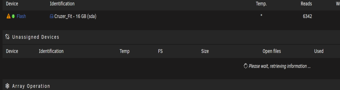

Hello @dlandon, Happy Holidays one and all! So, I just had a power outage and the UPS shutdown executed as expected. However, (and I neglected to address this way back when I discovered it, ugh) my Unassigned Devices (UD) do not disconnect during shutdown, if those devices are already off (power outage or not), and the primary halts shutting down. I was able to complete the shutdown and reboot after restarting the other servers UD was connected to prior to power outage. My question is, and please bear with me as I am trying to learn, in an effort to stop this from happening in the future, do I open Putty and copy (cp) the โlib.phpโ to the โ/usr/local/emhttp/plugins/unassigned.devices/include/โ directory and restart the primary server? I attached the Diag log and my setup is as follows: I have a dual Mellanox 10Gb NIC in the primary server and single Mellanox 10Gb NIC in two other servers. There is an NFS connection through UD on the primary server to each of the other two servers. If the connections in UD, on the primary server, are not disconnected before the other two servers shutdown, the primary will not execute a clean shutdown and hangs until the other two servers are back up. I am open to any directions, suggestions, solutions. Thanks in advance for your patience and any assistance! tower01-diagnostics-20191129-0019.zip
