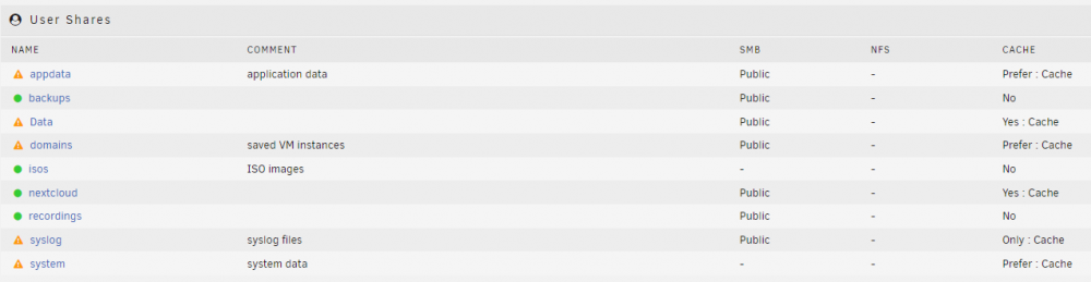

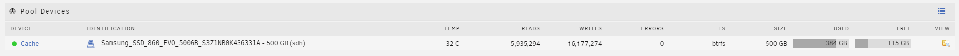

So I believe I've tried mover tuning before, but had to remove it due to bugs/issues at the time with my setup. As a note, I'm still on UnRAID version 6.12.10. I intend to stick to 6.12.xx until a couple minor releases into version 7. So these are my pool devices: And these are my share settings: Is the plugin (either the Squid version or this more recent fork) able to handle the use case of me setting a % threshold on the 'download_drive' hard drive for triggering the mover? My drive named 'cache' holds my appdata, domains, and systems files - which is pretty consistently 200GB / 1TB. It's the `Download_drive` that is constantly having new media added to it - and that is the one I'd want to have watched for when it gets close to being filled (i.e. when the 'Download_drive' gets over 70%, start moving files off of it to the array). But I'm not sure if the plugin can be set up for that use case?

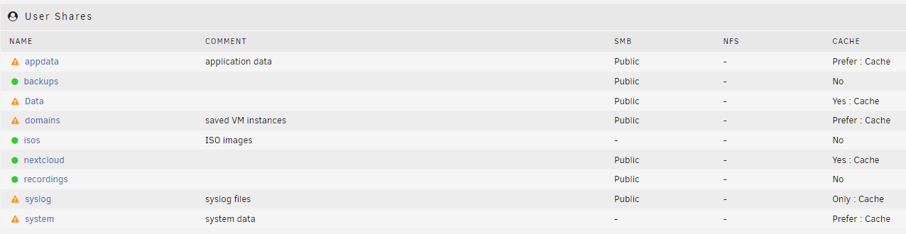

Not sure if my issue is tied into the (hopefully soon) forthcoming fix, but I realized my mover was not running in v6.11.5 recently. My leading theory was that there might be an issue with me having two cache drives (one for appdata, which I call 'cache' and one for downloads which I call 'download_drive'). In the case of the following setting: Only move at this threshold of used cache space If I have that set to 50%, is it waiting until both drives reach 50%? Is there a way to trigger it based on just the 'download_drive' specifically, in my case.

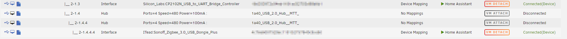

Hmm, so I tried a couple detach/attach, and it didn't seem to help. However, I toggled off 'Connect as Serial Only' for both USBs - to put them back into device mode - and it seems to be working ok now? unRAID shows "Connected(Device)" again for both USBs - see below. And as far as I can tell, Z-Wave JS and Zigbee2MQTT inside HA don't show any errors - and my Z-Wave and Zigbee devices seem to be all in working order and connected. What behavior/error should I be on the lookout for to determine if switching to 'Serial Only' is even required for me? Was that only needed for Conbee II, and doesn't apply to the types of USB devices I have? In case it matters: In my specific case, my two USBs have the exact same controller/ID: "Silicon Labs CP210x UART Bridge". Does that preclude me from being able to run both as serial or something? Or does it mean I don't even need to bother with serial-only in the first place?

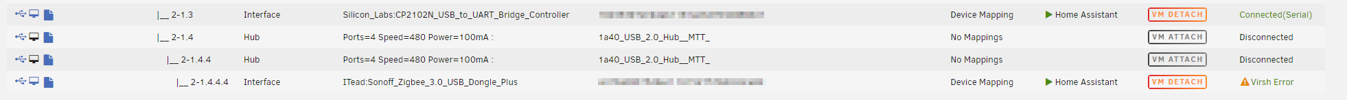

So I think I'm still having an issue with one of my USBs, after following the instructions of switching them to serial mode. This is what I see in USB manager after doing an upgrade to unRAID 6.10.3: Any thoughts on what else I could try?

So I could be wrong, but am trying to pinpoint the exact root cause here. I've been using Unraid for a couple years with no cache drive issues previously (and am currently on version 6.9.2), but I've noticed in the last week or so that my cache drive (a 500GB SSD) is staying "fuller" than usual. My theory is that the Data folder is not consistently being moved from the cache to array? In looking at the shares I have set up, the cache ends up holding appdata (65GB), domains (11GB), system (44GB). And then Data will temporarily store itself on cache (in theory), before moving to the data drives once a day via the scheduler. However, I currently see 384GB of it filled: By doing some digging, I found that the Data folder on the cache drive is currently holding ~246GB of files (it's all >Downloads>completed from my various 'arr applications). That Data, plus all of my shares marked "Prefer:Cache" seems to add up to roughly the 384GB on drive space used. However, when I total up all of the new files that have downloaded in the last day (i.e. what should be at most temporarily sitting in the cache drive's Data folder), it only adds up to ~5GB. And when I look at the cache drive's Data folder, I'm seeing torrent files that were downloaded ~9 days ago still in there. I have the mover scheduled to run at 4:30am daily: I've attached my diagnostics file. Would it be helpful for me to enable mover logging, and then post another diagnostics file in the morning after the 4:30am trigger occurs? Any help is appreciated! magic-diagnostics-20220810-1639.zip
