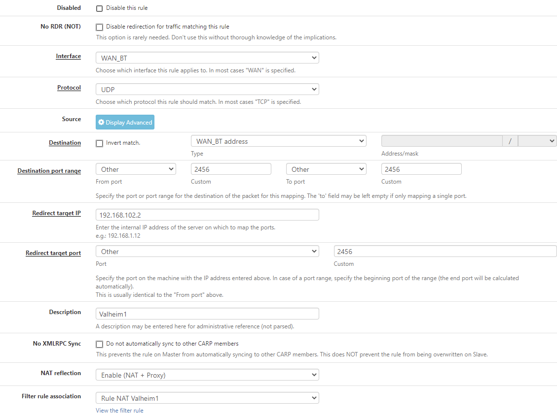

  6. No I don't have reverse proxy. I use cloudflare so on my setting within cloudflare target-down.com resolves to my actual hosting. I have A record for set with a subdoamin that resolves my external home IP valheim.target-down.com is a CNAME record that just points back to the main sub domain that tracks the IP address. but irrelevant of the domain if I were external and wanted to connect to the server what port would I use that the end? Internally it seems to use 2457 if trying to connect but is that the same externally or would you use port 2456?

  11. just wanted to say thanks for all the help this morning... At this stage I have given up trying to get it to work... i think PFsesne is just to complex for me to understand whats not going correct. Just tried a minecraft server to make sure it wasnt Valheim and I am getting the same issue. can connect locally but even after forwarding ports I cant connect with external IP I have three TCP port forwards in my pfsense settings and all of them show as port open when i use a website to check... but if I even simply copy one of those rules and change the port by 1 the port checker reports as closed so I have idea whats going on right now.

  14. ok im stumped. tried mucking around with the port forwarding and cant get it to work. I have multiple port forwards on this router and only this one seems to not work. Side not I set Valheim plus to true and can see files in the appdata folder. tried changing some of the options in the valheimplus.cfg file and restarted the server but none of the options seem to have taken... is there something that needs to be done activate it on the server?
  15. Yes I can connect using local IP No I can connect using my external IP Yes i tried connecting using a PC that is connected to a different ISP and it cannot see the sever using the external IP Does the screenshot i posted with the port forward settings look correct?

  18. as far as I know my ISP does not block ports, I have a 1gig fibre connection where the IP vary rarely changes but i moitor the IP in PFsesne I also tried on my sons PC which is routed through a different ISP (I have two lines into my house) and he cant ping the external ip either Here is my port forward settings in case I have done something silly I created a rule for each port and the IP in the screenshot is the IP of my unraid server
  19. Thanks. I had the same idea so thought I would start a fresh I pulled down the container again.. only things I have changed are Server Name, world name and the default password. I also set Valheim plus to true Started the container and shows no error in the logs, I was careful and changed the server name from the name I used last night and straight away with my internal IP address I can see the server with the new name up and running. Tried with WANIP and again cant connect and shows no server running using either of the 3 ports. is port forwarding on my router required for both incoming connections and being able to get the sever to show up in the server browser?
  20. Thanks. Server has been up all night and still cant ping it on the steam server browser like I can with my internal IP I just loaded up the game and tried to connect with my WANIP+ 2456,2457,2458 and it wouldn't let me connect but internal IP+port still works fine. The port forward i set-up on the router is pretty basic and just forwards each port from WAN to the ip of my unraid server
  21. Hi All. First of thank you for this great docker.. I need a little help with my Valheim server. I installed the docker with the base config and only changed the setting for making the server Public (but with a password) While the server is up and running and I can connect to it via my internal IP address I don't seem to be able to resolve the server using my WAN ip + port, I run PFsense as my router and have set-up port forwarding for the 3 ports in range and made sure it set as UDP only. Any advice on what might be wrong? Also I have been reading about Valheim + & BepInEx, i see the options in the docker template but am I being silly thinking all I need to do is set those to true? or do I have to download additional files from the github pages and install them on my server? Thanks in advance
