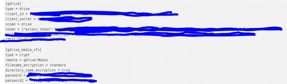

I am using all scripts from github unmodified. If I try the same thing using a cache instead and remove the -vfs options in the mountscript it seams to work but when using the crypt nothing gets mounted in any of the created folders. I tried placing a small -nfo file in the upload-folder and after running the upload-script I have a small encrypted file in my media-folder, and also a mountcheck file.

I have tried like 5 times now following the guide exactly. I even moved to a new server with new hardware with same result. The closest I have got is that I now got a "crypt file" with random letters in my media folder on google drive which is the mountcheck I believe. If I add another random file to /user/mount_rclone/google_vfs/ I get another encrypted file in my media folder. But nothing from google drive shows up on my server in any of the folders. And if I try with a standard rclone mount command I can mount my google drive to a folder without problems.

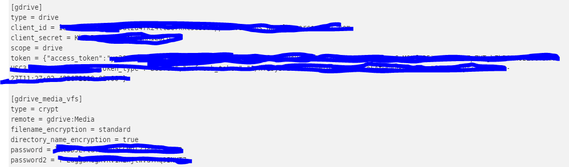

Ok, but all folders are empty and nothing gets uploaded or downloaded from the crypt-folder on my google drive. And where am I suppose to see all my mediafiles from the google drive to be able to add them to plex?

Ok, I changed my mind and tried using the crypt. But I don't understand how to get my google drive media to show up in any of the folders. I noticed that I get a new "crypt" folder on google drive, but if I add any files to it nothing shows up in any of the unraid folders.

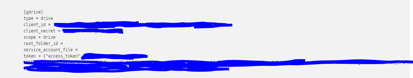

I have mounted my google drive folder using a cache and can see all my media files in it. But when I use radar and bulk-import on the path I get "Array-undefined" after a while and have to restart unraid to get my disks back. I have also tried the same thing on another server with the same result. Does anyone know why this happens? this is the mount-command: And this is the rclone config: [gdrive] type = drive client_id = <> client_secret = <> scope = drive root_folder_id = service_account_file = token = {"access_token":"<>"} [gdrive_media] type = cache remote = gdrive:Media chunk_size = 16M info_age = 2d chunk_total_size = 20G

Here is my rclone config. But as I think I said earlier, I can read/write to the mount without problem if I use the Cloud Commander app

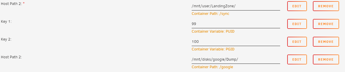

The "LadingZone" path is a local path on the drive and it works. But the google drive path does not seam to allow writes. I can see 0 byte tmp-files and empty folders being created on my google drive but no actual files gets created.
Guide: How To Use Rclone To Mount Cloud Drives And Play Files
But I can read and write to it with no problems when using a filebrowser on unraid, it is just when trying to write to the share when it is mounted in a docker container that it fails.

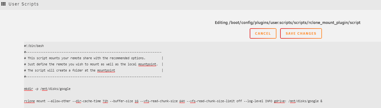

I have a strange problem if I use rclone mount to mount a google drive folder it gets created correctly and I see all the files on my google drive. I can read and write to the share without problems using a file-browser on unraid. But whenever I add the mount to a docker-container I can't write to it. Does anyone know how to solve this?
[Support] Linuxserver.io - Syncthing
I am trying to get syncthing to sync to my google drive folder without success. I have mounted a google drive folder with: mkdir -p /mnt/user/google_syncfolder rclone mount --buffer-size 256M --fast-list --allow-other gdrive:Dump/ /mnt/user/google_syncfolder & I can see the mounted folder and all google drive files and can also copy from/to my google drive with the use of a file-browser on unraid. I have also added the same directory to the path in the syncthing container. But when trying to sync from a remote syncthing-server to the unraid server it just sits at 0% and then throws a sync error. If I look on my google drive I can see that syncthing has created a zero-byte .tmp file for every file I am trying to sync If I change the path in the syncthing container to a regular folder on the unraid server it works without problem. Can anyone explain to me how to solve this?

Thanks, I guess the command should be: rclone mount gdrive_media_vfs: /mnt/user/mount_rclone/google_vfs --buffer-size 256M --dir-cache-time 72h --drive-chunk-size 32M --fast-list --log-level INFO --vfs-read-chunk-size 128M --vfs-read-chunk-size-limit off as that was the only way I could get rclone to accept the command. But when I run the command nothing happens.
