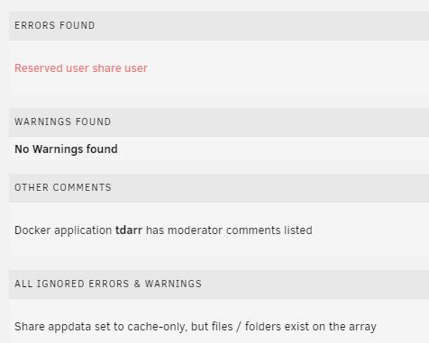

  5. Hi, I have the fcp alert coming up for having a directory called user defined in the user directory (have had it for ages and haven't figured out what to do). So i did some homework. The only files in that directory are related to the live libvirt.img file that unraid VM uses (i can see it as part of the system messages when libvirt comes up - Apr 10 13:04:00 Tower emhttpd: shcmd (306860): /usr/local/sbin/mount_image '/mnt/user/user/system/libvert/libvirt.img' /etc/libvirt ). If i was going to fix it i suspect i need to tell libvirt to put the file somewhere else - i am not sure how to do that? Its an old unraid 6.9.2. All vm's are deleted so i don't have any vm data to lose. Regards Dave tower-diagnostics-20230410-1310.zip Hi - i fixed it by looking for the extended parms in the vm's manager tab. Thanks!
