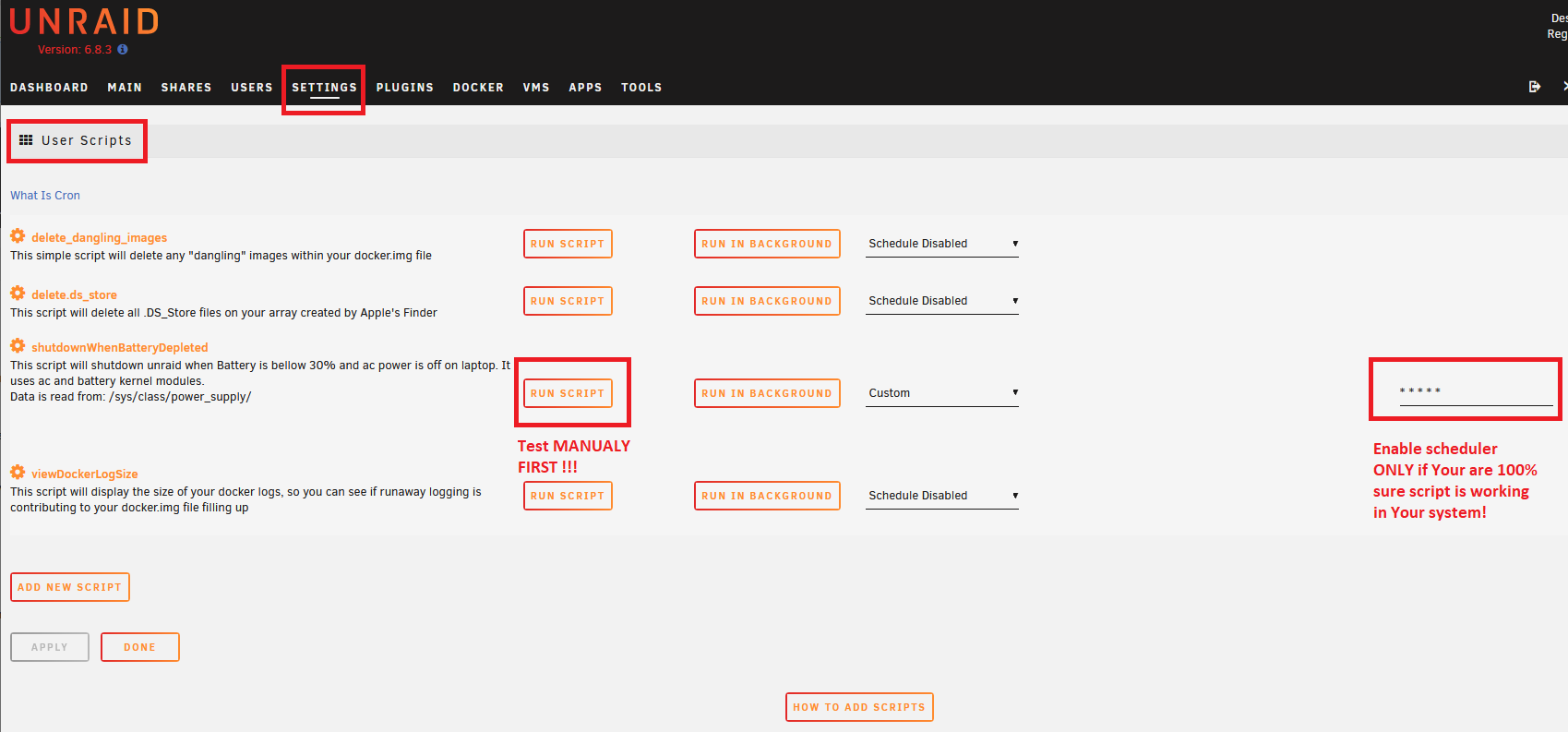

March 6, 20215 yr Hi, I am using Thinkpad W530 Laptop for unraid server. Today, after fruitful discussion on this forum I made a user.script that will shutdown unraid when laptop battery is bellow 30% and ac is off. Plugin user.script is required to use my solution. All You need to do is to extract attached archive to folder: /boot/config/plugins/user.scripts/scripts/shutdownWhenBatteryDepleted root@nas:/boot/config/plugins/user.scripts/scripts/shutdownWhenBatteryDepleted# ls -l total 64 -rw------- 1 root root 2716 Mar 6 09:41 ac.ko.xz -rw------- 1 root root 6700 Mar 6 09:41 battery.ko.xz -rw------- 1 root root 177 Mar 6 11:20 description -rw------- 1 root root 1018 Mar 6 12:54 script root@nas:/boot/config/plugins/user.scripts/scripts/shutdownWhenBatteryDepleted# It is important not to change script name, as path to *.ko.xz module is hardcoded in the script file. When this is done, You must test script, by running it manually. Then after You make sure it works in Your system You can enable the scheduler. Script will write log using logger command when shutdown is issued. On first run script will load ac and battery kernel modules. In the attached figure I am running script every one minute, but maybe every 2 minutes would be sufficient. You can enter */2 * * * * to run script every 2 minutes. Use this website https://crontab.guru to find Your preferred schedule. Use at Your own risk! For testing purpose I suggest commenting out (sign #) command /sbin/poweroff in my script. I am still unsure if /sbin/poweroff is proper way to shutdown VMs and docker gracefully. Waitng for support to answere my question, as I was unable to find it on the Internet. Best Regards, Kacper shutdownWhenBatteryDepleted_unraid6_8_3.zip shutdownWhenBatteryDepleted_unraid6_9_0.zip Edited March 7, 20215 yr by Kacper Added kernel modules for unraid 6.9.0

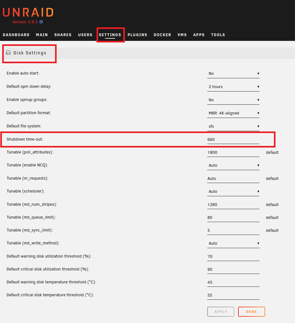

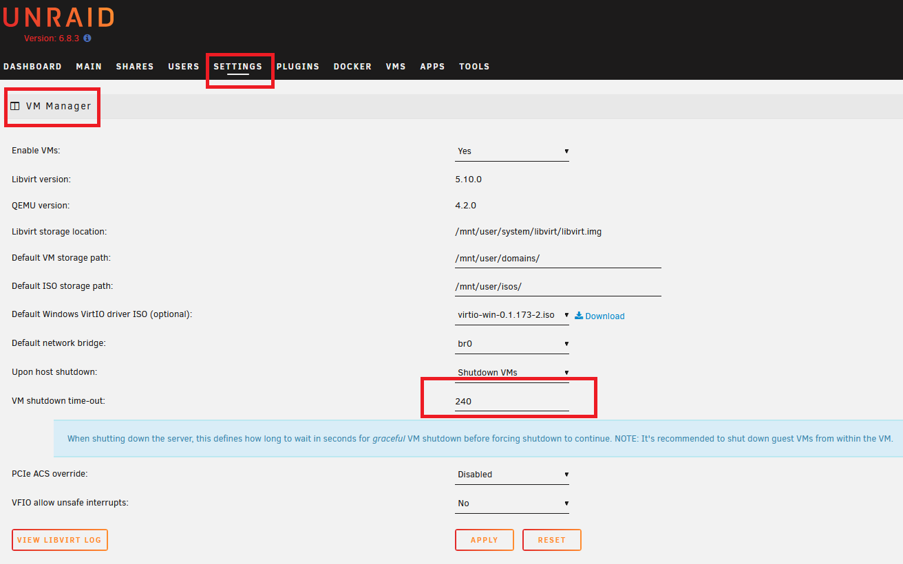

March 6, 20215 yr Author According to reply from a forum /sbin/poweroff will wait Settings -> VM Manager -> VM shutdown time-out: number of seconds before forcing shutdown.
March 6, 20215 yr Author There is also second timeout setting - global timeout that schould be greater than VM shutdown timeout.

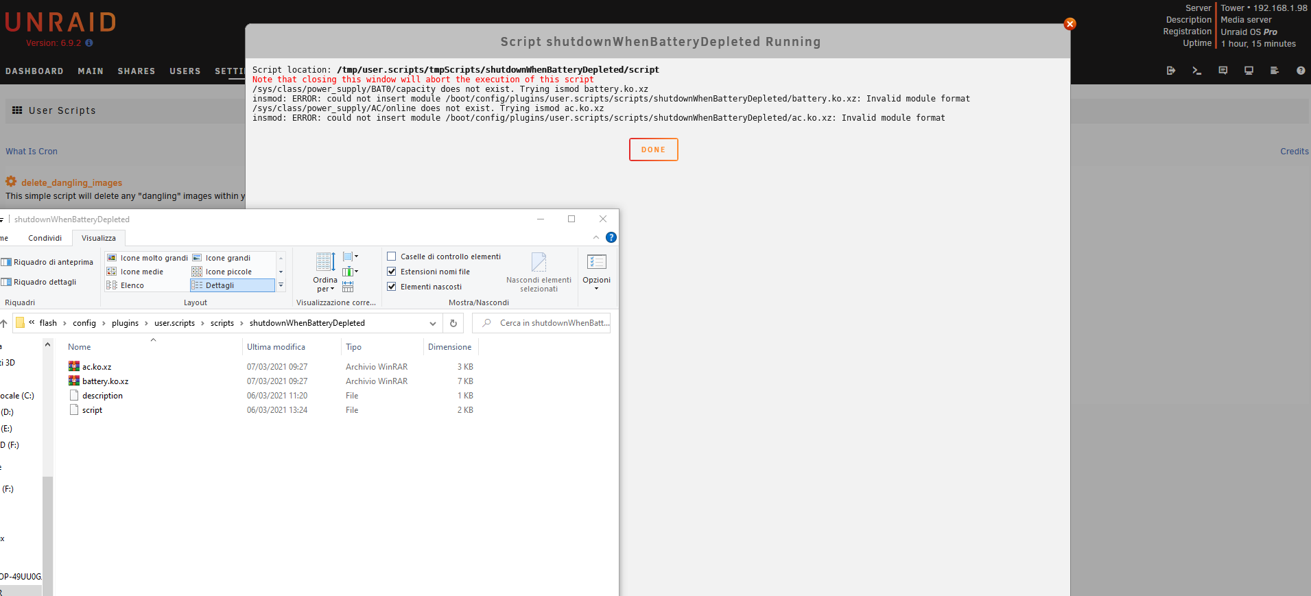

December 24, 20214 yr hi don't understand what i'm doing wrong i try to test first time after installation and it gives me this message any idea?
December 24, 20214 yr First thing to do is to get the appropriate commands working from the command line before using User Scripts as it introduces other complications
December 26, 20214 yr Author I am almost sure that this message means that module is not compiled for kernel used by unraid 6.9.2. Pay attention that I have compiled modules for unraid 6.8.3 and 6.9.0. I am still using unraid 6.9.0 as I don't want to waste time for upgrading my unraid server. It works fine right now. So you need to use docker called unraid-kernel-helper if it is already avaliable for 6.9.2 and compile ac and battery modules by yourselfe. Script will stay the same, it will work if modules load correctly.
