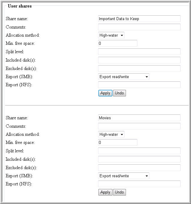

I noticed in the unraid web interface under SHARES it has sort of two sections:  one for DISK SHARES and the other for USER SHARES.  The disk shares has some NFS line items, but I assume I can just leave those blank...correct?  It is the user shares I'm attempting to setup for NFS and export...correct?
Correct.  As far as your use of the Popcorn Hour is concerned, it needs to know nothing about the Disk Shares, so you don't even need to export those from unRAID.
Thank you so much.  I'll be trying all this first thing when I get home and report back how it went.  Everything you passed on I had an inkling about except the Share Folder clarification using "/mnt/user/Movies".  I'm not sure where I should have picked up the information around /mnt/user.  From any PC I've simply been able to enter either \\Tower or the ip address of the server.  I would have thought the same applied here, but obviously I'm wrong.
One more question while I'm thinking about it if you don't mind.  Within the USER SHARES section of the web interface on the unraid server I think it asks for something like an NFS Name.  I assume if the share itself is named "Movies" then there isn't an issue with updating this to reflect "Movies" as well...correct?  I guess I'm just wondering if something entirely different should be entered there.

Peter (or anyone else who might be able to help), I hate to get this specific, but I get a little nervous when making changes to unRaid that I might not perfectly understand for fear I'm going to do something irreversible and lose data.  Attached is how two of my shares are currently configured via the web interface.  I assume I simply need to make an update in Export (NFS) box and that is all I need to utilize NFS TCP on the PCH, however, what am I supposed to put in there?  Do I list the share name (Movies)?  Is there some kind of command I put in there to make it clear I with to EXPORT READ/WRITE?  Just having a drop-down box like SMB would make more sense to me, but I'm sure there is a good reason why it doesn't have that.  Thanks again.
