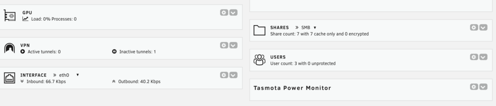

Hello Flippo
This is how it appears for me
Is that correct? I would like to see it displayed like they do.
Best regards
Edited by DarthRidar

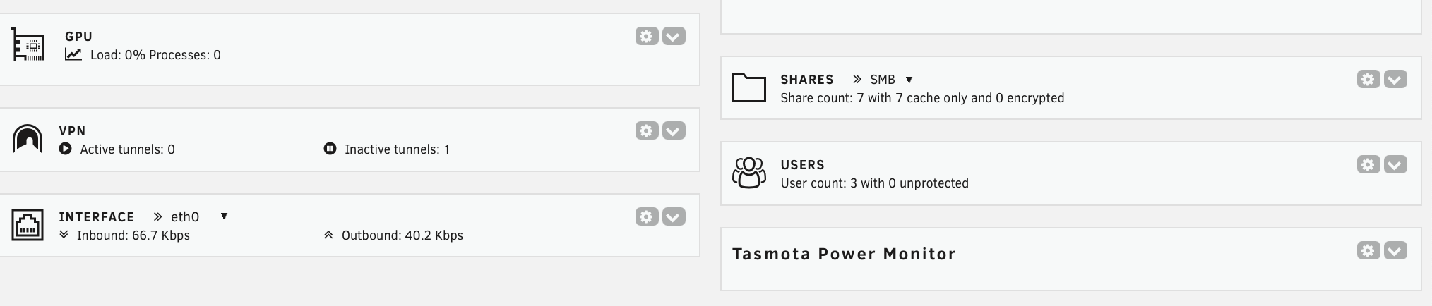

Example View. I can add IP add an option for a description to show on the top line next to usage?
I have not been able to test with data.
Here is a test package, copy to your system and run installpkg path
tasmotapm-2025.03.16-x86_64.txz
Release 2025.03.18a allows three devices.
Display with sample data for 1 and 2, not found for 3.
It work, thanks !!
A minor issue, the placement will reset if page refresh, even already lock.
( Seems only happen once either window in top left, then it will change all at top horizontal )
Edited by Vr2Io
