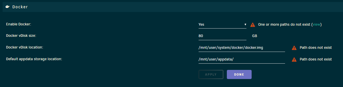

Now getting "Docker Service failed to start."
And under Settings>Docker:
