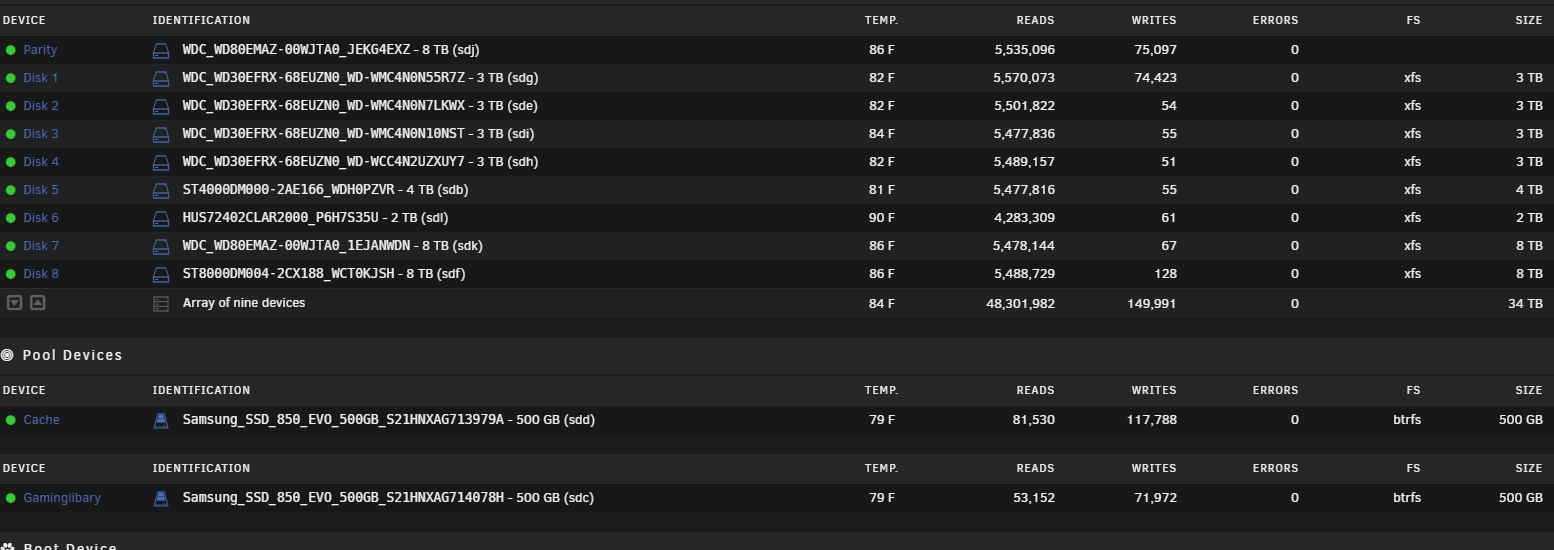

hey also what ssd iv got 2 one for plex metadata and cach
Whichever one shows as device sdd in the GUI
sorry im still not following they both show as ssd is there a diff panel i should be on too see more specific? also how would i fix the problem?
Its the cache has (sdd) at end of discription
According to your screen shot Cache is showing as sdd.  The other on is showing as sdc
ahhhhhhh sorry man thanks for the help alot will having the ram fixed help with that situation? i just changed back too 2666 as i didint see 2667 so i figured 666 would be fine.
