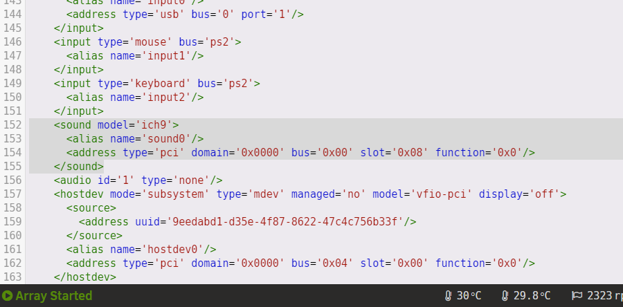

@mgutt may as extra for your german tutorial, sound on gvt-g, as there is by default no sound card, sample what i use here as extra in the xml ...
    <sound model='ich9'>
      <alias name='sound0'/>
    </sound>
also, after settings up RDP, sep VNC, parsec, ... you can wipe display from xml so you dont have "2 Displays" to manage in Windows, feel free to adjust like you wish
slot may needs adjustment depending on configuration, feel free to adjust like you wish.
