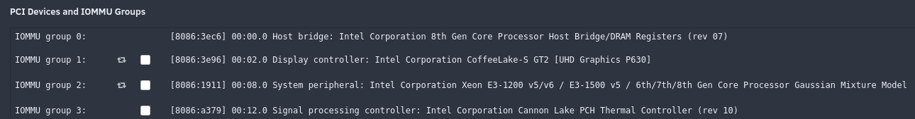

don't know why, but the iGPU of my Xeon E-2246G is not showing up in the plugin.
I'm using it without any issue for transcoding in Jellyfin and it is also showing up under system devices:
My Go file is also looking clean and syslinux is on default:
Thank you for the screenshot, actually the iGPU doesn't show up because it is named differently on your system, I will look into this and update the Plugin, don't know if I'm able to do it tomorrow but I try my best. :)

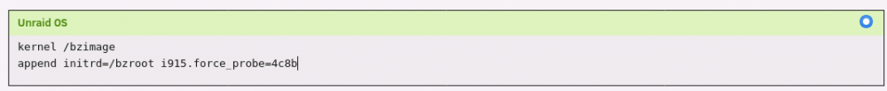

Have you created the modprobe.d file and added entries?
root@computenode:~# cat /boot/config/modprobe.d/i915.conf
options i915 force_probe=4c8b
root@computenode:~#
Edited by SimonF
root@computenode:~#
thnx. now the hw transcoding runs.
only the dirct connected monitor to the unraid system goes black with no signal. no command prompt vissible. but for me its not so important yet.
1st thnx again.
46 minutes ago, SimonF said:
Try loading intel gpu top plugin
57 minutes ago, cracyfloyd said:
force_probe=4c8b
You can accomplish this too by adding 'i915.force_probe=4c8b' to your syslinux configuration:
I would strongly recommend doing it this way, otherwise the GVT-g plugin, if you ever want to use it won't work.
Hopefully in a later kernel this probe wont be required.
