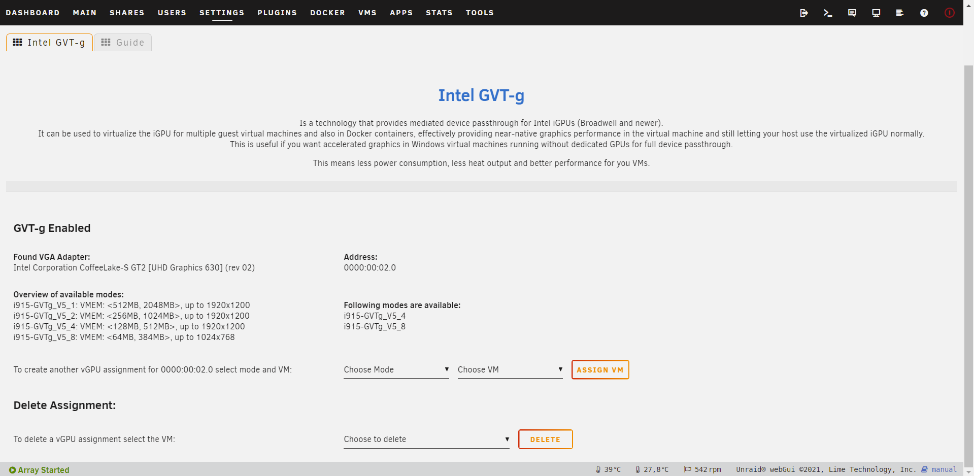

I have read through the thread and seen others with the issue but am not sure of the proper advice for this error:
Windows 10VM stalls and results in having to reboot my unRAID server.
syslog shows loads of :  "Tower kernel: gvt: guest page write error, gpa XXXXXXXX" errors
My details:
Found VGA Adapter:
Intel Corporation CoffeeLake-S GT2 [UHD Graphics 630] (rev 02)
tested passing thru as both mode V5_4 & V5_8
Tried with GuC/HuC both as default and option:0 (disabled), same issue:
Windows 10 VM (latest drivers and windows updates, all power saving disabled (screen off : never,  sleep: never))
Diags attached:
Any advice much appreciated
tower-diagnostics-20211022-2146.zip
this error occurs usually when using too much vram, sample, too high resolution
usecase, i also have a UHD630 and a running gvt-g VM using v4 mode, resolution 1920x1080, when i now rdp into this VM from a mashine with a high resolution like 1440p or even higher, RDP will auto switch the resolution inside the VM and the vram error can come up when running a little longer and can crash the host system, unraid in this case ...
may possible you are using RDP from a high resolution client ? if so, set the value "fix" to max 1080 in the connection settings, the v8 gvt-g mode allows only even less ... therefore more VM's.
as most mainboards dont allow anymore to assign more ram to the igpu we are locked here ...
if your case is different (max 1080 resolution but still crashing), drop a note.

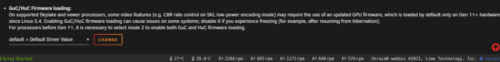

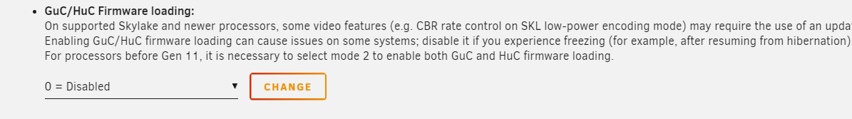

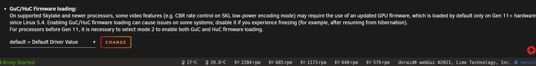

@alturismo What GuC/HuC options are you running with your UHD630?
Really appreciate the help with this and @ich777's work on this plugin.
1 hour ago, Capt.Insano said:
4. My Mainboard (Gigabyte C246-WU4) allows the 2 following options in BIOS:
whatever you can increase will help for sure ...
default if you mean this

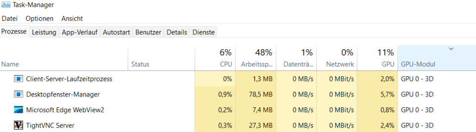

Blue Iris ... cant say anything about it if and how .... you can take a simple look inside your VM what is using the GPU

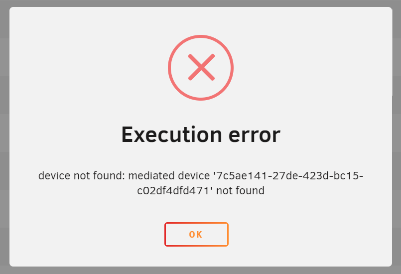

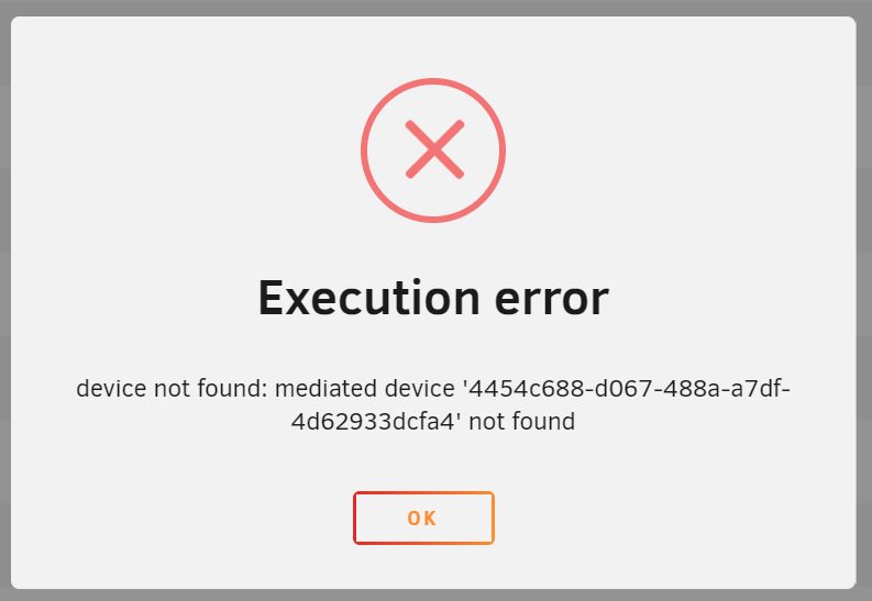

Since I have upgraded my Unraid version from 6.9.2 to 6.10-rc2 i am experiencing the following issue when trying to start a VM with a gvt-g configuration:
Does anybody else having simlar issues with 6.10-rc2?
Try to delete the assigned vGPU in the plugin and reassigning it please.
I have already tried this, but without any luck.
I have also tried different modes but I had also no success.
Edited by greenflash24
When you delete all assignments does this message also pop up or does the VM start normally?
Then the VM does start normally, the vgpu then is not available to the VM.
That's why I thought this issue must be related with the gvt-g vgpu.

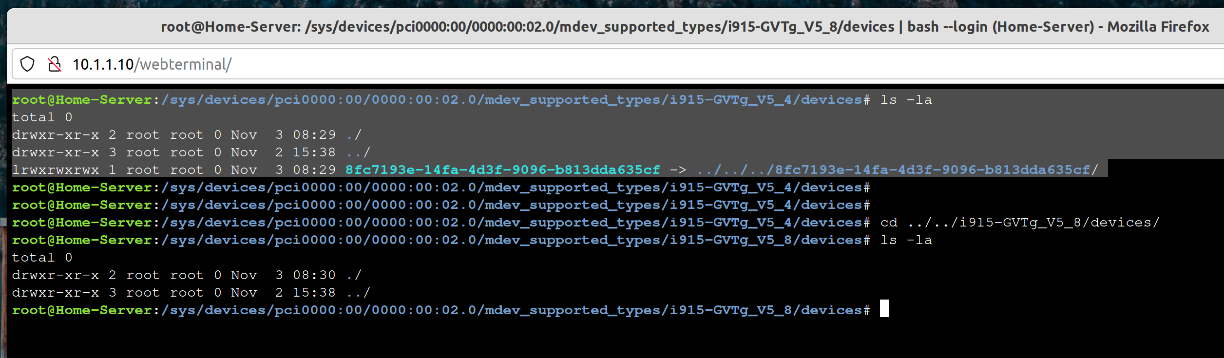

when reassigned, may post a screen from the start of this file
nano /etc/libvirt/hooks/qemu
and then the error again when starting the VM ...
After reassignment the the file looks like this (see qemu-after-assignment).
And I am getting the following error after starting the VM:

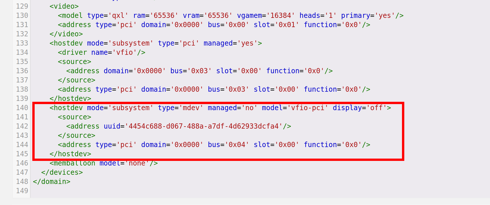

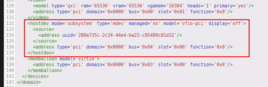

ok, may now a view from your VM Teamplate (xml view, in the buttom, like this)
and may also this just to make sure (should be empty as the VM doesnt startup)
Sure, see here:
and
