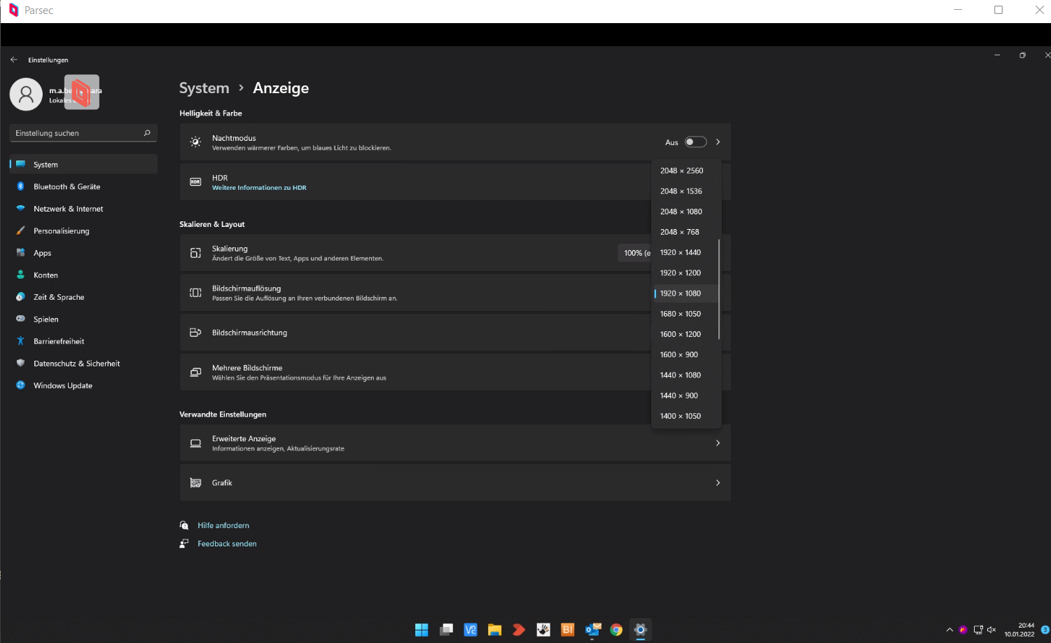

welp. im kinda new to unraid but ive already watched and read a shitton.
so ive followed your steps, set the igpu as primary device adapter in bios, created the vm with said settings installed intel drivers, setup the Intel GVT-g plugin, start VM and well.. everything works, KINDA.
i can see the igu in my device manager. when i set the second display as default (the one with the intel igpu) i get chrome hardware acceleration, i get to run parsec with intel selected and all the goods..
i just CANT change the resolution. its killing me. sometimes its fully grayed out,  sometimes after playing around enough i get the dropdown showing alllll the resolutions but it just wont change. i can open the intel config tool and again, it shows me all them shiny resolutions it just wont change them. tried both steps from the GVT-g plugin, tried the alternate VNC Video Driver, nothing.
Googling only gets me to people either having said problem with the virtual gpu, which if i chose to, can set any resolution with that i want, but then i dont get the igpu percs. Or others with dedicated gpus that in the end prolly fixed it by using a dummy plug.  what do i know 90% of posts end without and actual solution. funny enough i do even have a display plugged into the igpu. tried hdmi and DP.
im kinda at the end of the road here since it doesnt seem to be a commonly known and solved problem..
um using a fresh installed unraid 6.9.2. btw.
You have to set the resolution first over VNC and then connect through parsec, if you for example connecting through RDP you can set the resolution on the client.

ok  just bear with me please. i tried following your tutorial step by step and while i prolly confused different help topics that sounded like ppl were trying the same i am still TRYING to do it your way. nothing else. I do get the difference now tho.
that being said i neither can change resolution through RDP (idk why it shows the graphics adapters now, it wasnt like that in the beginning lol) nor can i switch res on that igpu "display" via VNC. i can cheese some applications to work on that non-igpu display with accelleration through windows but it doesnt work with parsec for example.
i mean this doesnt look like rocket surgery but i have no idea what im doing wrong.. i even tried disabling the other graphics adapter which disables vnc but i wouldnt care as long as i would be able to change res in teamviewer or parsec.. :<
tell me what you need to tell me what im missing 😕

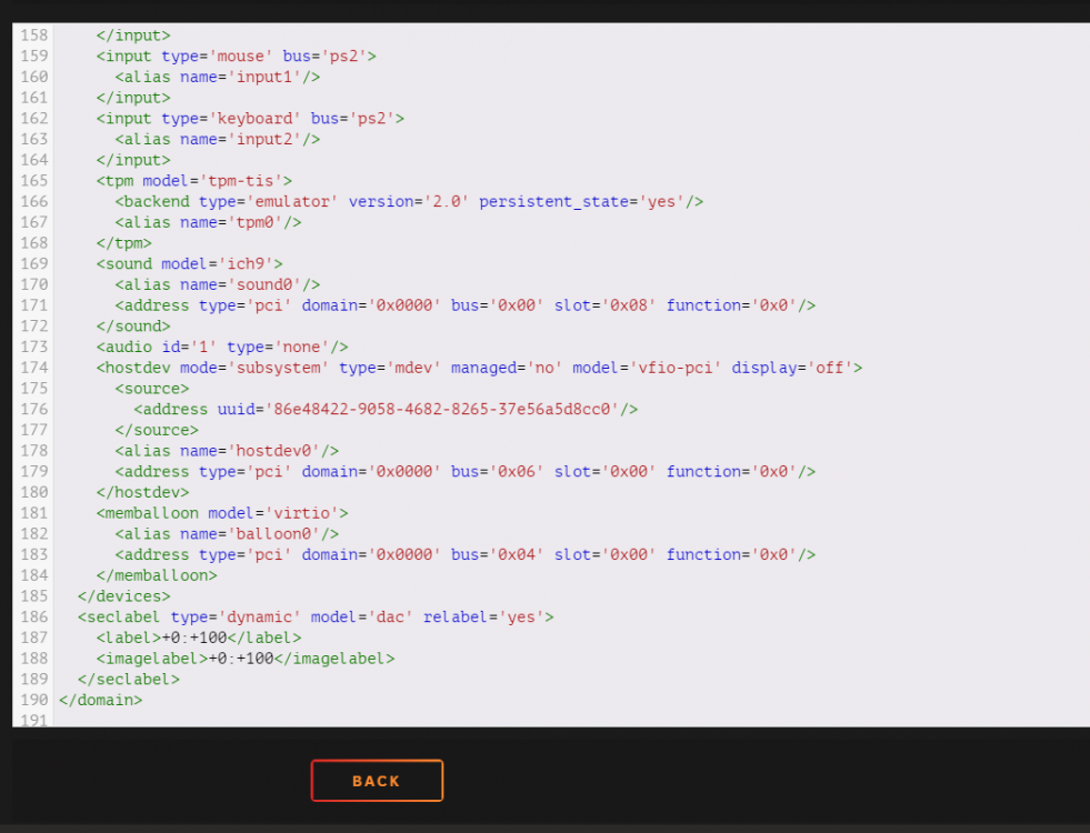

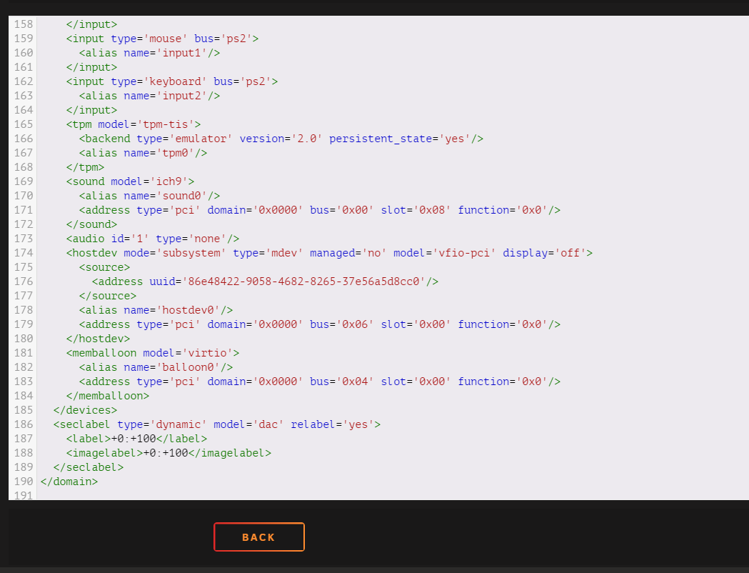

may try the following, once you have your VM running and parsec installed.
turn off the VM and remove the graphics and video part from the xml in the advanced VM edit tab.
then start the VM, you wont be able to use the VNC session anymore, but then the VNC part is gone which may cause issues.
sample from the buttom part from my gvt-g VM, you see no more video or graphics parts
1 hour ago, alturismo said:
just inside the session, nothing special todo ...
funny enough i once tried taking out the video part but didnt take out the graphics one.. tried again now and while the igpu is the only adapter left in the device manager still no dice on changing resolution.
oh and i also took a pic of parsec. teamviewer is the same, i get to chose the res but nothing changes. same as the intel conf tool. Last one even asks me if i want to keep the (not changed) resolution..
im gonna try to setup a new vm without efi using the seabios now.. i think ive tried everything else.
edit: so yeah, turns out its the first thing i should have tried. this works.

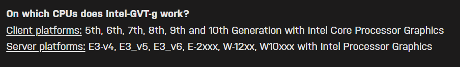

On 9/12/2021 at 8:29 PM, alturismo said:
may a note about gvt-g and 11th gen, i guess this wont happen as there is a newer feature which is the way to go i assume
https://www.intel.com/content/www/us/en/support/articles/000058558/graphics.html
just in case more ppl wait for an update therefore
ohhhhhhh my god does this mean i just kneecapped myself by upgrading to an 11th gen i5? who on gods earth woul look up if a one year old cpu isnt supoorted.. FML.
Sadly enough Intel dropped GVT-g, see also this post:
However SRIOV should be now supported but thats not supported currently on QEMU + unRAID 6.9.2+
well so i guess i did. ppl told me to get the 10400 but i wouldnt listen. for all the right reasons though because nobody talked about incompatibility :<. good thing the b560 supports both generations. i just.. bleh.
