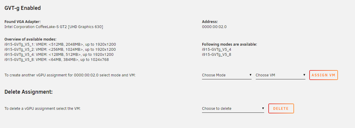

This is where im at currently
well, its showing all resolutions and you cant change it ? what happens when u set a higher resolution ?
in case its what i think you GPU doesnt get enough vram
may report the respond of this command
lspci -vv -s 00:02.0 | grep prefetchable
        Region 0: Memory at 6222000000 (64-bit, non-prefetchable) [size=16M]
        Region 2: Memory at 4000000000 (64-bit, prefetchable) [size=256M]
When I try to change it nothing happens and it goes back to the same resolution
Region 0: Memory at 6000000000 (64-bit, non-prefetchable) [size=16M]
Could it be an issue with my dummy plug?
this is looking ok, at least 1 VM with 1920x1080 should run fine

2 minutes ago, freeridekid said:
You guys got any other ideas I could try to get my resolution setup?
Sadly enough not, the available resolutions show up just fine on my machine without doing anything other than in the tutorial.
the resolutions are there, its just when i select one it defaults back to 1024x768
And you are using "i915-GVTg_V5_4" for this VM?
I really can't tell why it won't work on your machine...
I am yes

Tower kernel: i915 0000:00:02.0: Direct firmware load for i915/gvt/vid_0x8086_did_0x3e98_rid_0x00.golden_hw_state failed with error -2
cpu i9-9900es
GuC/HuC Firmware loading: Among the options, no matter which one is selected, an error will be reported
This should not be trivial for the function of GVT-g.
Have you yet tried if GVT-g is working?
Can you please share your Diagnostics?
GVT-g works fine
Select i915-GVTg_V5_4 mode, but the highest resolution of win10 virtual machine after installing the driver is only 1024x768 optional
root@Tower:~# lspci -vv -s 00:02.0 | grep prefetchable
        Region 0: Memory at dd000000 (64-bit, non-prefetchable) [size=16M]
        Region 2: Memory at c0000000 (64-bit, prefetchable) [size=256M]
Edited by s1oz
First of all, what CPU is this:
Model name:                      Genuine Intel(R) CPU 0000 @ 2.60GHz
i9-9900 ES(Engineering Sample) QQZ5
Edited by s1oz
Sorry overlooked the post from above where you've already wrote that...
As said above this is not a trivial issue, also see here: Click
It may be related that the chip that you are using is a Engineering Sample, I've now tried it again on my i5-10600 and it works without a flaw.
If you are using Parsec you can always try this: Click
