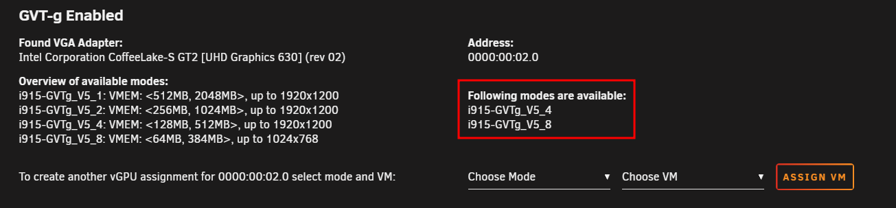

Hi @ich777
Thank you for having provided this plug-in.
I have a Core i3-9100 on a Gigabyte C246M-WU4 with 64GB of ram.
In the BIOS I’ve set the “Aperture Size” to 2048MB and vram allocation set to MAX.
In Unraid I can confirm that my aperture size is indeed set to 2GB
Memory at 6013000000 (64-bit, non-prefetchable) [size=16M]
Memory at 4000000000 (64-bit, prefetchable) [size=2G]
Based on this table from Intel:
y	aperture memory size		hidden memory size		fence size		weight
8	64				384				4			2
4	128				512				4			4
2	256				1024				4			8
1	512				2048				4			16
with an aperture size of 2GB I should be able to create at least 3 vGPUs with GVTg_V5_1, as each one should require 512MB of aperture size.
However, with no other VM or Docker container running, I can’t start even a single VM because gvt complains that it requires 2048MB of vram and I only have about 1600MB free.
Do you know why gvt is asking for so much vram?
If I reduce the weight of the vGPU to GVTg_V5_2 I can start the VM correctly and Windows 10 reports 4GB of vram available in total.
Am I missing something?

Thanks for the reply.
I don’t know enough about this to say whether my motherboard implements the aperture size correctly or not.
But when I changed the aperture size from its default value of 256MB to 2048MB I got confirmation from Unraid that the value has changed correctly.
Having approx 1600MB of vram available (as my system does) seems to be in the right ballpark.
What is strange is that the requirement to assign a GVTg_V5_1 is 4 times what it should be (2048MB instead of 512MB)

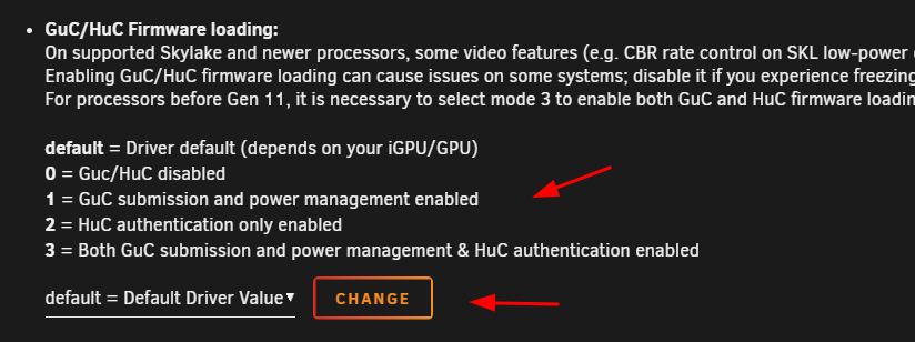

from what i see its all looking good on his side with aperture size, and as its also showing up he should be capable todo what he wants to.
im here sadly stuck on 256mb as asrock and msi cant handle it properly on linux on the boards im using, even with 1GB assigned in bios but only 256 coming on ...
may worth a try, play with the GUC/HUC firmware loadings, but be aware it could freeze the system if the VM crashes
Thanks @alturismo,
I tried with both Guc/Huc disabled (mode 0) and mode 3 but it makes no difference.
In both cases I get the same error when I try to launch the VM with a GVTg_V5_1:
gvt: fail to allocate resource high GM space
gvt: request 2048MB avail 1664MB max 1664MB taken 0MB
gvt: failed to create intel vgpu: -28
Based on the Intel spec, the GVTg_V5_1 mode requires 512MB of low GM space and 2048MB of high GM space.
I have no idea what the low and high GM spaces mean, but I seem to remember having read that the low GM space has to be less than the aperture size and that the host alone will use 128MB of the available aperture size.
As the error clearly states, my system doesn't seem to have enough memory for 2048MB of high GM space. This raises 2 questions:
1) Where is that 1664MB coming from? The only settings in the bios related to VRAM are:
     - Aperture size (set to 2048MB)
     - DVMT Pre-allocated memory (set to 1024MB which is the maximum)
     - DVMT total Gfx Mem (set to MAX). Note that other options are 128MB and 256MB. I tried to set it to 256MB but the error message still reports 1664MB available, which means that this parameter isn't linked with that memory.
2) How can someone create a GVTg_V5_4 vGPU with only 256MB of aperture size if the high GM space is 512MB? Does it mean that the high GM space has nothing to do with aperture size?

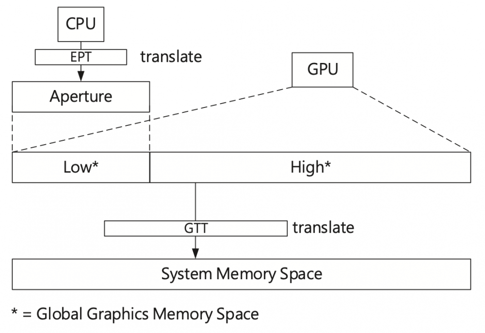

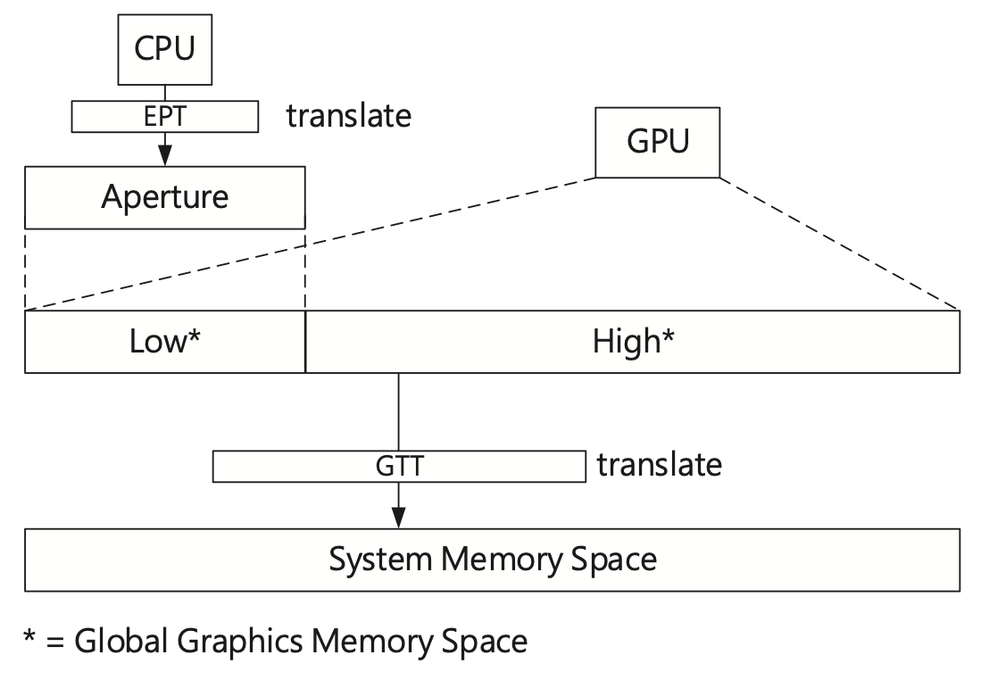

Ok, I managed to make it work.
I found this paper: https://ieeexplore.ieee.org/ielaam/71/8410754/8247267-aam.pdf
that shows this diagram:
232516669_Schermata2022-08-24alle23_03_29.thumb.png.93211ebb043314fedfe059d7252d4834.png
 together with this description:
Graphics translation table (GTT), sometimes known as global graphics translation table, is a page table providing the translations from logical graphics memory address to physical memory address, as Figure 1 shows. The physical memory space served by GTT is called global graphics memory space, which is used by all GPU components, such as the render engine and the display engine. According to the architecture of Intel GPU, GTT is a unique global register of GPU which resides in MMIO (memory map- ping input/output) range. The CPU does not access the global graphics memory space directly. However, through the Aperture [8], which is an MMIO range, CPU could also access the global graphics memory space. This CPU’s visible part of global graphics memory is called low global graphics memory, while the rest part is called high global graphics memory (high GM) or hidden global graphics memory (hidden GM). Note that the mapping between low GM and aperture is setup by the hardware directly. To be specific, Intel GPU has a 2MB GTT which maps to a 2GB graphics memory space. The aperture range could maximally be 512KB which maps to 512MB graphics memory space visible by CPU. Accordingly, the low GM is 512MB, while the high GM is 1536MB. Besides the graphics translation table, there is another type of GPU page tables called per-process graphics translation table (PPGTT) which provides each process its own local graphics memory space. Unlike GTT, PPGTT resides in the main memory. Sometimes, GPU also uses a group of fence registers to access global graphics memory. Each Intel GPU only has 32 fence registers.
This got me thinking. If the VRAM that the GPU can address is the sum of low + high memory, if I set an aperture size that is too large, there might not be enough high memory left.
I tried to reduce the aperture size in the BIOS to 1GB (from 2GB) and the VM started without issues with a GVTg_V5_1 vGPU.
I don't have any other VM set at this time therefore I don't know how many more vGPU I can create. Considering that the host occupies 128MB of low memory/aperture, there should be 384MB left.
Depending on how much high memory I got left, I might be able to create also a GVTg_V5_2 vGPU and a GVTg_V5_4.
I haven't found anywhere a command in linux that can show the VRAM usage therefore it is going to be trial and error I suppose.
PS: I tried to play with DVMT pre-allocation but it didn't make a difference.
Thank you very much for your help.
Quick update on some tests I've done, in case it is of use to somebody else.
It appears that the total GPU memory that GVT-g can address on my system is 3712MB.
This gets split between low GM space (a.k.a. Aperture Size) and high GM space.
With Aperture Size set to 1024MB, the system has the remaining 2688MB as high GM space.
I tried successfully multiple combinations of VMs with different vGPU modes.
Combo 1:
- 1x GVTg_V5_1
- 1x GVTg_V5_4
Low GM size used: 512MB + 128MB + 128MB (host) = 768MB
High GM size used: 2048MB + 512MB = 2560MB
Combo 2:
- 2x GVTg_V5_2
- 1x GVTg_V5_4
Low GM size used: 2x256MB + 128MB + 128MB (host) = 768MB
High GM size used: 2x1024MB + 512MB = 2560MB
I haven't tried more than 3 VMs in parallel but I'm expecting that 5x GVTg_V5_4 should also be possible.
For my particular system, setting an Aperture Size larger than 1GB not only is useless but hurts because it leaves so little high GM space that I can't even run a single GVTg_V5_1
Thanks again to @ich777 and @alturismo for your help!
