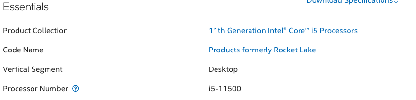

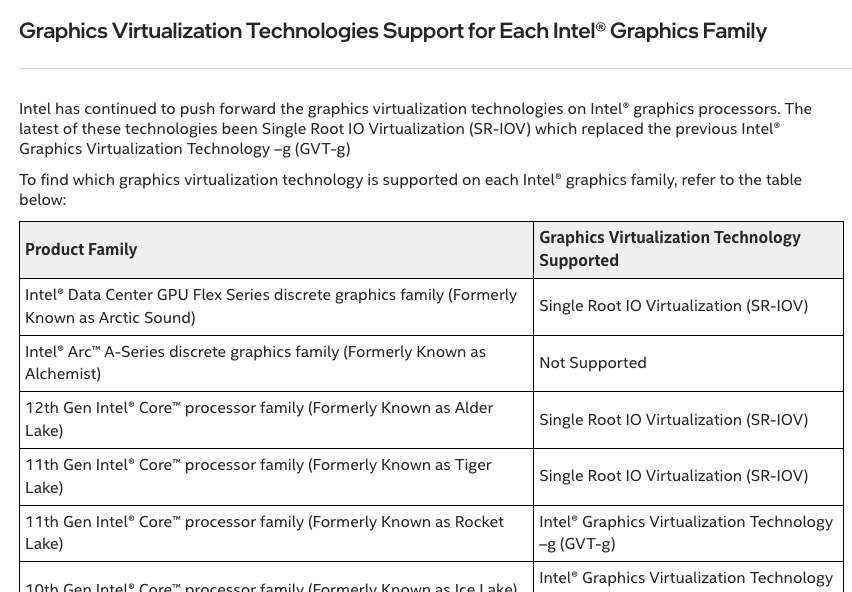

Any chance of getting this to work on the i5 11500? According to Intel it supports GVT-g not SR-IOV.
did you install and try it ?
I'm not entirely sure if that information is actually true because ARK Intel says that you have Intel® UHD Graphics 750 and this is usually Intel Xe which only supports SR-IOV
GVT-g usually depends on the iGPU and IIRC only supported up to 9th iGPU gen. (6xx series iGPUs) <- yes iGPUs in the CPUs have different generations, pretty confusing... :D
Yes I’ve installed it and that was after spending time trying to get sriov operational. I’ve had sriov working on my Intel 10g nic and can’t get this igpu working the same way.  After researching and finding out it was Rocket Lake, figured it might just be the plug-in assumes all 11th gen are the same. Sriov doesn’t show as a supported function in lspci.
Thanks for the help.
The driver itself actually probes if the iGPU is capable of GVT-g, please remember this thread has nothing to do with SR-IOV...
If it doesn't show up on the plugin page or better speaking tells you that GVT-g is not supported then you are out of luck for GVT-g.
Thanks for the help. I thought as much but figured I’d ask. I appreciate it.
