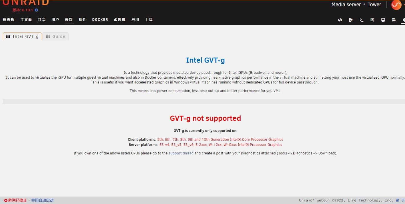

Hey,
i got a Asrock J-5040 ITX with "Intel® Quad-Core Pentium® Processor J5040" (Gemeni Lake Refresh?) and UHD Graphics 605 and it says "Its not Supportet"
I thought it should ^^
tower-diagnostics-20220526-1954.zip
Nope, only the Core-i series and Xeon series are supported as mentioned in the first post.
This is basically a "Atom" CPU and is not supported.
Intel GVT-g不识别12th cpu 我的cpu是12900T
