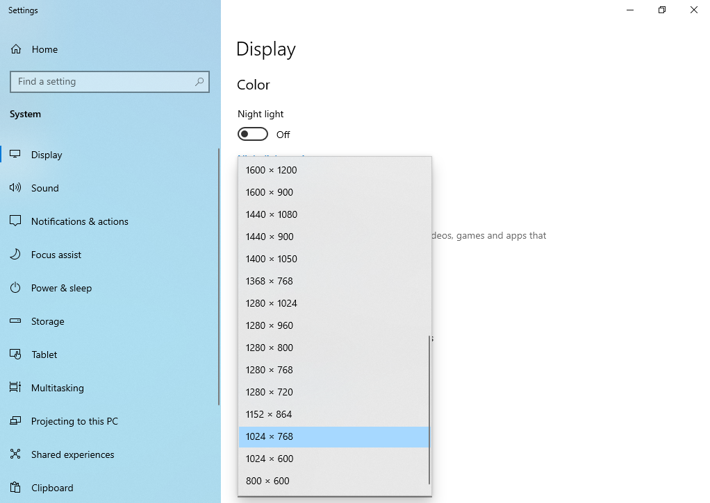

On 1/27/2022 at 2:18 PM, freeridekid said:
but now my issue is the VM is stuck at 1024x768 resolution and it won't let me change it
I am having the same issue too. Frustrating.

9 hours ago, freeridekid said:
Okay it seems I have everything working now, but now my issue is the VM is stuck at 1024x768 resolution and it won't let me change it

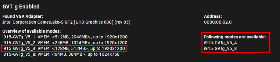

What mode are you using and what have you done so far? Is a display connected to the iGPU?
Does it work with RDP?
@alturismo do you maybe have a guess why it's not possible to change the resolution?
not really much you could do wrong there as long the GPU is injjected properly without errors (device manager, check)
for higher 1024 resolution you should use v4 and not v8
i always recommend to 1st install Win via VNC, then setup some remote app outside the QXL VNC, add the gvt-g vgpu device, remove the VNC device manually, start VM with gvt-g vgpu only ... to make sure its working, 1st boot will take some time to initialise and install driver.
always working here on windows VM's
Success! Thanks for the ideas. They worked, slightly modified.

I followed these steps exactly with no luck, still stuck at 1024x768 :(

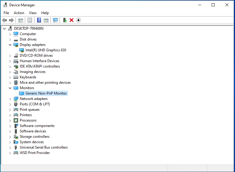

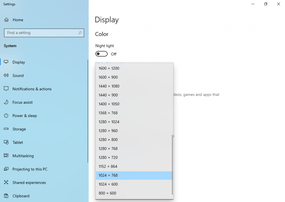

Just ran through the whole guide start to finish. Get to RDP and everything looks great. Install Parsec and log in and im stuck at 1024x768
Should it show 2 monitors within the display settings when I log in under parsec?
I disabled the QXL controller in device manager and it now only shows one monitor, but I still can't change the resolution
Edited by freeridekid
This is where im at currently. VNC Removed manually, UHD 630 showing up, stuck at 1024x768
