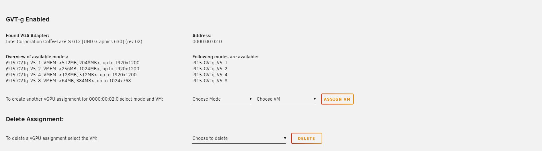

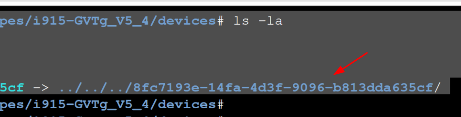

10 minutes ago, alturismo said:
and may now also please this
Here you go
To me this also looks fairly normal.
indeed ... ok, i see you still have a active vgpu running, are you running more then 1 VM with it ? which is currently active ?
different UID from your screenshot
or may just try this and see what the respond is
echo 4454c688-d067-488a-a7df-4d62933dcfa4 > "/sys/devices/pci0000:00/0000:00:02.0/mdev_supported_types/i915-GVTg_V5_4/create"
this should now manually create the vgpu fitting to your VM
There could be the problem ...
I do NOT have any VM running where i have a vgpu attached to it. I have just 2 linux servers running, but without a vgpu assignment.
When I first experienced this issue, i thought it might help to delete all assignments and recreate them one by one.
Currently I have only created the following assignment:
And this VM is stopped because it wont start without the error.
So no other VMs with a vgpu running.
please try again after my post above
5 minutes ago, greenflash24 said:
also not working
ok, there we have the error ;)
i guess its your "older" test you made before ...
now lets remove the existing one, replace the UID (REPLACEHERE) with the one i showed you above from your pasting, this should free up the space ...
echo 1 > "/sys/devices/pci0000:00/0000:00:02.0/REPLACEHERE/remove"
Okay, that has fixed my issue and I can successfully start my VM now 😅
Thank you a lot for your help!

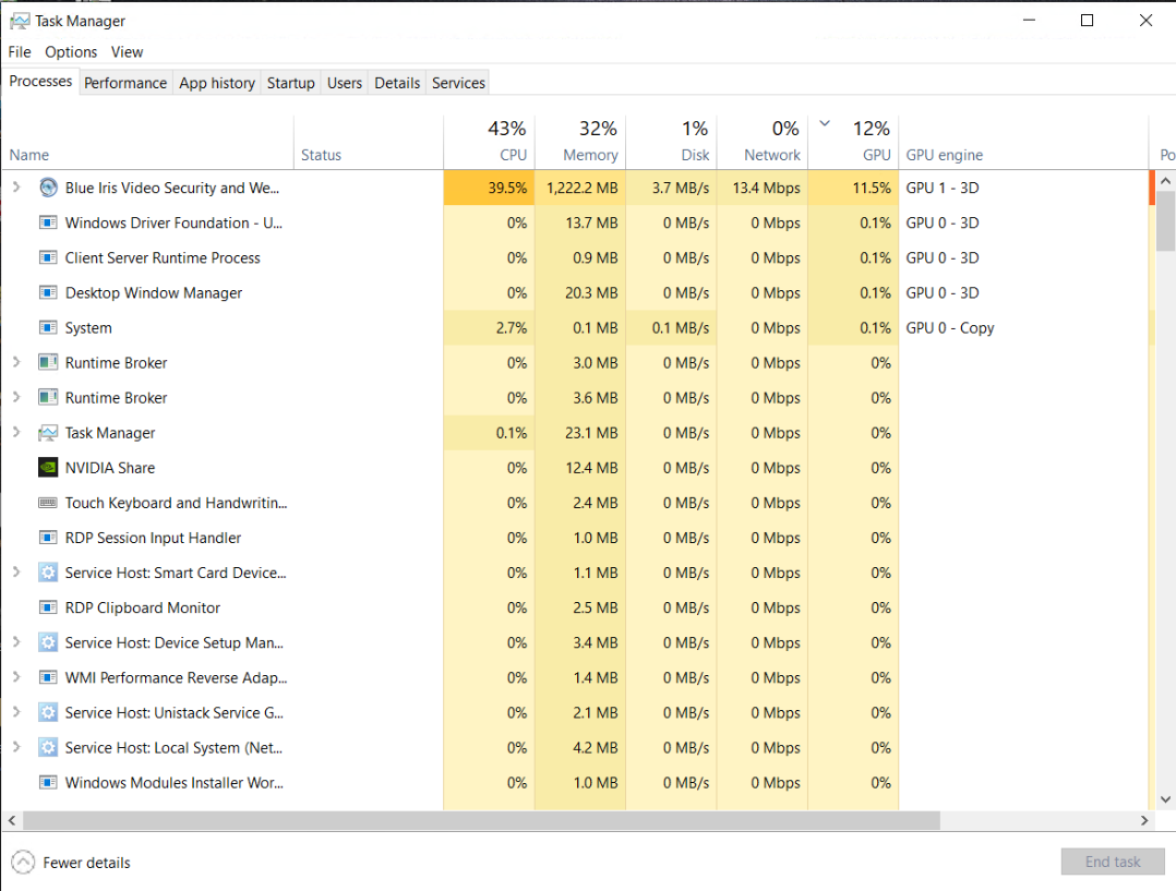

I have 5 cameras in my set up but 4 of them are fairly low res so seem to be consuming very little effort from the iGPU.
I dont know of any BlueIris setting to limit usage, however usage is never over 15-20%

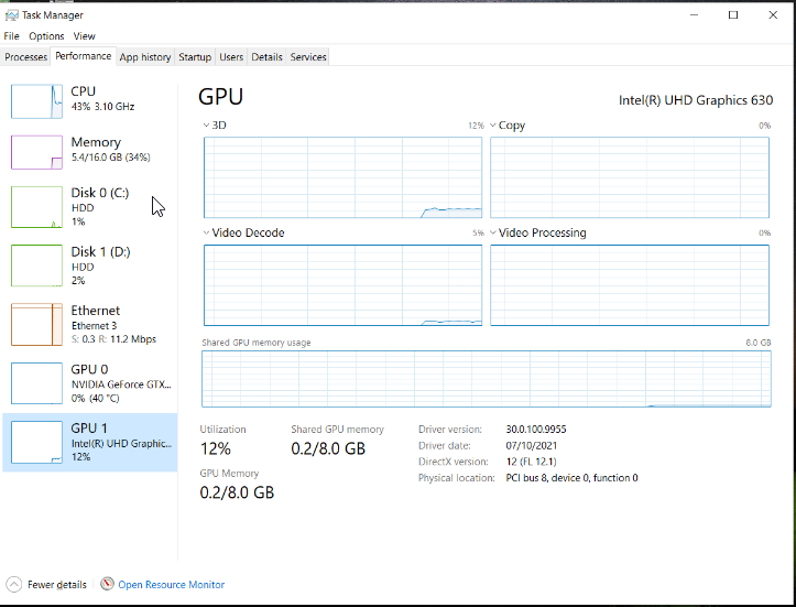

Current Task Manager status of VM:
GPU 1 = Intel iGPU
GPU0 = Nvidia Card
