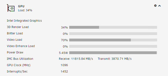

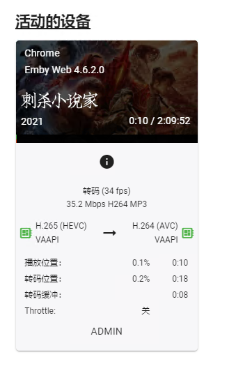

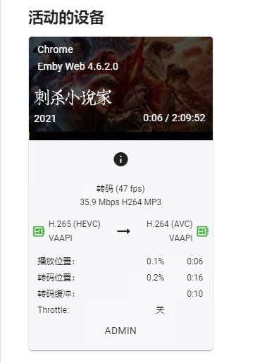

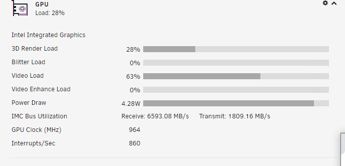

Thank you for your reply!
no ,i didn't enabled throttling.
I tried more and found something new.
I changed the mode, I used NAS use GVTg_V5_4 and win10 use GVTg_V5_4 before.
When I promoted NAS mode,it has become more efficient.
This seems to be related to the size allocation ratio of video memory.
here is result:
1、NAS use GVTg_V5_2 and win10 use GVTg_V5_8
415294065_28.png.0e84b8594fbf65e3c24652e88bb9c5b3.png336616886_28power.png.f6e93543949b958d9e175e598220e1eb.png
2、NAS use GVTg_V5_2 and win10 use GVTg_V5_4
647594574_24.png.14fa6e8931eac30d2f67358228004666.png1610478248_24power.png.66c234b9b9a53fa8c324026dd7e3750b.png
From what I see in the screenshot you are transcoding h265 to h264.
May I ask from and to what resolution you are transcoding?
Keep in mind if you are transcoding 4K to 4K that thia is not the best thing you could do since h264 was never really meant to be used for 4K.
If you transcode for example 4K to 1080p it would be more appropriate and the transcoder would be quicker.

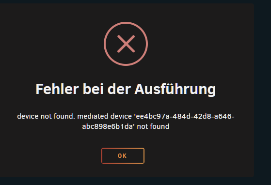

i get this error and i can't fix it:
what to do, now ?
