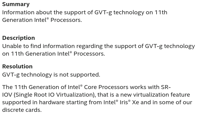

17 minutes ago, hai dai said:
12900T
11th and 12th Gen are not supported as it says on the picture that you've posted.
For more information see this post:

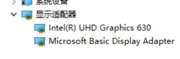

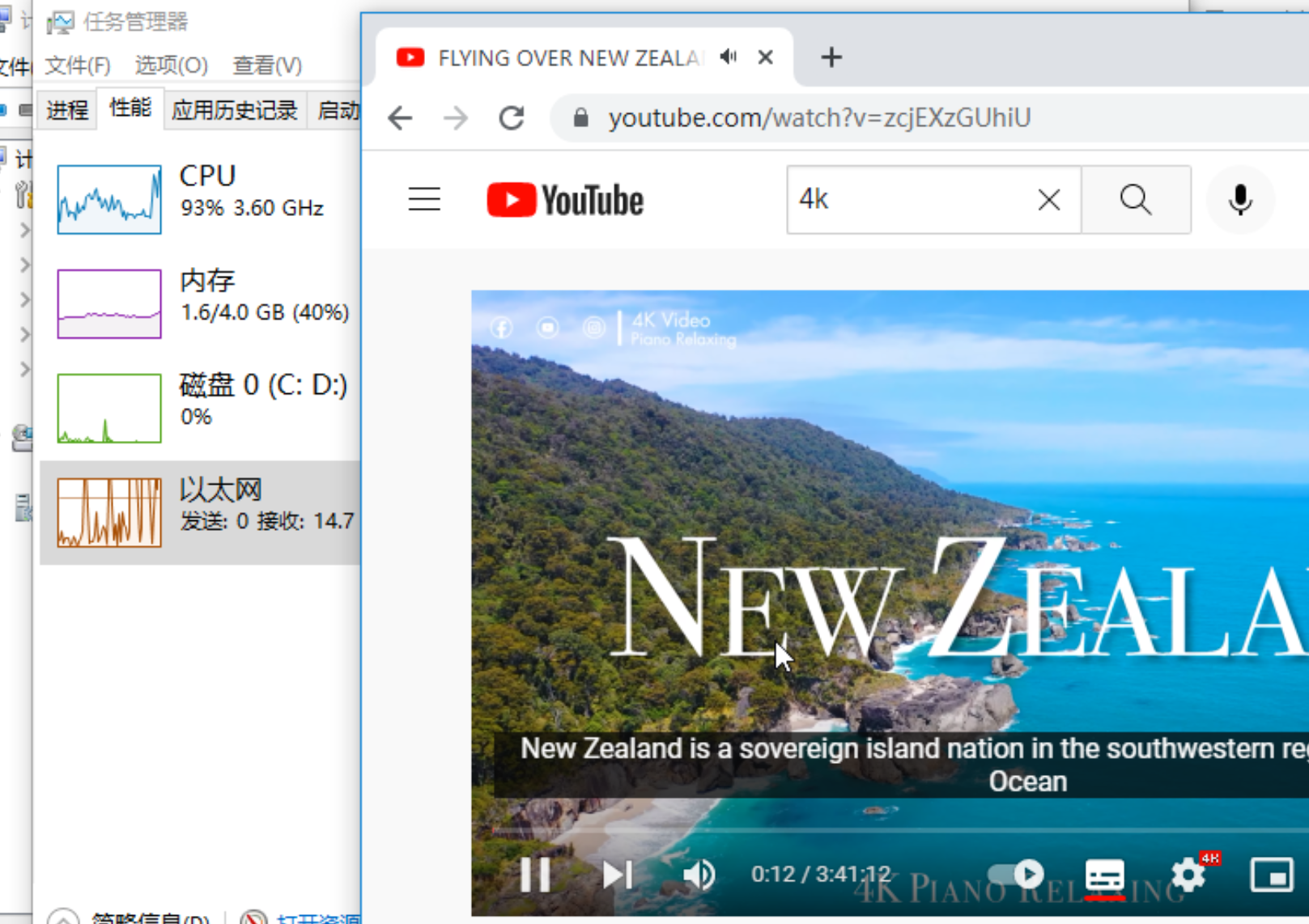

I don't know why, I can see uhd630 in the device manager,
but there is no such device in the task manager,
and youtube video playback has no effect
tower-diagnostics-20220611-2359.zip
Are you connected with RDP?

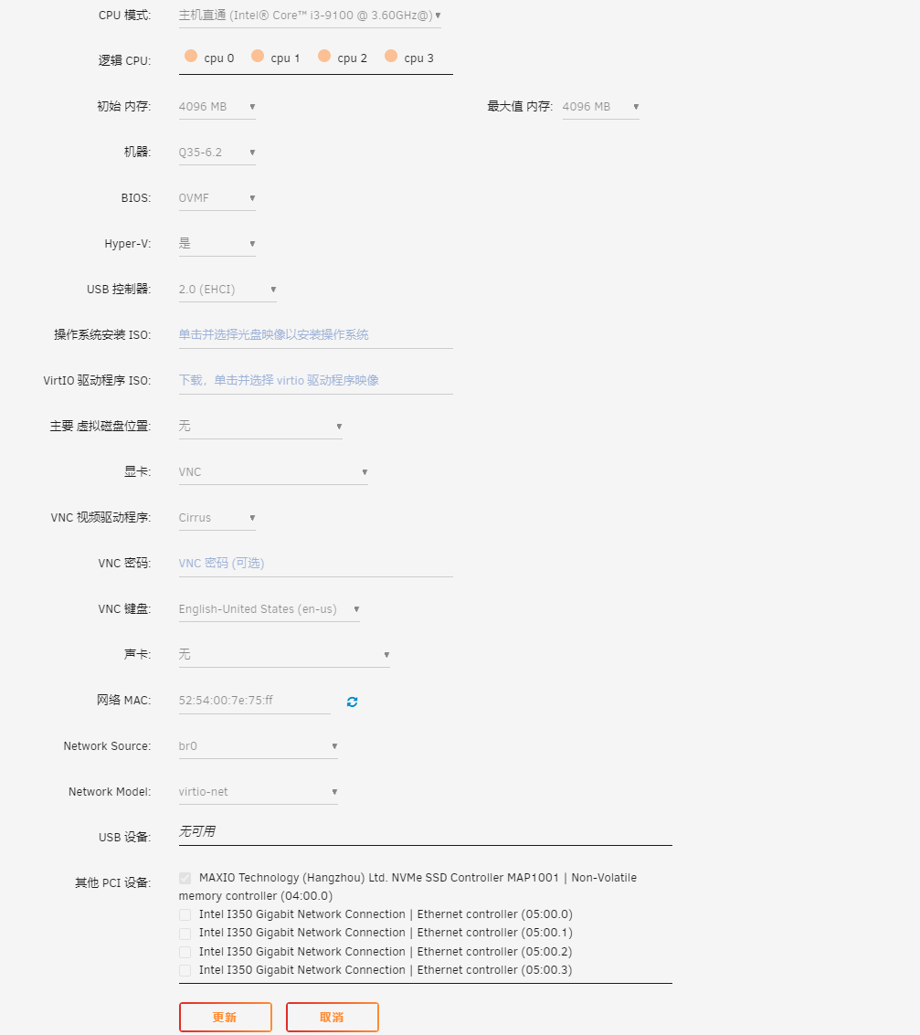

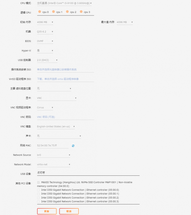

12 minutes ago, harrison.guo said:
Yes, I have used it, but the result is the same,Attach my vm settings

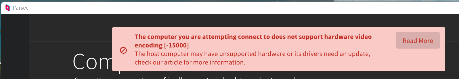

Can you try something like parsec to connect to your VM and see if this is working?

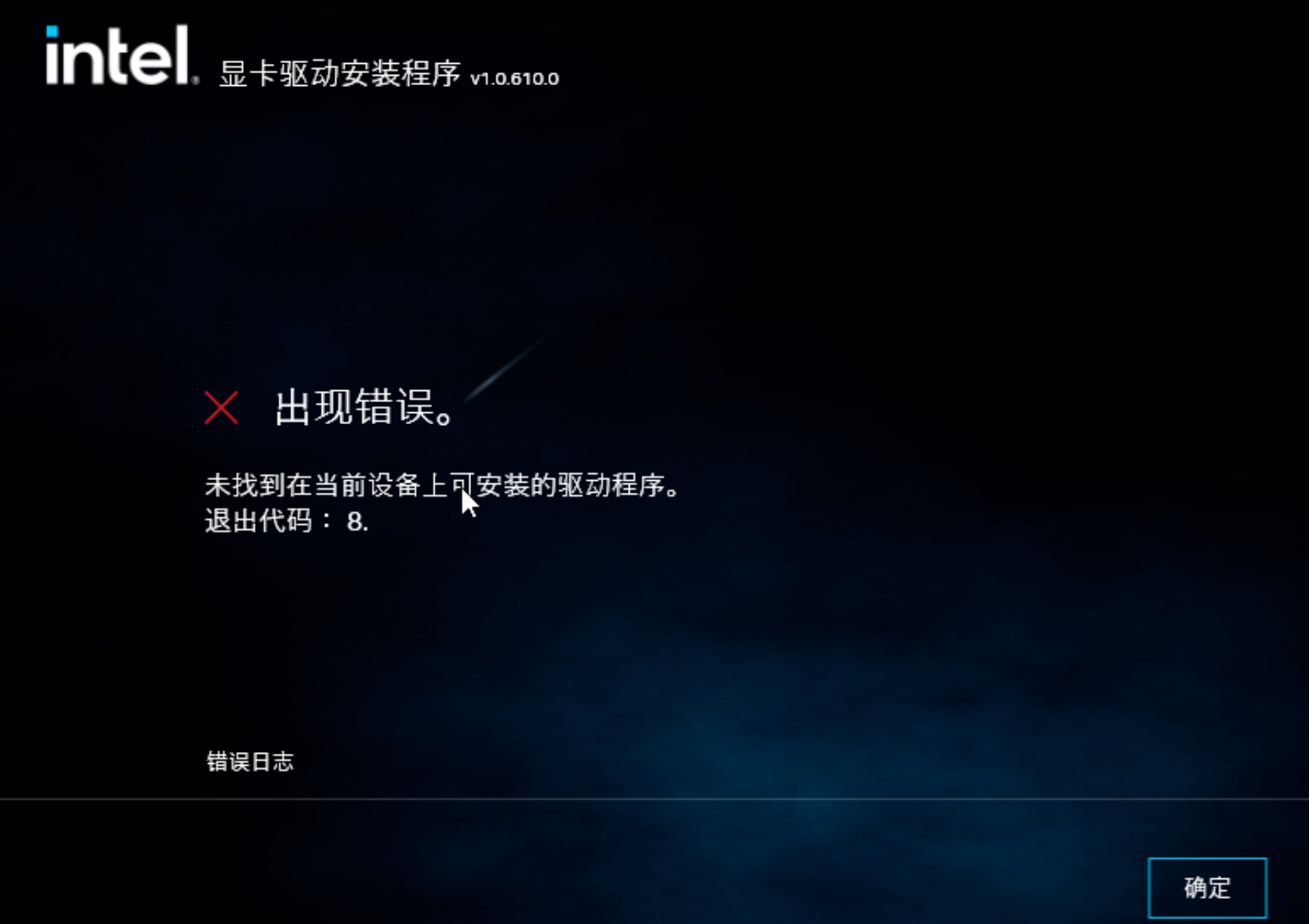

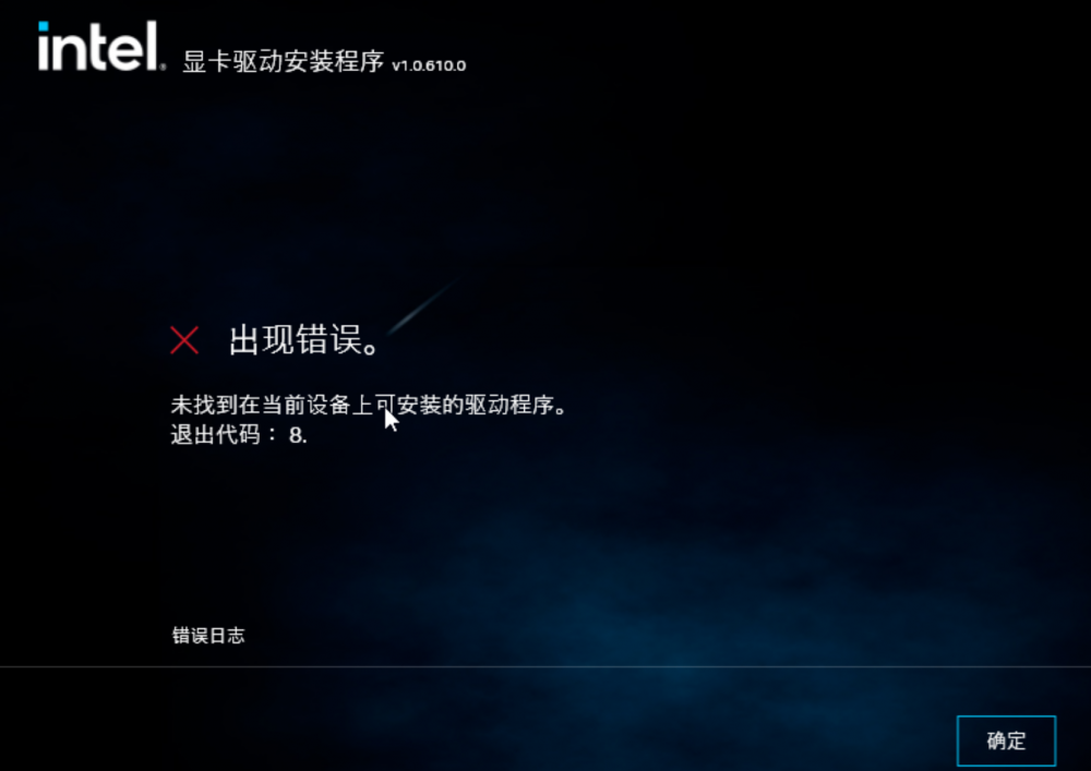

When I install the graphics card driver, it prompts 'No drivers that can be installed on the current device are found, error code 8', the log is in the attachment
IntelGFX.log
But in the above the UHD 630 is shown in the Device Manager? Do you try to install another driver over the existing one?
Are you using Windows 10 or 11? Looks like 10 or am I wrong?
I can't open the Diagnostics from above...

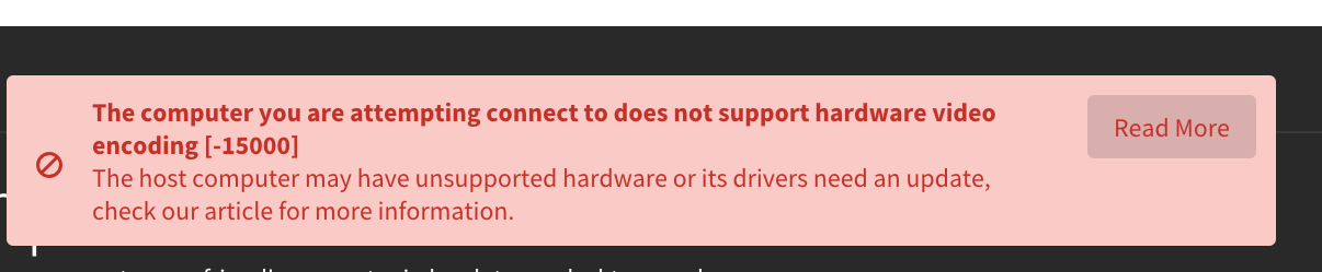

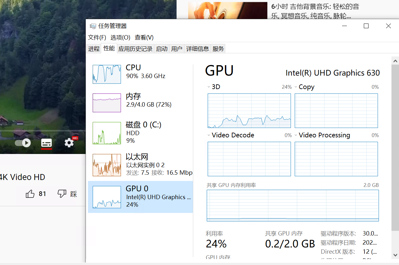

win10ltsc,I'm not sure if I'm using the lite version of the system. After I installed it using the official image, it was successful. The task manager has uhd630
but the video encode & decode didn't work, only 3D was occupied, whether I used the vnc window or RDP.

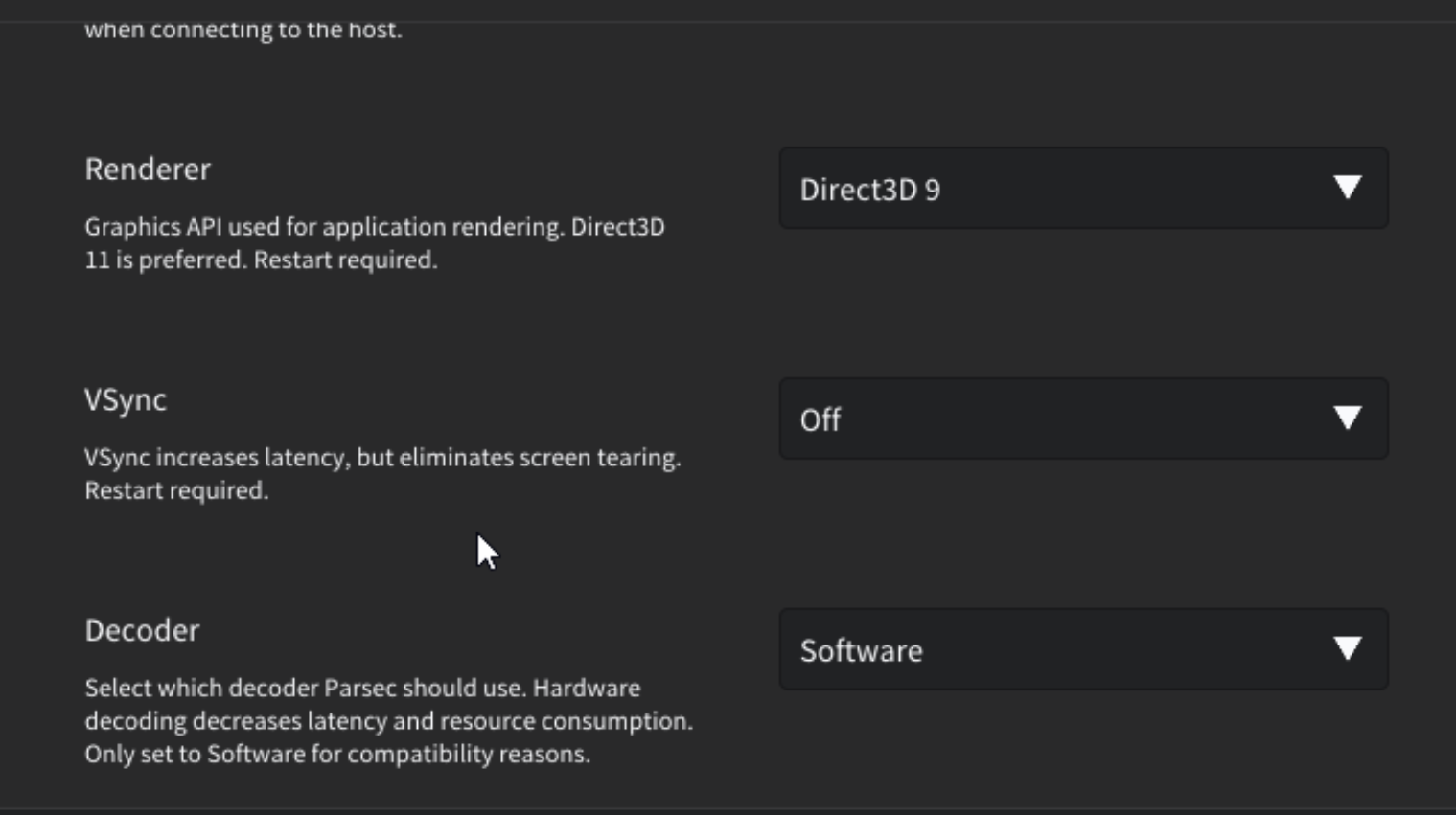

, parsec still does not work properly,
but this is also good news, at least half of the success, as long as you can find a way to solve the encoding problem. I have hevc extension installed
You are doing this with a YouTube video from what I see… Can you try to install VNC player and try it there with a file?
Encode and Decode should work fine too since 3D is working for you, I think the main issue on your system is that it deosn‘t make use of it but that‘s out of my control…
