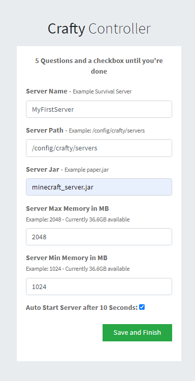

my guess with all your issues is that you didnt go through the initial setup of the first server correctly and thus folders and files were not created, on restart of the container the initial wizard is then not presented and you are then left not going what to do, am i right?.
i have just gone through a clean install of this to verify i didnt have anything that i had hand created that could mask any issues, and for me it went through without any issues, here are the only steps i took:-
1. start container
2. check /config/supervisord.log for initial login credentials and login to web ui
3. initial wizard - download minecraft jar file, for me this was the bog standard minecraft_server.jar and place in /config/crafty/servers/
4. initial wizard - change the name of the jar to match step 2.
5. initial wizard - save and finish
6. Go to Dashboard/files and click magnifying glass on eula.txt and change from 'eula=false' to 'eula=true'
7. save file and start server
8. go back to dashboard and note the server is running.
i will write up the following in a more formal state as a FAQ when i get some time.
for reference here is the screenshot of the initial wizard screen after i have configured it:-

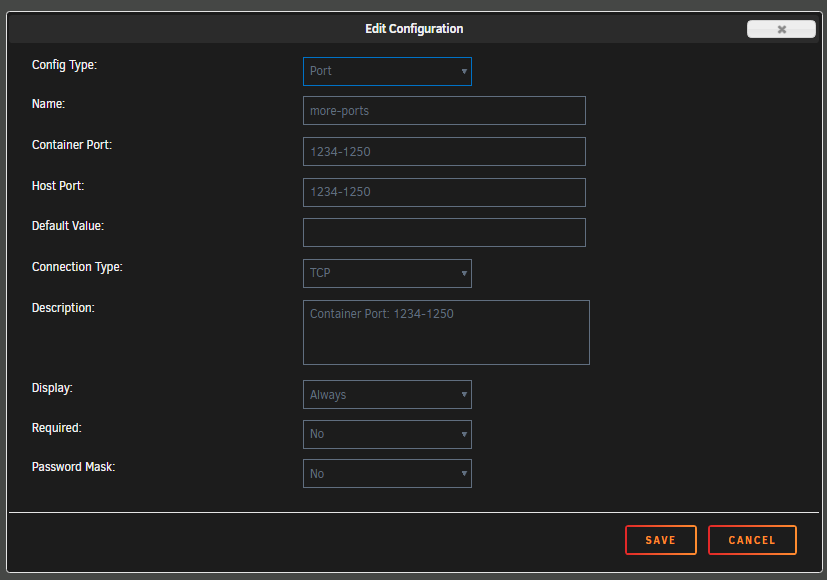

13 minutes ago, g0nz0 said:
Is it possible to map a port range back to the container like with your minos container? It'd be useful for running types of server MC server under a single solution given the admin console supports it.
sure!, nothing stopping you adding additional ports to the container.
Thanks. I'm too used to running raw docker or docker under rancher, so just trying to get to grips with how to do it under un-raid. But I know there are far less technically minded people around that this feature would be super useful for.
ok its fairly simple, unraid web ui/docker tab/left click and edit crafty container, scroll down to the bottom and click on 'Add another Path, Port, Variable, Label or Device' select config type of 'port' then define the container and host ports you want to add, if you want to do a range then use a hyphen between the port range, an example:-
click on save and apply.
Thanks, I hacked it in by adding an additional variable (-p <port range>:<port range>) in the advanced tab  which work, but this way looks more sensible. I'll update my config in a bit to use this method.
1. start container

- I left default path, which I cannot remember but was NOT what you show in the pic above.
- I left default jar, which I think was paperclip.jar. NOTE, I haven't manually downloaded ANY server jar, as I expected this to do it automatically or something. It defaults to "paperclip.jar".
- It failed again, this time with "Invalid Settings Detected: Server Path Does Not Exists".
- I tried to restart the container. Well... that was the last time I saw it.
...container starts but web GUI doesn't work ever.
- I removed the whole container and re-added it (again only changed port), only to find that AGAIN GUI didn't work at all! BEFORE me doing anything (but container runs).
- This time the log doesn't show any login info.
...so what to do next? Remove again and do some appdata clean up first?
Also (provided I get a GUI again), can you elaborate on step #3?
OK EDIT:
Cleaning up appdata helped.
I did the steps as you listed them.
This time the create server step went forward.
Server started.
Now to see how to actually use it (especially looking for the "launcher" part...).
Edited by NLS
