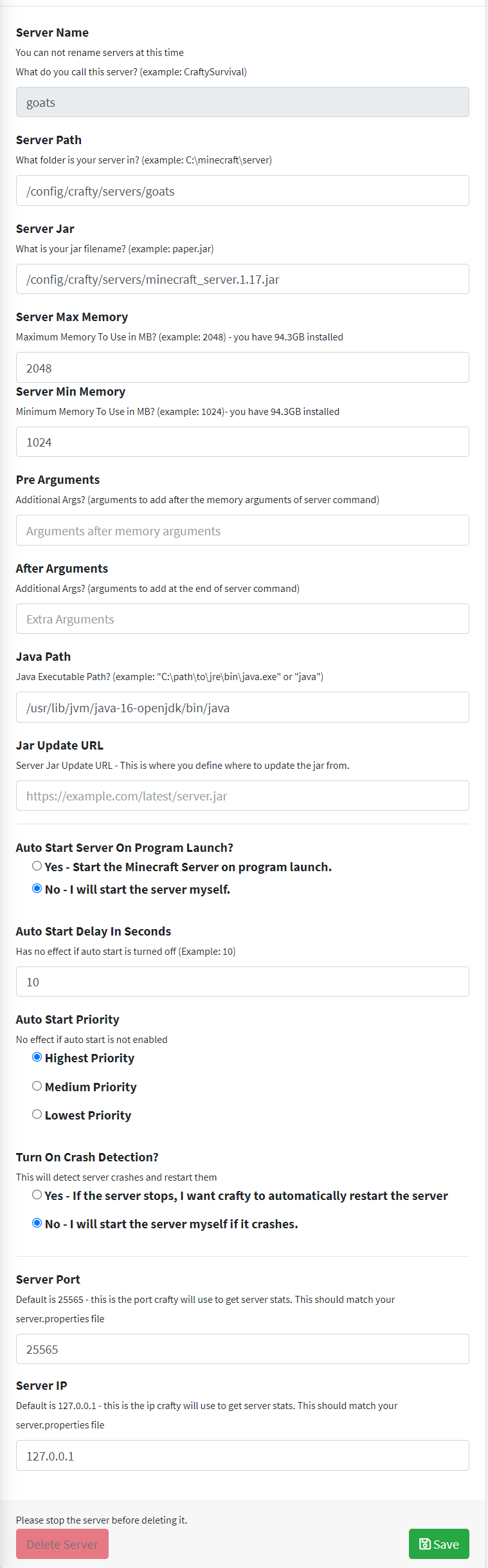

got this up and running. I saw a few of the errors others had experienced. Here are my steps, with a screenshot.
When I tried to get it running, I was having a few problems: no files were being created. This was because I didn't pay attention to the FAQ binhex wrote for new Minecraft 1.17: requires java 16. https://github.com/binhex/documentation/blob/master/docker/faq/crafty.md
I also want to run a couple of worlds at the same time, so the default settings for me aren't quite right.
  1. downloaded 1.17 minecraft https://www.minecraft.net/en-us/download/server
  2. saved minecraft.java to /mnt/user/appdata/binhex-crafty/crafty/servers/minecraft_server.1.17.jar
    (the docker translates this to /config/crafty/servers/minecraft_server.1.17.jar, see the docker settings > Show More Settings)
  3. made sub folder for one server binhex-crafty/crafty/servers/goats
  4. Server Name "goats"
  5. Server Path /config/crafty/servers/goats
  6. Server Jar /config/crafty/servers/minecraft_server.1.17.jar
    default it'll look for the jar in the folder of the server. I didn't want it to do that, so put the full (albeit Docker map) path to the jar I wanted
  7. Java Path /usr/lib/jvm/java-16-openjdk/bin/java
    very important. See binhex FAQ link above, and pinned on this thread. Minecraft 1.17 requires a newer java, so we need to specify that path to the new java
  8. hit start, will create files
  9. edit eula.txt from False to True
  10. bob's your uncle

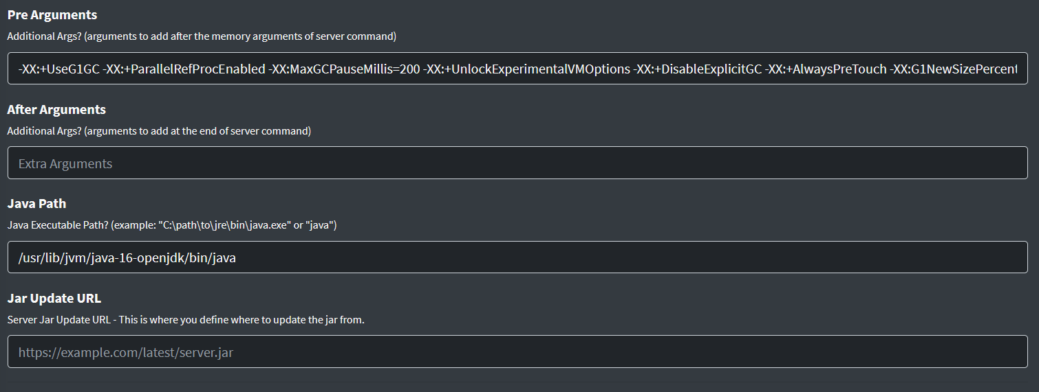

  1. Java Path /usr/lib/jvm/java-16-openjdk/bin/java
I've added that path to the correct box but after restarting the servers I still get:

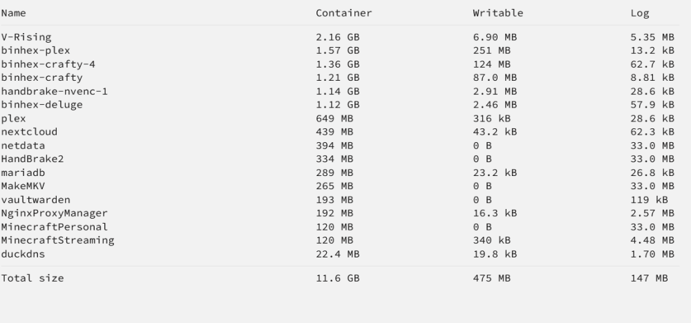

Hmm. I have used the Crafty container for a bit and I realised that Crafty is using up 14GB of my Docker image! I had to expand my Docker image size to accomodate it.
This seems highly unusual for what should be a very lightweight container. I only have one (1.17) server running from it and not many plugins. What is the issue with this and how can I solve it?
Are you creating automatic backups into the docker instead of appdata or a separate share?
Are your servers in appdata?
THANK YOU. Yes my backups were in the docker. Just fixed it by putting it in a subdirectory in my appdata share
