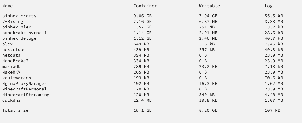

Hi, wandering if anyone can help.
My docker image keeps filling up, and crafty seems to be the culprit, I initially thought it was due to my mappings, but I had fixed this (or so I thought) and my docker image size decreased, however it has slowly been filling up again and I can't for the life of me figure out why.
I can provide any required information, on request.
Thanks, - Myles

The docker logs don't show anything in particular that looks to be an issue.

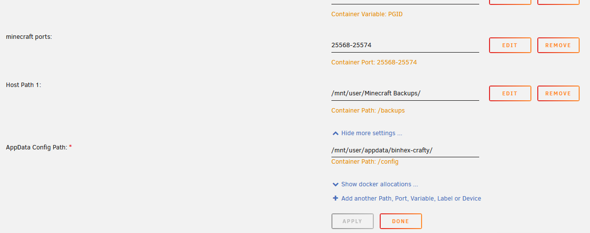

Here's a picture of my mappings inside the docker template...
To the best of my knowlege (which is flakey at best), things should be writing to those locations/shares. backups are correctly written to the Minecraft Backups share,  as I can go in and see them there. And my servers themselves are located correctly in /appdata/binhex-crafty. So I'm sure as to what's causing the size of the docker increase.

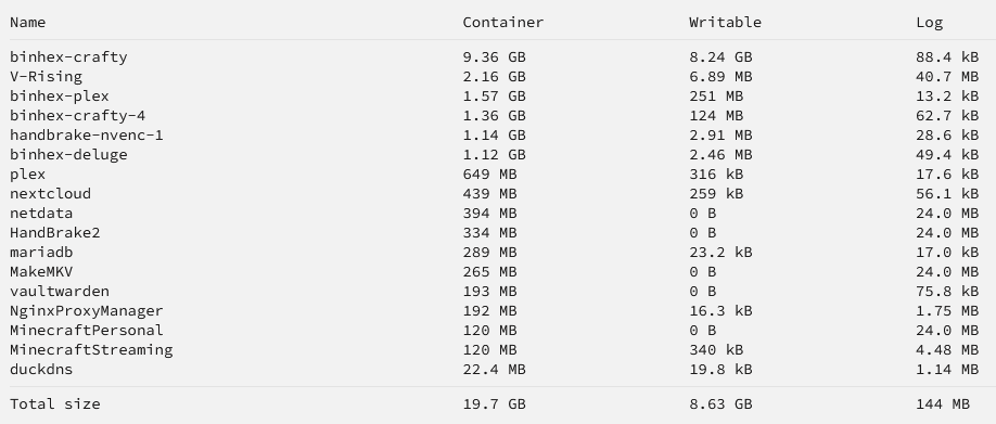

This screenshot was taken 2 on 30/10/22
And this one just now, I've not done anything to the docker except start it up, and it just keeps getting bigger
So it must be something to do with how I've got it set up, I just can't figure out what :/

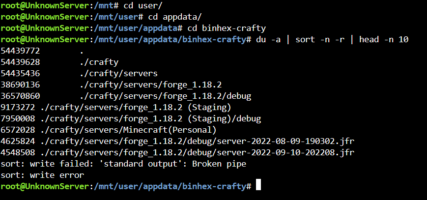

Open a terminal, go to offending container and:
du -a | sort -n -r | head -n 10
...to at least know where to look...
This is the result of doing that:
so you see the folders that seem to be too big
look in there
@Myleslewis looks like Crafty is def the one misbehaving. So, I saw your screenshot up there of part of your Docker config for it, it refers to
/mnt/user/Minecraft Backups
so: make sure that that folder exists in your array.
Also: are you clear how these paths work? Dockers are sorta locked into their own little worlds. When you add a Path to the Docker config, it will give the Docker access to a spot outside it's little Docker universe. In this case, the Crafty Docker thinks it's looking at
/backups
and it will read and write to, where it thinks is /backups
but it will actually be /mnt/user/Minecraft Backups/
like:
/backups -> /mnt/user/Minecraft Backups
