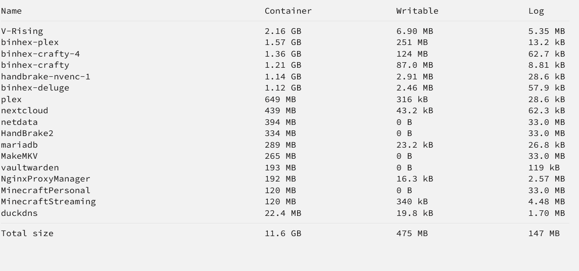

17 hours ago, dkerlee said:
@Myleslewis looks like Crafty is def the one misbehaving. So, I saw your screenshot up there of part of your Docker config for it, it refers to

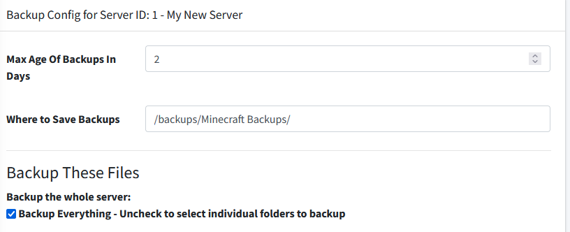

/mnt/user/Minecraft Backups
so: make sure that that folder exists in your array.
Also: are you clear how these paths work? Dockers are sorta locked into their own little worlds. When you add a Path to the Docker config, it will give the Docker access to a spot outside it's little Docker universe. In this case, the Crafty Docker thinks it's looking at
/backups
and it will read and write to, where it thinks is /backups
but it will actually be /mnt/user/Minecraft Backups/
like:
/backups -> /mnt/user/Minecraft Backups
Hi dkerlee, thanks for your response !
I can confirm that /mnt/user/Minecraft Backups exists, and I've tripple checked the case of the lettering etc.
I have a basic understanding of the paths, though you've made me think... Inside the container, in the UI, I have my backups going to /backups/Minecraft Backups/ like this:
Could that be causing issues ? It is writing correctly to the location on the array as seen here:
Which all looks correct, so this is why I'm confused, as it appears to be working as intended!
Hi binhex, thanks for your response !
I've tried the below...
11 hours ago, binhex said:
Tip, change du -a to du -ah to make things easier to read
Sent from my 22021211RG using Tapatalk
And this was the outout, same as before.
Really stumped on this one :/ Could there be anything in my diagnostics file that could suggest what's causing the issue ?
Thanks, - Myles

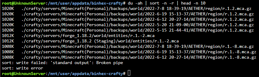

Something weird I noticed, I don't have time to look at this more right now, but the command you ran:
du -a /dir/ | sort -n -r | head -n 20
(where "/dir" is the directory in question)
returns a bunch of files that are "1020K" but those files are NOT 1020K.
sh-5.1# ls -S -lh
total 980M
-rw-rw-rw- 1 nobody users   11M Aug  8 02:40 r.2.6.mca
-rw-rw-rw- 1 nobody users  9.9M Aug  8 02:40 r.-4.-3.mca
-rw-rw-rw- 1 nobody users  9.8M Aug  8 03:02 r.-3.-1.mca
for instance. Hmmmm

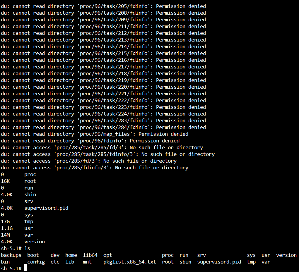

Hi dkerlee, running the command from within the container terminal, instead of the the the root one, gives a different output.
sh-5.1# du -ah | sort -n -r | head -n 10

Though the files are still showing the same size as my previous screenshot.

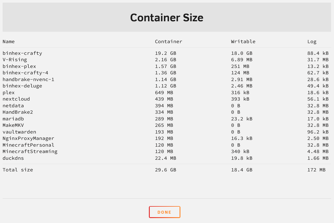

So I've still not been able to figure this out, my docker image is now up around 75%, I had to increase it 40GB.
Any ideas ? I don't know whether reinstalling the docker will mean that I have to setup my servers again, or will they remain as they're stored in appdata ?

Hi dkerlee,
I checked fix common problems and other than dockers and some plugins being out of date, there were no other issues. No capitalisation errors.

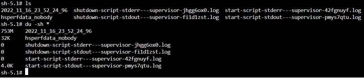

When going to docker > crafty > console and run du -sh * it looks like it gives me the contents of my root folder, as doing du -sh * shows boot, mnt user etc, and doing ls gives me this:

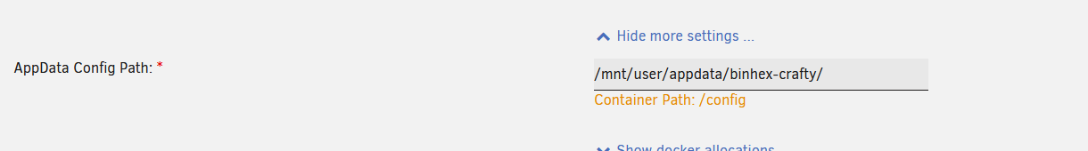

My worlds appear to be saved to appdata correctly as I can go in and view them in the directory that they're expected to be in.

you see /tmp how it’s 17G?
I think that’s your culprit.
the 17G + normal install size would be about the 19G you reported above.
Edited by dkerlee
Hi, think I've just fixed it !
it looks like it was my /config mapping... there was an extra / at the end of the mapping:
But removing that end / and changing it to /mnt/user/appdata/binhex/crafty has reduced my docker image utilsation to 26%of 40G (increased it to give me a bit more time to figure things out) and gives the above sizes when I go docker > container size.
Defo missed it previously, but the link you posted on expanding docker image size prompted me to go over mappings again and noticed that.
Will keep an eye on things but I think that should put this to bed now.
Thanks, - Myles
Wow, one misplaced slash and it fubar’ed that bad?! Good grief.
On another note: nicely done! That had been an issue for you for weeks huh. We (the community) are slow sometimes 🤷‍♀️
Yeah, it looks like it !
From my veeeery basic understanding, having it as /mnt/user/appdata/binhex-crafty writes everything all the sub folders etc into that directory but having it as /mnt/user/appdata/binhex-crafty/ expects a folder after that last / but because it was left 'blank' it wrote to /tmp as the docker was, surprise surprise, writing to a directory that didn't exist, in this case binhex-crafty/
I probably explained that veeeeery poorly, but I understand what I mean and can avoid it happening again :')
Thank you so much for your help!!
- Myles
@dkerlee interestingly enough, it appears that the /tmp folder is starting to fill up again:
But not at as quick a pace I don' think, I'm not sure what the 2022_11_16_23_52_24_96 file is, hoping it's just to do with backups maybe or something, will keep an eye on it though.
Thanks, - Myles
