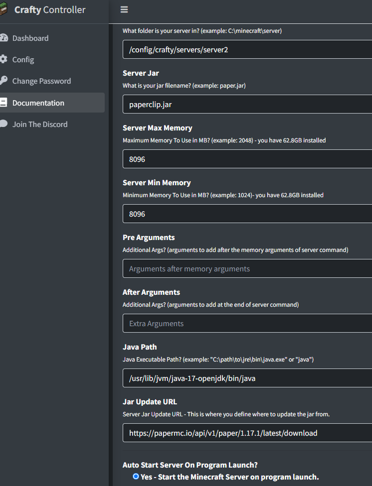

Got it. I assumed that the older minecraft versions would work on the latest version of java, that does not seem to be the case. All of my servers were working on the default java version before I updated the docker container.
I was unaware multiple versions of java were installed in the container as well. I set the java path of my 1.16.5 server to /usr/lib/jvm/java-8-openjdk/jre/bin/java and it loaded up properly!
My 1.17.1 and 1.16.5 were all using
/usr/lib/jvm/java-16-openjdk/bin/java
but now none of them will start (logs show that doesn't exist anymore).
I've changed the path to /usr/lib/jvm/java-17-openjdk/bin/java, but i'm getting java not found errors.
What's the path for the new java 17?
crafty.log shows:
2021-11-22 20:59:27,503 - [Crafty] - CRITICAL - app.classes.minecraft_server - Minecraft server Java path does not exist...
Edited by jj_uk

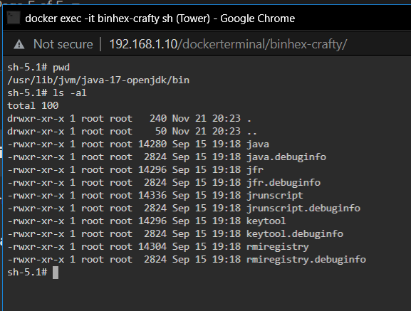

that is the correct path, just created container from latest:-
looks good to me.
I had to restart the container after changing the MC server java paths in crafty. My 1.16.5 is now running on java 8, and my fabric 1.17.1 server is running on java 17.
but my PaperMC server won't start on java 17, although their discord says it should, so i need to update PaperMC or one of the plugins etc that its using.
