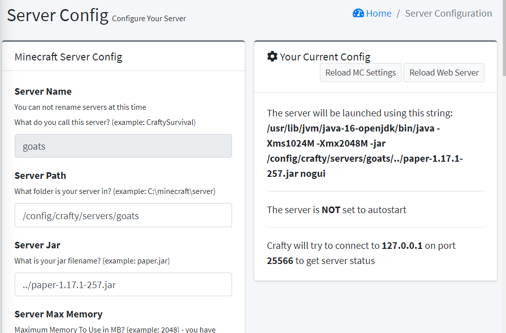

I'm trying (again) to get this puppy going. I'm having issues with file paths. I have several servers that are running inside Crafty Controller Docker.
This world I want to get going is called "goats" and is a 1.17 world
Server name: goats
Server Path: /config/crafty/servers/goats
Server Jar: ../paper-1.17.1-257.jar
Java Path: /usr/lib/jvm/java-16-openjdk/bin/java
I want the world files to be in
/config/crafty/servers/goats/region/XXXXXXX.mca
But this one creates /config/crafty/servers/goats/goats/region/XX.mca's
Also: the server.properties, I'd like that to be in a subfolder, /config/crafty/servers/goats, rather than /config/crafty/servers

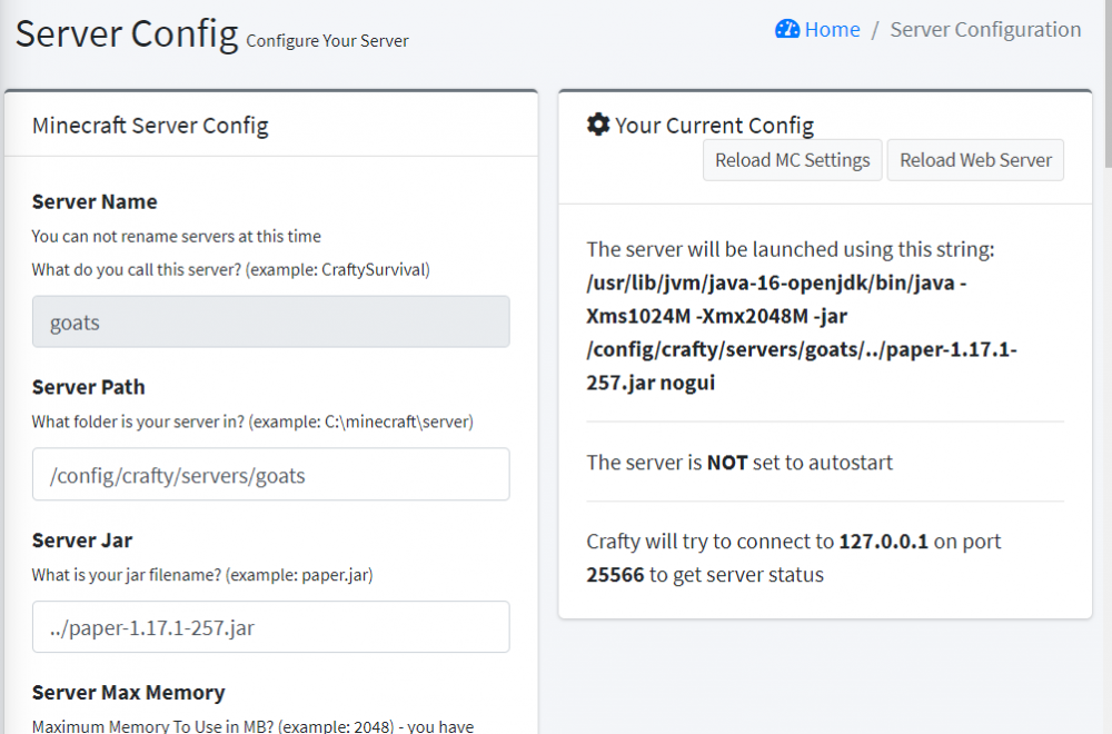

One other odd problem I'm having: when I go to the Server Config, on the right block, it says "The server will be launched using this string:
/usr/lib/jvm/java-16-openjdk/bin/java -Xms1024M -Xmx2048M -jar /config/crafty/servers/goats/../paper-1.17.1-257.jar nogui"
When I hit Run, on the previous page, it doesn't do anything, just hangs there. But when I run the Terminal from the Docker, I can paste in the long command, and it works great.
I think this has to do with my lack of understanding the paths here.

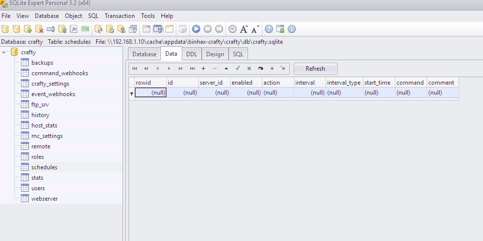

So it seems after I finally got everything set up and went to create a schedule for backups, it borked the server. I have a feeling the answer is going to be delete the DB and start over, but wanted to confirm if there was another way. This is from the container logs:
2021-09-18 16:41:50,537 DEBG 'start-script' stderr output:
File "/opt/crafty/crafty.py", line 308, in <module>
2021-09-18 16:41:50,538 DEBG 'start-script' stderr output:
multi.reload_scheduling()
File "/opt/crafty/app/classes/multiserv.py", line 93, in reload_scheduling
self.reload_user_schedules()
File "/opt/crafty/app/classes/multiserv.py", line 112, in reload_user_schedules
helper.scheduler(task, svr_obj)
File "/opt/crafty/app/classes/helpers.py", line 1306, in scheduler
schedule.every(task.interval).monday.do(mc_server_obj.backup_server).tag('user')
File "/opt/crafty/env/lib/python3.9/site-packages/schedule/__init__.py", line 302, in monday
raise IntervalError('Use mondays instead of monday')
schedule.IntervalError: Use mondays instead of monday
2021-09-18 16:41:50,584 DEBG fd 11 closed, stopped monitoring <POutputDispatcher at 22962550325200 for <Subprocess at 22962550324528 with name start-script in state RUNNING> (stdout)>
2021-09-18 16:41:50,584 DEBG fd 15 closed, stopped monitoring <POutputDispatcher at 22962550007648 for <Subprocess at 22962550324528 with name start-script in state RUNNING> (stderr)>
2021-09-18 16:41:50,584 INFO exited: start-script (exit status 1; not expected)
2021-09-18 16:41:50,585 DEBG received SIGCHLD indicating a child quit
Thanks for looking.
Yup, the path you are specifying in the Server Jar field is not correct, you should just type the name of your jar file, that's it
The config on the side should look something like this

19 minutes ago, muslimsteel said:
Thanks did that, the error seems a bit different but is still persisting where it won't start up, I am thinking that I may just blow away the DB and start over:
your issue is not a bug in the release its due to you misconfiguring crafty, which sadly you cant easily correct. the setting you need to fix is in the sqlite database.
you could try this:-
1.stop container
2. install SQLite Expert Personal
3. point it at the crafty database file
4. click on 'schedules' then click on menu item 'Object/'Empty Table schedules'
5. click on file/close database shuld prompt you to save changes, say yes
6. start crafty and cross fingers!.
screenshot for ref on my system, note my table is empty (no schedules defined)
1.stop container
screenshot for ref on my system:-
You rock, thank you that worked like a charm!
a pleasure :-), i would keep SQLite Expert Personal installed if i were you, its super handy as most apps store data in sqlite (plex, sonarr, radarr, etc)
