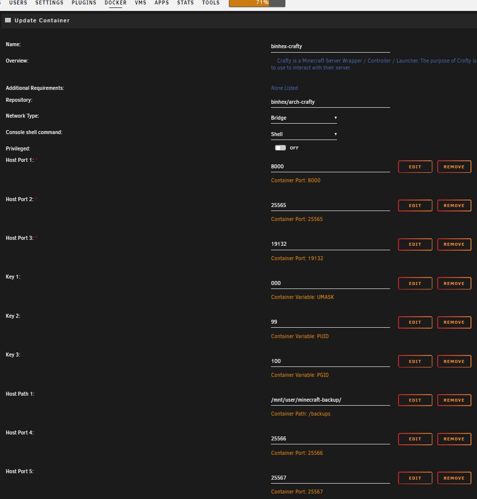

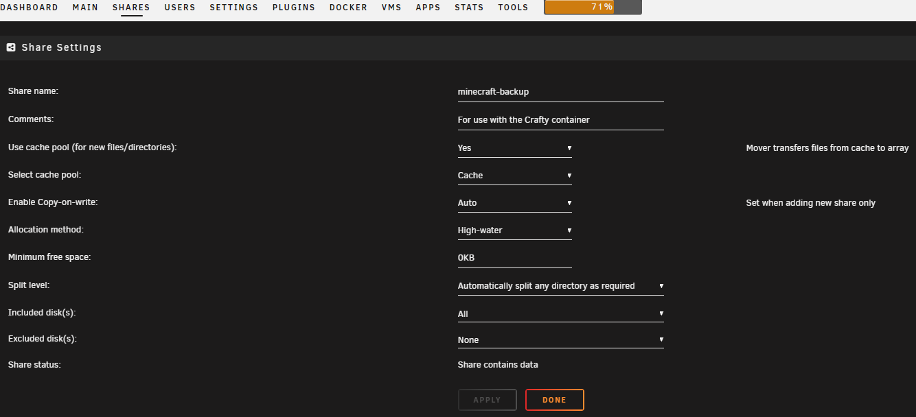

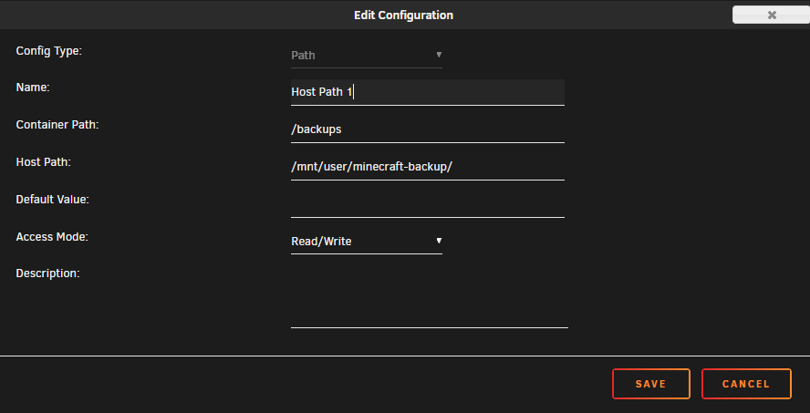

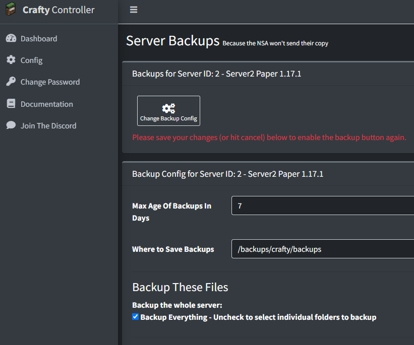

Be careful here. Depending on your unraid setup, the backups could be being saved to the cache (ssd?) drive, and backups are huge.
It's probably a good idea to create a new share on unraid ('use cache = yes') and map that share into the docker container, then save the backups there instead.
Unraid share:
Container setup:
Crafty config:
The resulting file system. Crafty auto-creates a folder for each server. I have 3 servers:
