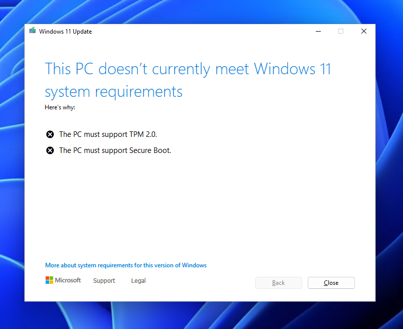

October 26, 20215 yr Has anybody figured out a good way to get their VM to upgrade to the newest insider build and get around the new requirements it put in place like requiring TPM 2.0 and Secure Boot?
October 27, 20215 yr There's an entire thread related to this already. Or, wait for 6.10-rc2+ to be released
