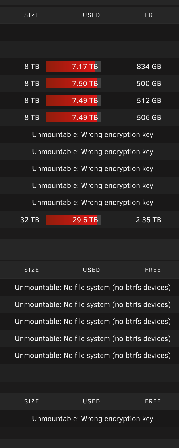

I've been banging my head against a wall for the last two days with this and I'm finally out of ideas... If anyone can figure out what's happening here, I'm all ears.
Last week I decided to do a few upgrades to my server. New motherboard (ASRock X570 Taichi) with a third full 16X slot, and an Adaptec 71605 to go in it as I expand my array from 8 drives to 11 courtesy of a few spares I had lying around, with a plan to eventually get up to 16 drives. At the same time, I'd move the 2x2TB m.2 SSD pool used for my Windows VM over to become part of the main cache pool, and replace them with 2x2TB m.2 nvme drives. All dockers/VMs/scripts/etc disabled until everything's done, ofc, and I'd wait to start changing drives around until after I'd checked everything from the old setup was still working. So just to be clear:
Old setup: 8 HDDs via an LSI card, cache made up of 3 SATA SSDs, Windows VM pool of 2 m.2 SATA SSDs
New setup: 11 HDDs, cache of 5 SSDs (mix of SATA and m.2), Windows VM pool of 2 m.2 nvme drives
CPU, RAM, PSU, etc, are all kept from the previous rig.
Everything looked good after making the hardware switchovers (even though only UEFI boot seems to work with this new mobo), so I started the process of moving my Cache and Windows pool drives around. Started by removing one of the two Windows disks and starting a new BTRFS balance. Unfortunately it got to 71% and the server started to freeze up, eventually necessitating a hard reset.
Ever since, I've been unable to start the array normally. It works fine in safe mode - entering the disk encryption password on the main tab, hitting "Start", the array + two pools start up. But if I try after a normal boot, maintenance mode or otherwise, most of the drives - usually disks 6-11 of the array (but sometimes 7-11, or 5-11), plus all the disks in both pools - refuse to mount because of an "incorrect encryption key". Now, I know for a fact the password is fine (I wouldn't be able to start the array in safe mode, after all), but I cannot figure out what on earth is happening. It seems like the system decrypts each disk one by one, but then after a few disks something is happening to make it think the encryption key is suddenly incorrect for all subsequent disks.
1688721592_ScreenShot2021-09-27at22_49_45.thumb.png.6882a3c2ec407ce5b0e3d88af82d10ee.png
At first I thought it was due to something screwy around the the pool disks that I was switching around - even in safe mode the same encryption key error was happening when I tried to include either of them in the cache pool, so I bit the bullet and formatted them clean, accepting I'd be spending some time redownloading from my offsite backups to get back to normal. But even though that resolved the issue in safe mode, it still left the problem in place for a normal boot. Replugging individual drives/changing cables didn't do anything, nor reseating the Adaptec card, although that wasn't surprising considering the pool disks are connected directly to the mobo's SATA ports yet are also affected by this. (And, again, I can start the array fine in safe mode, so that means it must be something else like a plugin perhaps?)
I've attached my diagnostics, taken after a new boot and attempt to start the array. Any ideas much appreciated!!
