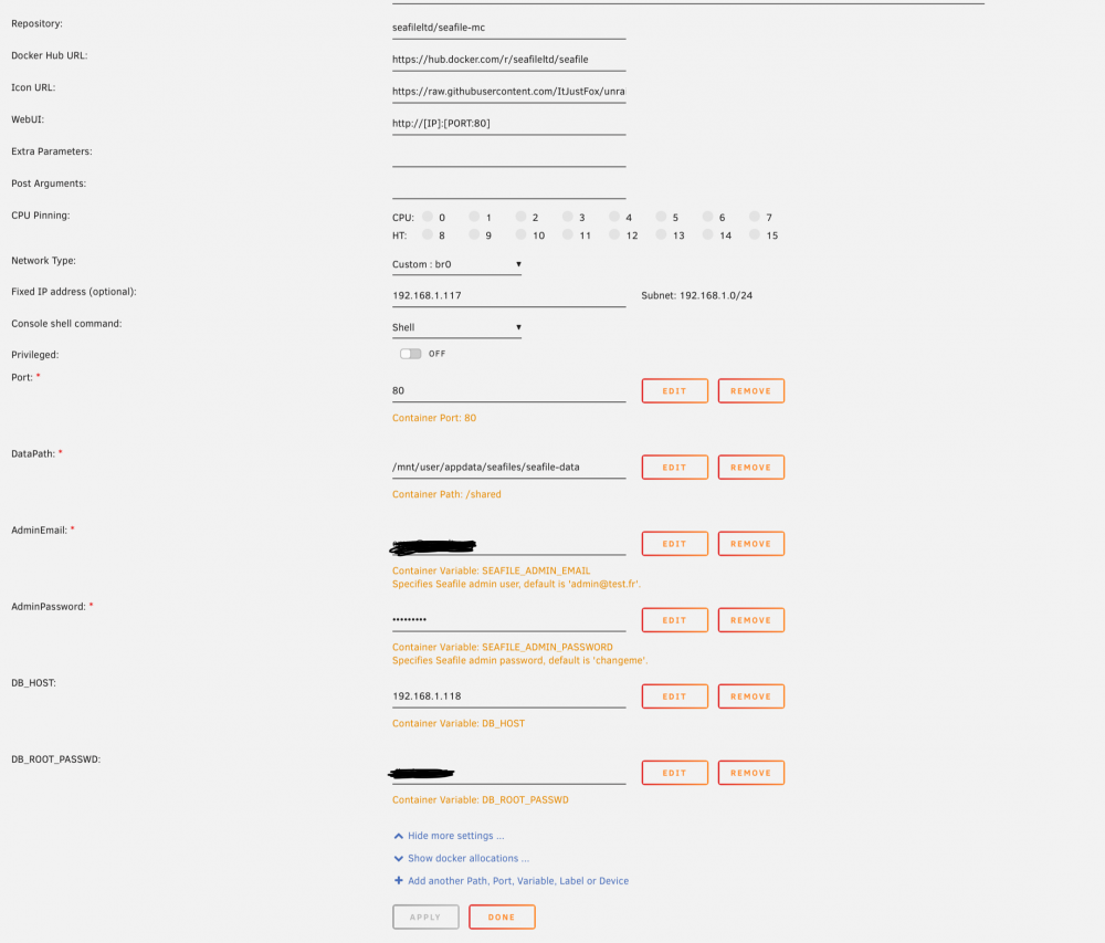

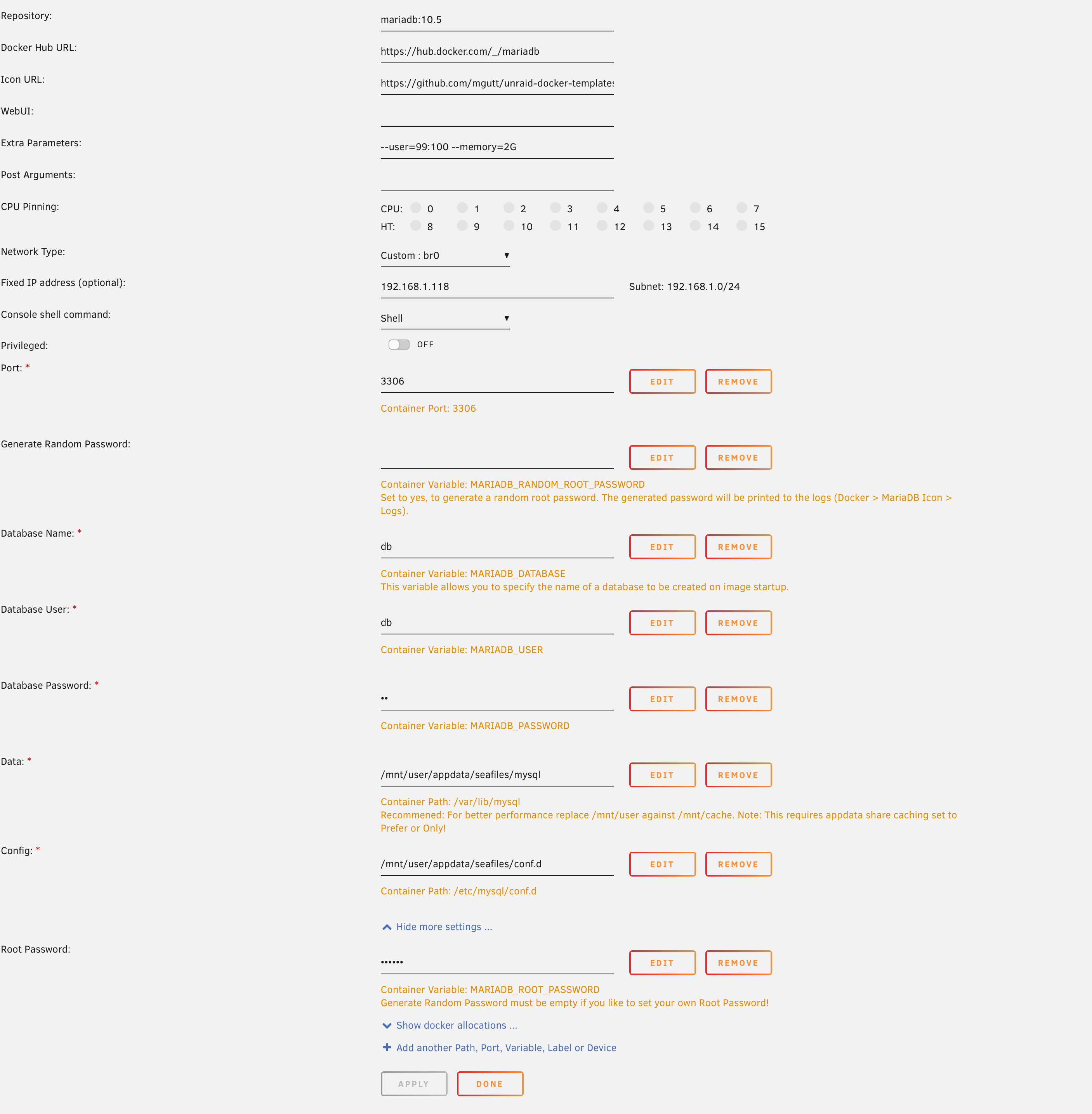

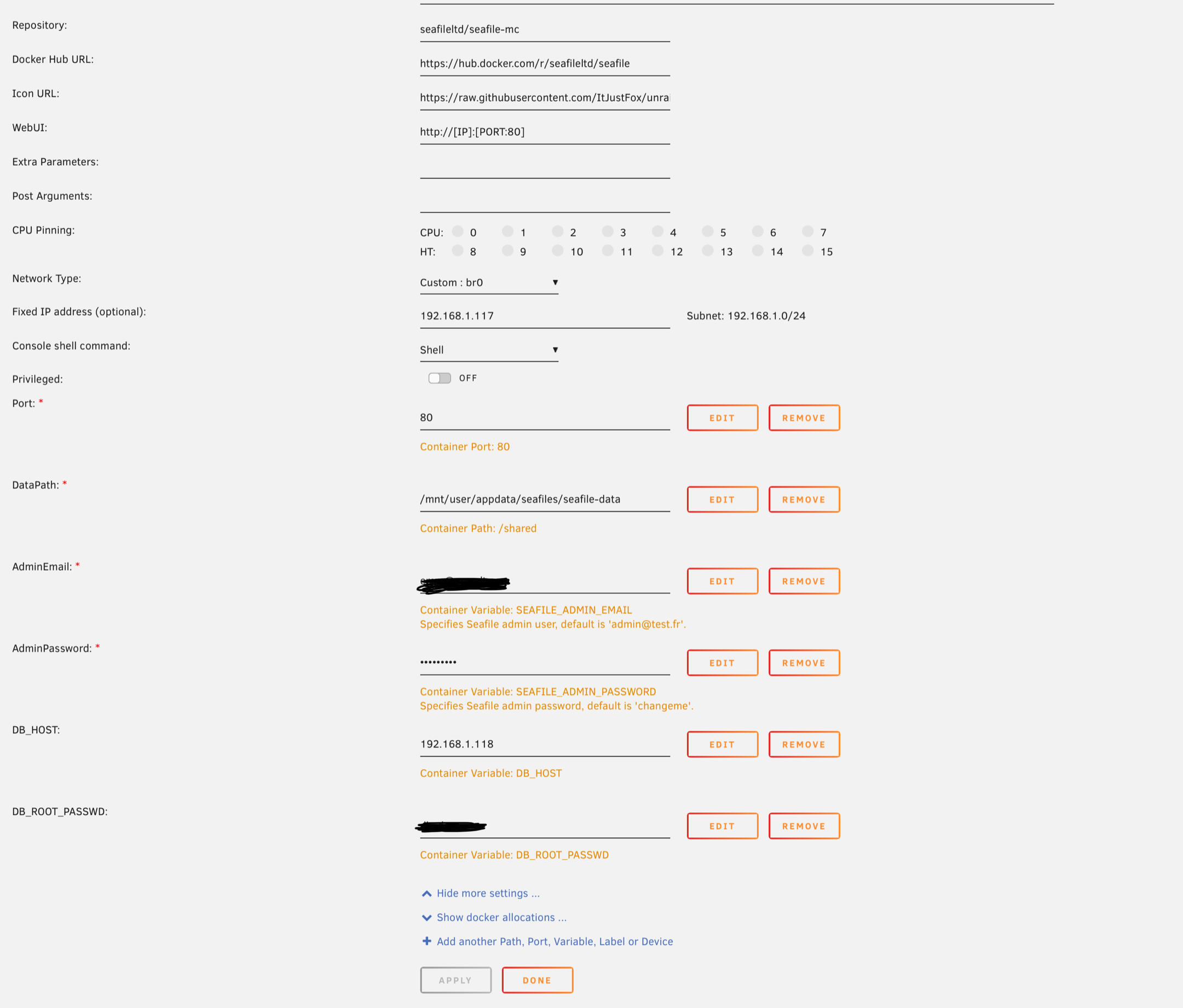

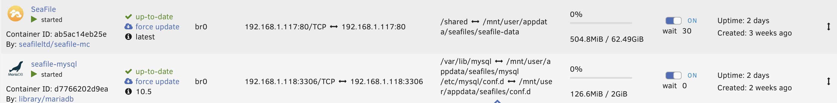

April 21, 20224 yr I have setup seafile-mc and mariadb:10.5 (only for seafile) separate docker. I attached screenshots. I hope it helps. Seafile docker; mariadb; summary;
September 14, 20224 yr On 4/20/2022 at 10:54 AM, Merron said: Hi i tried to use https://hub.docker.com/r/seafileltd/seafile-mc instead of https://hub.docker.com/r/seafileltd/seafile (outdated, 3 years old). with the seafile template delivered with the community plugin list. Installations and start works. Opening the seafile site = nginx bad gateway. The old version worked. Any advice? I know this thread is a bit stale, but for anyone else landing here after searching for the same issue, I also initially saw "bad gateway" on a fresh install. In my case, the problem was because I didn't notice that the necessary seafile-mc environment variable is "DB_ROOT_PASSWD", not "DB_ROOT_PASSWORD". (notice the missing "OR"!)

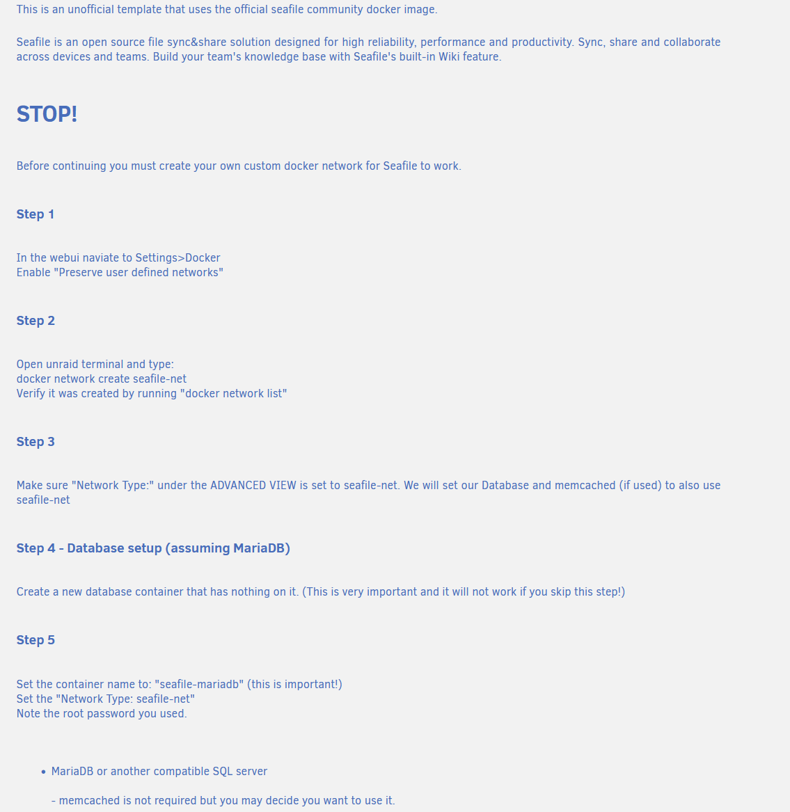

May 30, 20242 yr On 11/21/2022 at 11:51 AM, ppompili said: Hey all, using the instructions provided within the template of Seafile-Official from the Unraid App store worked for me. @emrepolat7 was also very helpful! Thank you, Which instructions? I only see some instructions in the seafile-mc template but they conflict with the technique that @emrepolat7 shows in his screenshots I can't seem to figure it out. I get lost at Step 4, "a new database container that has nothing on it", what does that mean? Trying to follow @emrepolat7's screenshots I get the "502 Bad Gateway" error. Edited May 30, 20242 yr by Matt Elias
May 30, 20242 yr Okay, I tried again after removing prev containers and deleting all mariadb & seafile directories from my appdata. This time I created the mariadb container first, then seafile and now it's working after following these instructions as closely as possible.

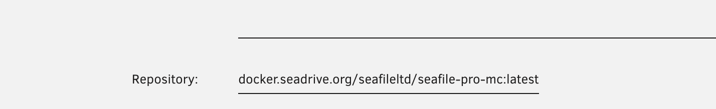

June 1, 20242 yr On 5/31/2024 at 2:29 AM, Matt Elias said: Now, does anyone know how to upgrade to PRO edition? you have to register and use their repository
June 22, 20242 yr On 6/1/2024 at 9:14 AM, emrepolat7 said: you have to register and use their repository Care to elaborate? How do I register?
June 24, 20242 yr On 6/22/2024 at 6:41 PM, Matt Elias said: Care to elaborate? How do I register? https://www.seafile.com/en/product/private_server/

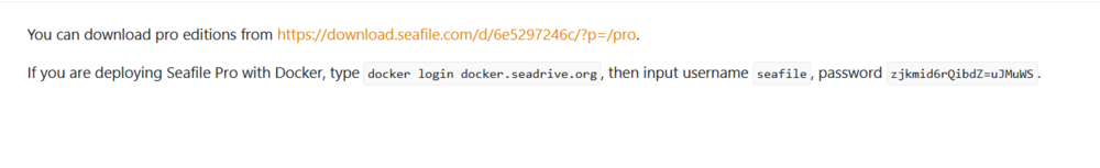

June 26, 20242 yr I have registered with Seafile previously, but how to login with docker so that it can pull from their Pro repo? I can't find how to do that with the unRaid GUI. Is it cli only? Edited June 26, 20242 yr by Matt Elias
December 4, 20241 yr Create account at https://customer.seafile.com In unRAID terminal: docker login docker.seadrive.org Use your provided username and password you received earlier. Hope this helps.
December 4, 20241 yr On 5/30/2024 at 7:17 AM, Matt Elias said: Which instructions? I only see some instructions in the seafile-mc template but they conflict with the technique that @emrepolat7 shows in his screenshots I can't seem to figure it out. I get lost at Step 4, "a new database container that has nothing on it", what does that mean? Trying to follow @emrepolat7's screenshots I get the "502 Bad Gateway" error. For step 4, what I was trying to say was to not create any tables, database users, etc. since Seafile has the root login it sets up the database for you.
