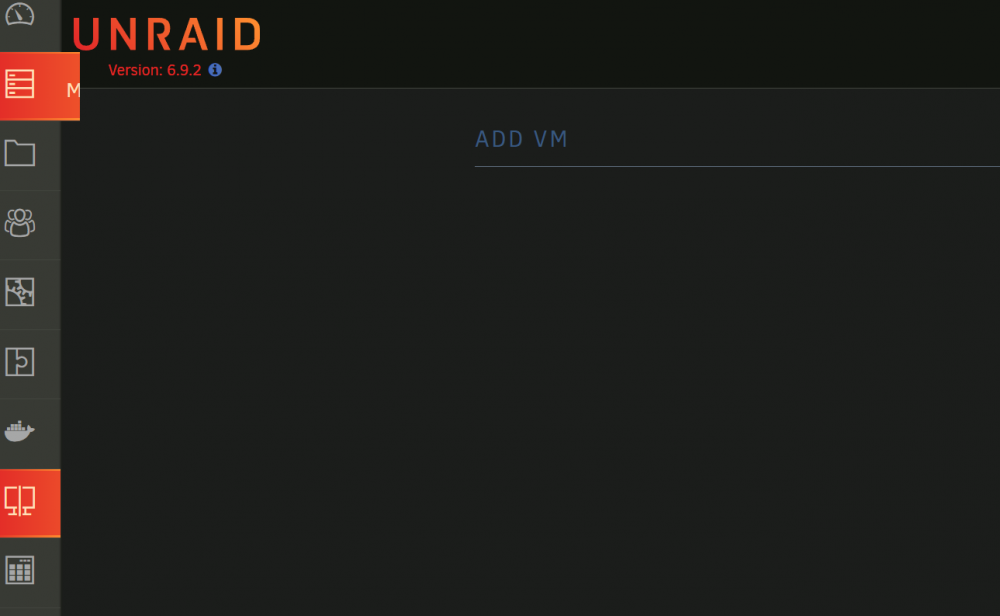

Is that how your VM page actually looks? With cutoff text on "Main" (and still highlighted) while you're on the VM tab?  Try it in safe mode from the boot menu
Ni @Squid
sorry for created confusion
So the cut Menu is because of print-screen delay I think I may moved mouse up to Main when the screen shot app kicked.
My VM tab is working (meaning I can create new VM) but I can not start any of my VMs (old or new ones)
