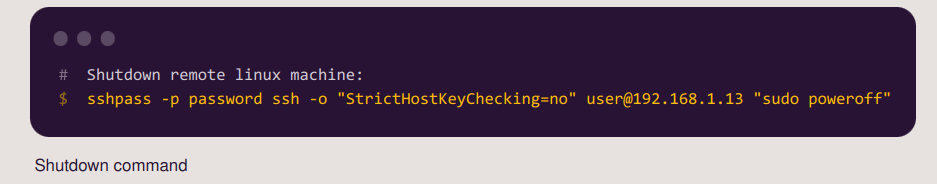

Hi, if I setup upsnap (on raspberrypi) for my unraid server (PC on the same LAN) command Like this is OK:
```sshpass -p xjwxnwkdneeeee ssh -o "StrictHostKeyChecking=no" [email protected] "powerdown"```?
