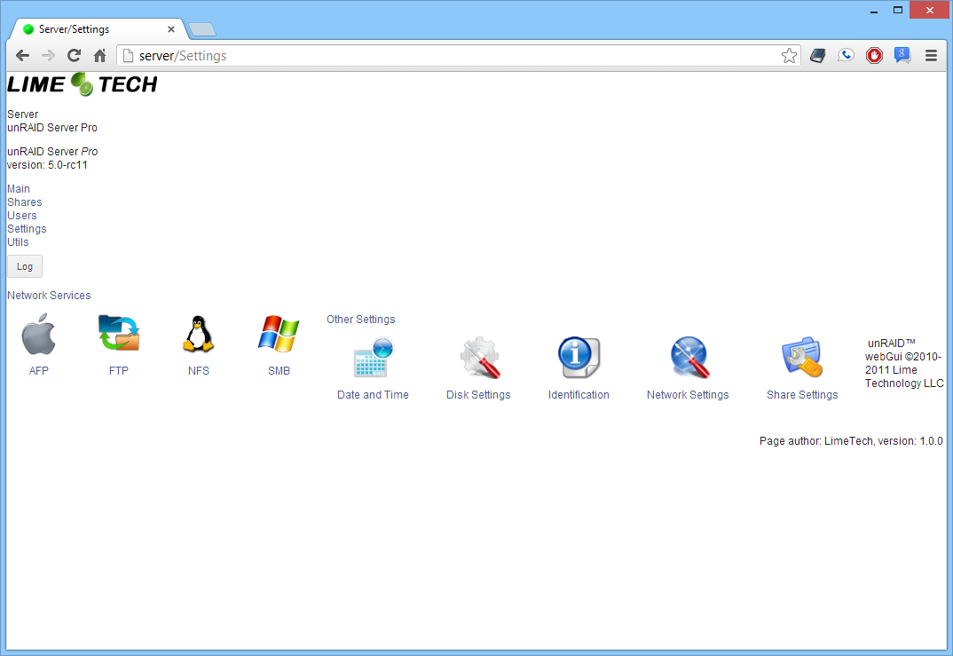

Hello everyone, I did this and the regular unRAID web GUI is sorta messed up, anyone know how to fix (without losing all my normal unRAID settings?)
Picture attached of the Settings menu, but now there's no headers, no page formatting, etc is on all pages. Thanks

May be by clearing your browser's cache / deleting history files?
I feel stupid, thank you.
