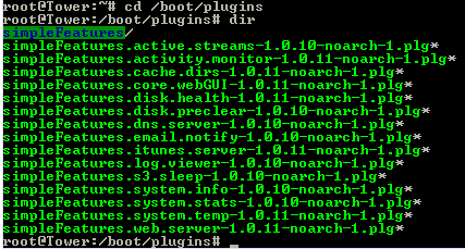

Can you post a screenshot or folder listing of where you have put the SimpleFeatures *.plg files?

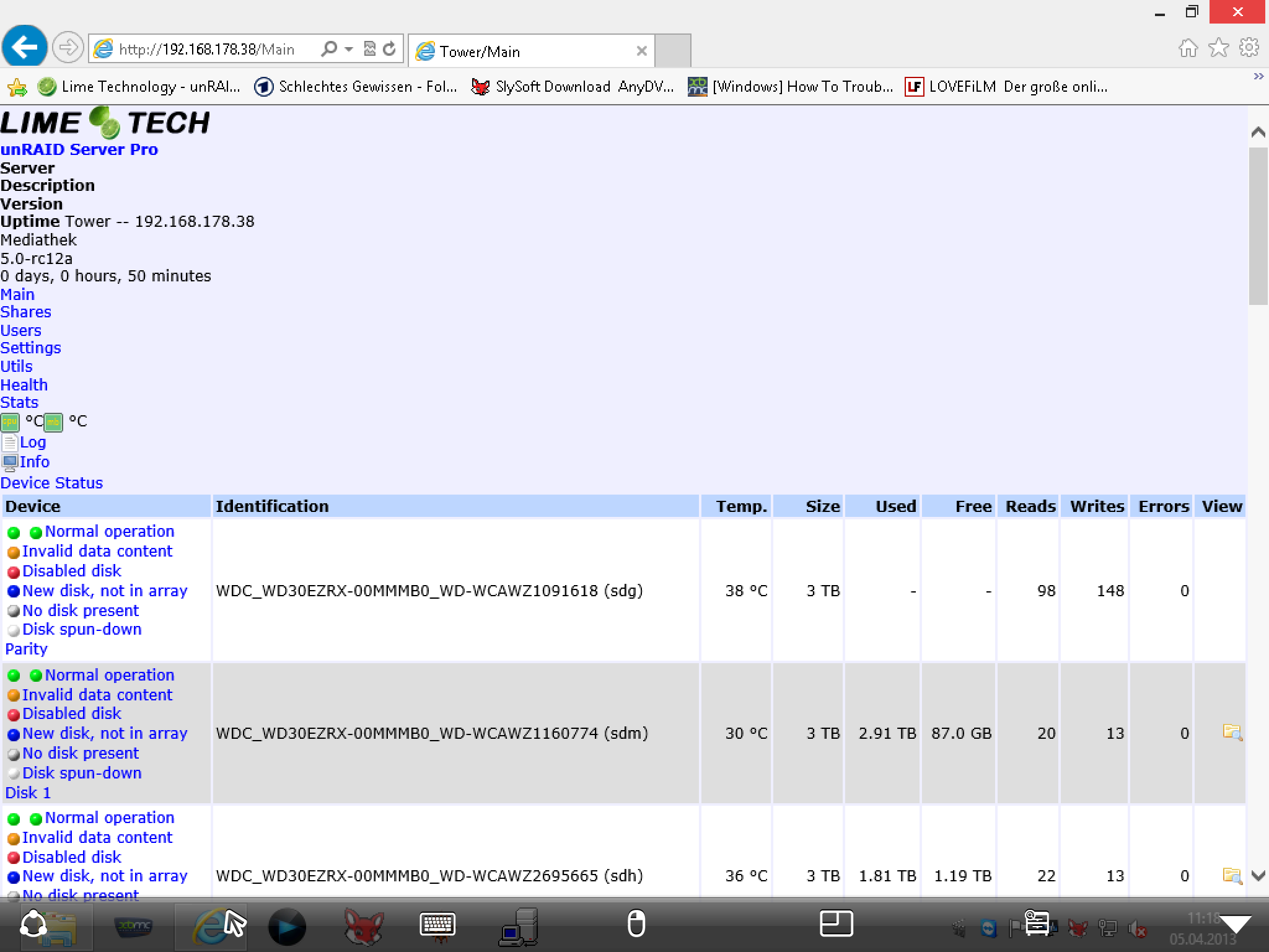

@Frank1940
i copied everything to the share "\\tower\flash". What "core" installation do i need, how do i install it? Maybe that should be stated more clearly in the installation post for unexperienced users like me.
@trurl
See screenshot. The location seems to be correct.
@Frank1940
@trurl
the best way to check that everything installs fine is using installplg to install via the shell.
telnet to your machine, then:
installplg /boot/plugins/simpleFeatures.core.webGUI-1.0.11-noarch-1.plg
check there are no errors.
afterwards, do the same for each and every plugin you like to use.
you should note that all of the plugins in the directory will get installed upon reboot, so delete the ones your don't want to get installed.
